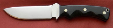

Hi Guys
This is my first attempt at a tactical type knife, and I can use all the critique you have. Thanks
Blade is 5/32 thick 440C, Full Tang
Bolsters are 440C with nickel silver pins
Handle is Black G10 with nickel silver Corby rivets and stainless tube for tie
Blade length 4 1/2 inches with false edge on top and OAL is 9 inches
Knife comes with handmade leather sheath
$250 free shipping US and Canada

Sorry, I forgot to add the price. I get $250 for all my standard knives. They all come with the handmade leather sheath.
I'd drop the last corby rivet next time, it's too crowded with the lanyard tube. Otherwise, your F+F seems good, and it's a fine design.
Thanks, I'll do that. I have one I am making now. A little different in the blade shape, but much the same in the handle
