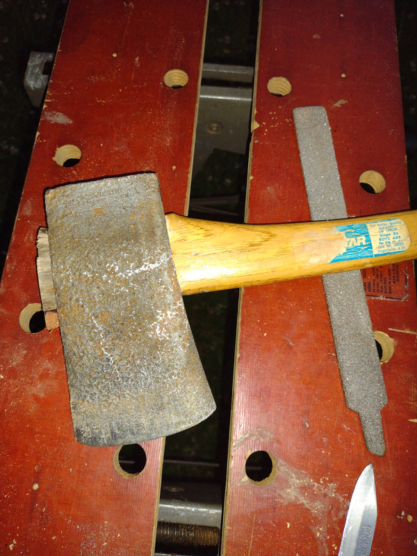

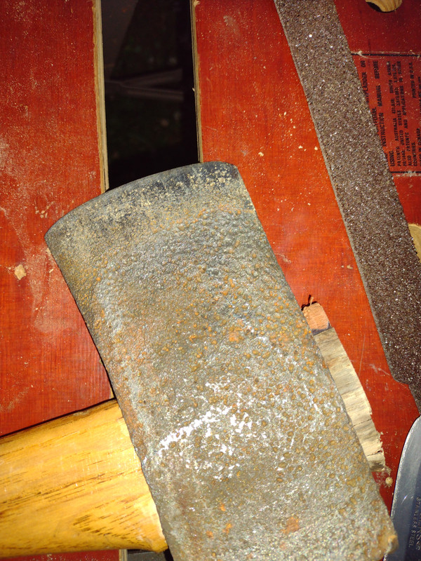

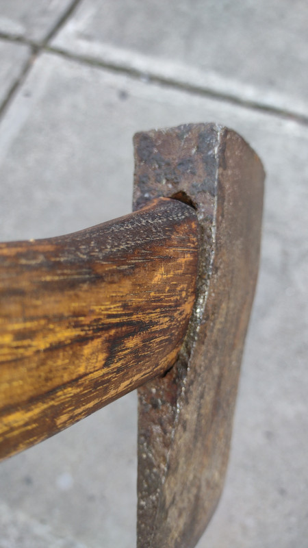

The ruler is covering the widest point of the handle's shoulder. There is 2" or less of tongue material/width for the eye of the axe. Thanks very much for the attempts to help. Let me know if another picture would be more helpful.

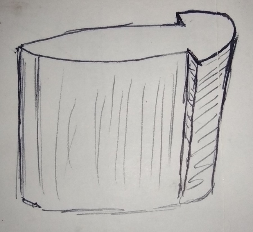

No sleight of hand needed here, it should be pretty straightforward to glue a piece of material to the front of the eye. I've done this a few times in the past in a similar effort to save a nice haft.
I use a hand plane first to establish flat surfaces on the handle and a scrap of hickory, then glue up and clamp. Takes just a few minutes and if you prep the parts well for jointing makes for a very strong bond.

Heads might sit differently depending if it is straght handle or curved. Can you post the pic of whole handle

Just try using hand made very thick wedge for starters. might end up with T-shaped wedge
Gluing some wood to make whole thing thicker is other option

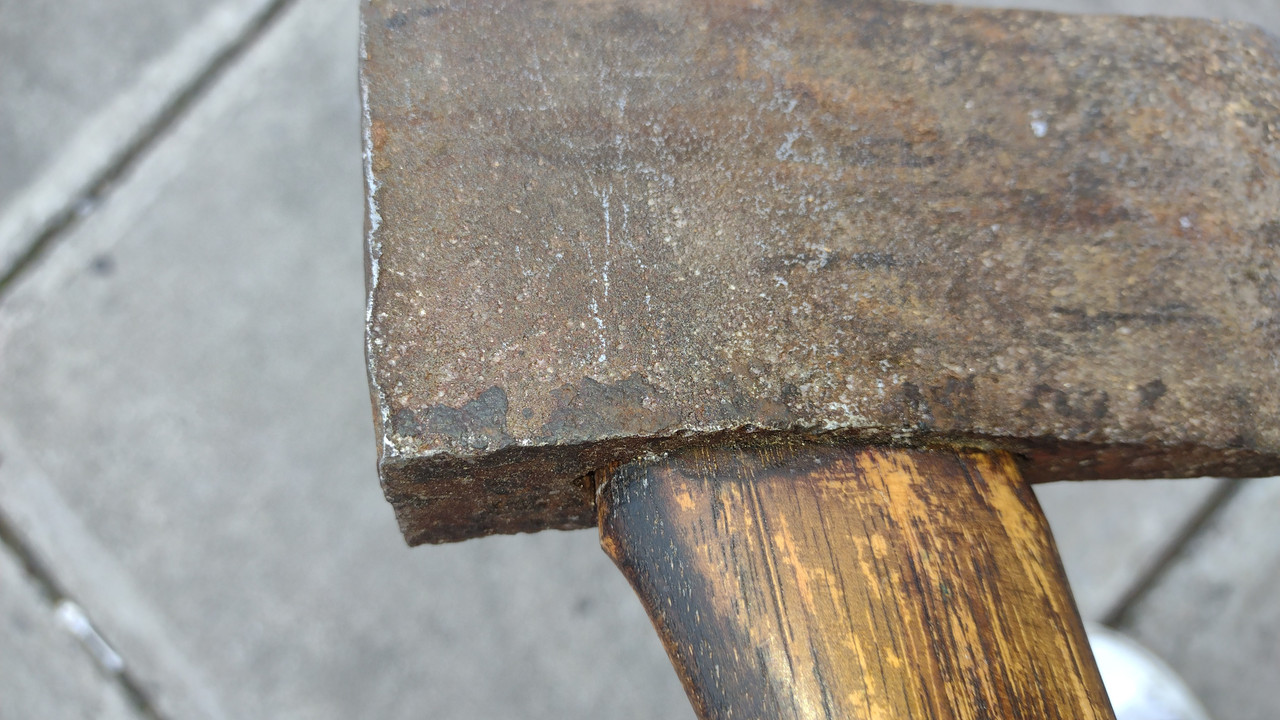

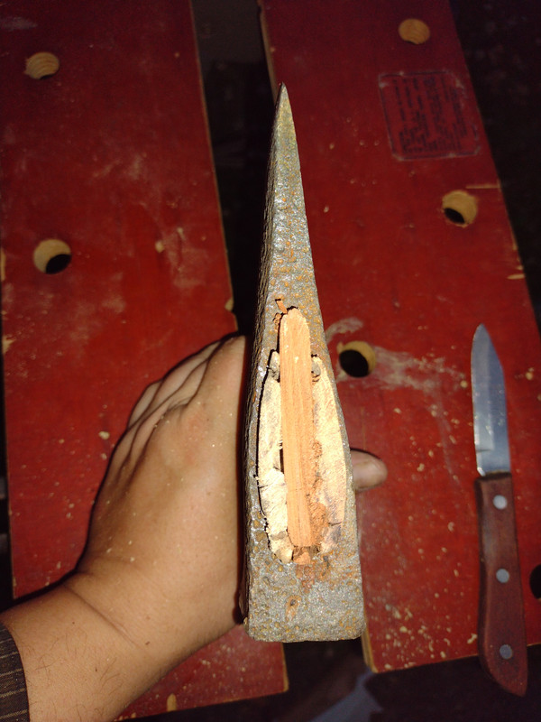

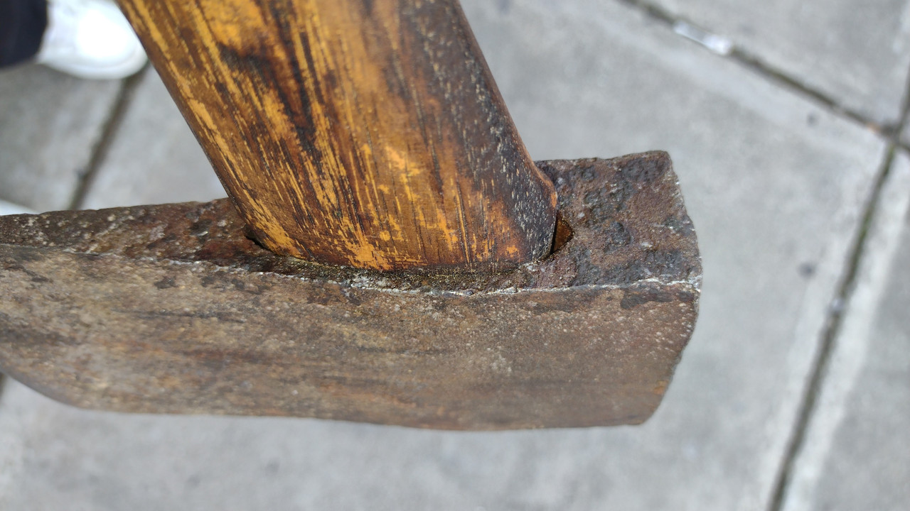

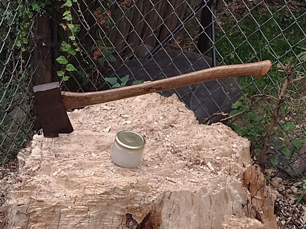

Maybe it will give you some perspective. I was lucky to grab Inlaid Wedge Legitimus from fleybay. It is full size head with full size eye. I needed to try how full size head on 27 inch haft would chop and swing. My buddy gave me boy's handle that he mangled when drilling out permabond. It was just temporary hang before I would find 32 inch handle that deserved that head. As you can see it was not correct hang (gaps by the shoulder and left the tongue proud for easier prospective removal). It was sitting on the shoulder, overized wedge filled the gaps and kept everything tight. It did a lot of underhand chopping and it hasn't loosen a bit.
Try to find Boy's head and play with it, Nothing to loose.
The wedge goes all the way from the front of the eye to the poll I just smashed proud chunk of it by the poll
Maybe it will give you some perspective. I was lucky to grab Inlaid Wedge Legitimus from fleybay. It is full size head with full size eye. I needed to try how full size head on 27 inch haft would chop and swing. My buddy gave me boy's handle that he mangled when drilling out permabond. It was just temporary hang before I would find 32 inch handle that deserved that head. As you can see it was not correct hang (gaps by the shoulder and left the tongue proud for easier prospective removal), but it was sitting on the shoulder and overized wedge filled the gaps and kept everything tight. It did a lot of underhand chopping and it hasn't loosen a bit.
Wow. THAT is really freaking helpful. Strange how much a picture helps. I felt like I understood the idea and didn't like it. But this could actually turn out very nice, especially if I pick a really nice wedge. I'm having trouble understanding the gap at the bottom, though. My mind is drawing a picture that says it would have been flush before you drove in the wedge. But I'm also guessing that this may be hard to understand without handling that head on that handle myself...
