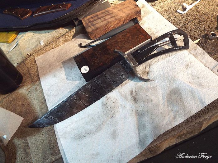

This assembly is for the ease of precise construction.
It is for FREEDOM of the maker.
It is for the long life of the knife.

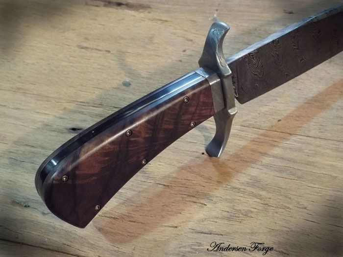

I wonder how the scales are held on. I understand the clever construction of the blade/frame but I did not see how the scales will be held on. Screws? Did I miss a photo? The second knife has to be made like a hidden tang, right? Thanks, Larry

This is just the working condition of this knife at this time.
It's a long way from done. It's in this condition for the demo.
Lugs on the front ends of the frame continue on into the guard.
This knife is meant to forever allow the owner to take it apart, so I will eventually screw the scales on.
I will place threaded stainless steel inserts into the frame and do something like:
