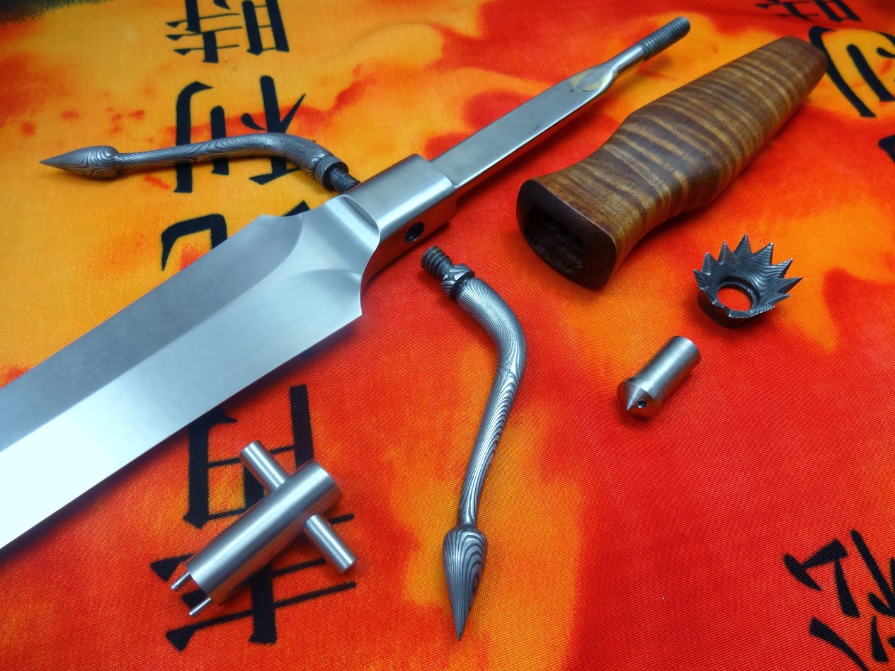

I have used corbys for buttcap bolts, works OK- if you have a lathe, you can turn something a bit fancier to suit. I start with stainless round stock, say 3/8" diameter, drill a #3 blind hole (over recommended size) with the tailstock, start the tapping with the tailstock and finish by hand. As Pat says, two taps. Then I turn the barrel of the nut down to pass through size for the butt cap, with a step- like a corby. The finial can be whatever shape you like after that.
Here's a few examples. the last one is a blind drilled and tapped hole directly in the butt cap.

Jim Siska finishes all his blades with a wide tang stub with a dovetail cut into it. He then makes a mild steel tang extension
with a matching male dovetail and brazes the parts together after heat treat. He does it this way because he roughs the
blades in advance and doesn't know what shape of tang he'll need until someone orders the knife.
All of these are assembled with a female tang nut and threaded tang. Some are takedown, some aren't but the basic
construction stays the same.
And Jim was taught by the same guy I was - Jerry Rados.
