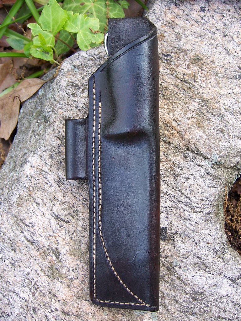

If you saw my post on my Fiddleback Hunter, you were probably wondering why the sheath got no mention. I wanted to do a separate review/post to showcase Talfuchre's excellent work. TF custom made this sheath for the Hunter. As requested, he included a firesteel loop for a 3/8" firesteel, a belt loop and a removable dangler set up. I wasn't sure how I'd like the dangler, but it is actually quite comfortable. Ultimately, I will probably use it almost exclusively. Enough babble though, on to the pics!
Just look at this wet form. You can literally see every contour of the handle even though the knife isn't in the photo.

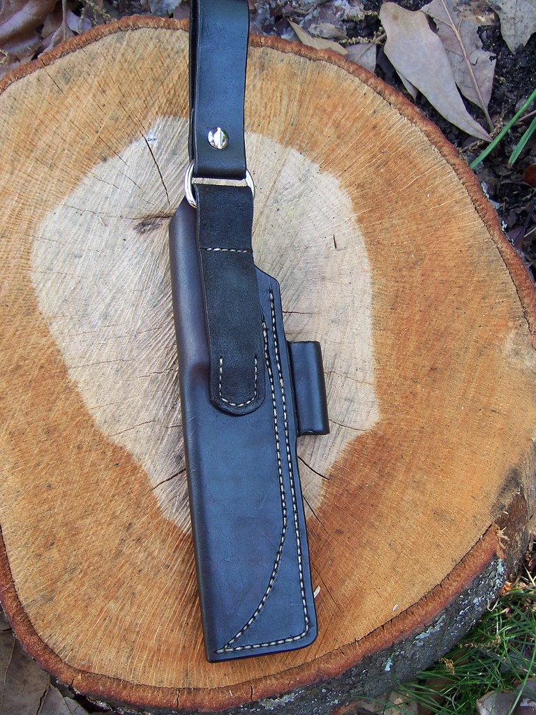

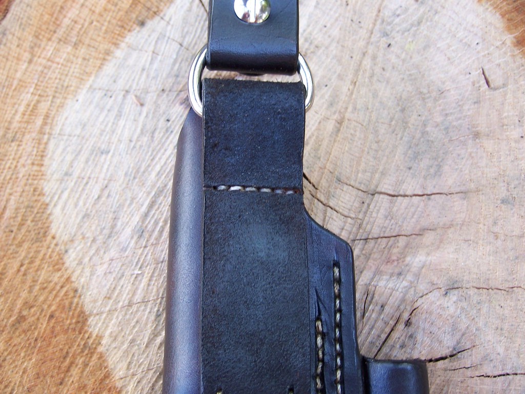

In another review, it was recommended that TF keep the stitching for the belt loop within the confines of the loop as shown here.
My one recommendation can sort of be seen in this photo. As stated previously, TF did an amazing job on the wet forming around the handle and it provides an extremely secure hold. The only negative (and possibly preference more than a true negative), is that it creates a contour around which the belt loop has to extend, making the loop kind of close fitting to the wet formed area.
This makes getting a belt through the loop somewhat difficult. I didn't try it with the knife in the sheath as I thought it would make it even harder. I would recommend slightly wet forming the belt loop to make passing a belt through a little easier. Again, this is probably just preference as others might prefer a snug fitting loop that doesn't allow the sheath to slide around, which makes sense.

What I could have done was to put a belt blank in the belt loop portion while wetforming it. That is a great suggestion.
It WILL stretch for you however - just stick a belt though there - and wear it for a day - the heat from your body will cause it to sweat.

Like I said, it is probably also preference. When I first tried to slide my belt in I thought "hmmm... this is kind of tight", but as I was typing the review I thought "hmmm... tight will keep it from sliding around on the belt". I have no doubt it will break in well though.
