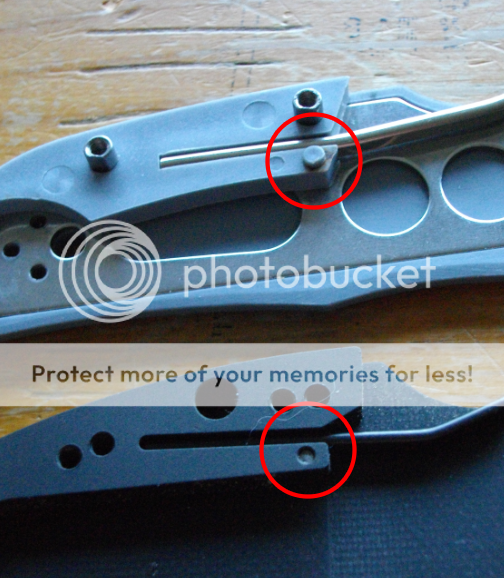

Here's the difference between Recon 1 and Endura lockup and internals....
Check out the difference between the lockups. The Endura looks positively frail compared to the Recon 1's Triad lock.
Noticeable blade play in the Endura would worry me a bit, while if the Recon 1 developed blade play I would still be confident my fingers were quite safe. I measured it, and there was about 1 mm of contact between the Endura's lock bar and blade, while the Recon 1 had about 5 mm with that huge stop pin as well...

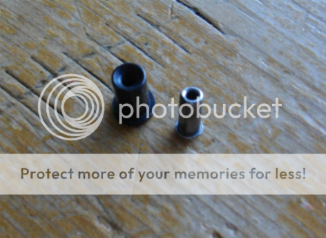

The Recon 1's pivot pin is much larger in diameter.
Also I noticed this difference in the part of the backspacers holding the spring in place, the Recon 1 has a metal pin, while the Endura relies on FRN protrusions. Interesting, although I assume either method is adequate here.
