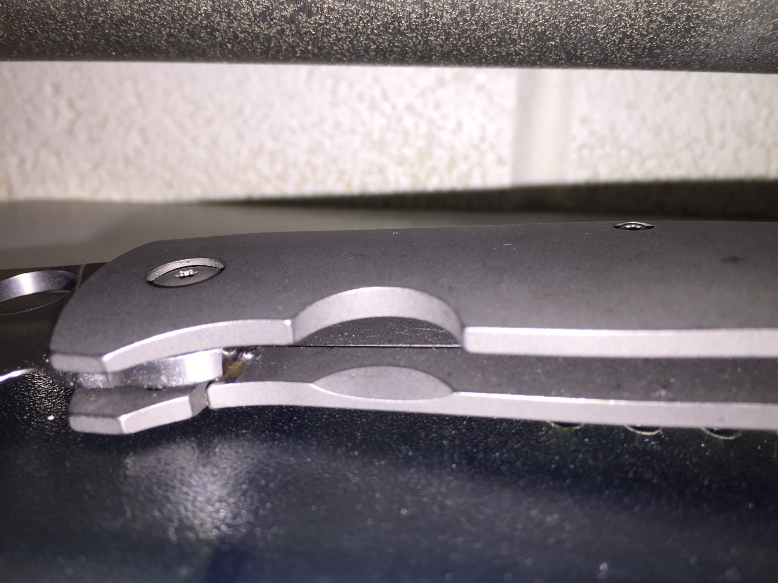

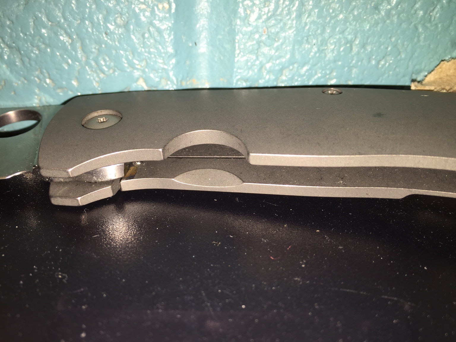

Secondly, I snapped some pictures of my lock bar (in the bathroom at work. Shhhhhhh). There is definitely some kind of treatment here, I just don't know what it is!
Also, I really want to note that the question about the lock treatment is strictly out of curiosity. I'm not concerned about the quality or longevity, nor am I trying to start any heated debates or anything. I just really want to understand the different methods for treating titanium locks and really want to know which was used in this case!
Here are the pics:
FWIW, the carbidizing (if it's there) would be on the end of the lock bar that contacts the blade's tang; not on the side with the detente ball...

You are seeing the lockbar slightly polished when the detent ball loses contact with the blade tang, right before it locks up. Mine looks the same.

I carry my Slysz Bowie almost every day. I flip it all the time and use it all the time. My lock up moved a tiny bit at first then settled at about 80%, basically the entire LOCKBAR is engaged to the tang. It has not changed for a long time. I have used it for hard cutting and can even try to push the lock bar in deeper with no change to lock up and absolutely no stick what so ever on disengagement. I see these as signs of a well made lock. I believe the Slysz collabs are indeed heat treated (carburized).
Not quite, CRK puts a layer of WC near the detent ball. Being that Sal and Chris are buddy's, I'd imagine Spyderco is following in CRK's footsteps.
