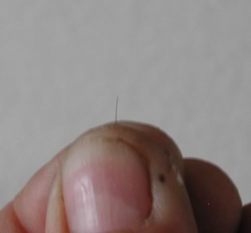

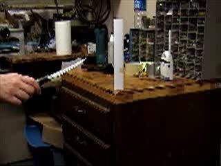

I don't have a DVD yet but here's some pics of a few cuts that I have been able to make without too much trouble,... just some hand stones and a cork/paper composite strop.
The standing hair.
Freestanding rolling paper tube with a "swipe" cut.
Five rolled tubes of phone book paper with a "swipe" cut.

Cool!

That's some nice cuts, Sir. The cigarette paper cut is neat.
