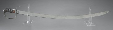

Recently i bought this old Indian Talwar sword, but it's not exactly my field of expertise.
If possible i would like to know the timeframe & region that the sword was made, and if the blade could possibly be wootz steel.
Thx in advance for any info you're willing to share, :)

I am well out of my depth as well but I remember discussions regarding plain, late tulwar during the end of the 19th century. Some made by Mole, in England resemble this one shown. A plain iron/steel hilt with a pommel having some pie-crusting like decoration at the end of the hilt. I would suspect definitely India and just before, or around 1900.
Cheers GC
Looks old. 18th century? At least, most of the ones similar to this that I've seen have been 18th century. Could be wootz - can't tell with the blade in that condition. The blade might be non-Indian in origin (Persian or Ottoman), but there are similar Indian-made blades.

Partial etching attempt with a bit of lemon juice, just to see if something would appear.
It seems it did, but so far it doesn't look like any of the wootz patterns i see online.
Click 2 x on the picture, then enlarge further.
It looks to have dendritic structure to me. As mentioned, not all crucible steel is truly regarded as wootz and forging out the cakes often pounds out/obfuscates a more distinctive watery pattern.
