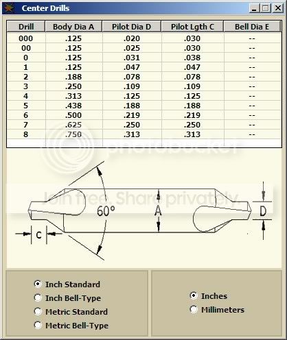

I was drilling and counter sinking a few tang holes the other day and got to thinking it would be nice if there was a bit like they use in wood working that had a drill with a counter sink built right in. Well, there is!! I had overlooked it even though I have a bunch laying around for use with my lathe.
Machinists already know this and some other knife makers may also know but I had overlooked it, as I'm sure others have as well. Center drills are perfect for drilling and countersinking tangs in one easy step. They are tough and seem to last longer than a regular bit as well.
As you can see:
a #4 center drill has a pilot diameter of 1/8" and a pilot length of 1/8"
a #5 center drill has a pilot diameter of 3/16" and a pilot length of 3/16" (.005" larger-close enough)
and a #7 center drill has a pilot diameter of 1/4" and a pilot length of 1/4" (for mosaic pins)
As long as your blade thickness is the same size or smaller than the pilot diameter, center drills will work great and as a bonus there is no flex in the bit. Just run the center drill into the steel so the pilot penetrates and the body of it starts to make a slight counter sink, then flip the blade over and countersink the otherside. No seperate countersink bit required :)
I figured I'd post this in case others have overlooked it.

I'm not sure Dave but I doubt it, maybe a machinist can verify this. The purpose of a center drill is to fit the taper on a live or dead center when chucking a workpiece in a lathe and I can't really see a need for a number size pilot to do that.
I suppose you could always use the center drill and go slightly deeper with the body portion to make a deeper countersink, then follow it up with a chucking reamer or a number drill, but then you are into doing 2 operations again anyway.

It will work for tubing thong holes, but maybe not for countersink screws.
That angle on centre drill is 60 degrees
Flat head-countersink head screws are 82 degrees
I use 3/16" stainless pins and sometimes 1/4" mosic pins in all my knives so these work great for drilling the tangs prior to heat treating. I hadn't even considered screws Steven, thanks for pointing that out. Thanks Gixxer for pointing out the 82* center drills for the guys that want to use screws.
