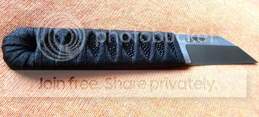

On my knives, I drill a 1/4th hole in the tang at the butt, trace the handle and the hole placement on the fleshy part of the stingray, cut the stingray with a stout pair of scissors, punch the hole out with a leather hole punch, glue the stingray scales down onto the handle (leaving a bit of room for the ricasso) and trim any excess stingray hanging over the edges with a pair of straight toenail clippers (Hey, it works! lol) I then lightly bevel the edges of the stingray with my grinder.
I do my wrap starting at the top of the handle. You can use paracord with the middle taken out, the flat nylon cord sold by knifekits.com, or a stout boot lace (alot of guys who make this style swear by it.) I try to use a foot of cord for every inch of the handle. Better to have excess cord hanging than not enough.
Do the tsukamaki wrap as instructed on the tutorials here, and make it as tight as you can. It takes practice. When I get to the bottom where the hole is, I just feed each end through the hole one at a time and wrap it around the butt of the handle. It should be tight. Use a small allen wrench or somethin to push the ends through the hole. It's not traditional, but it works and looks good. You can try the ura and omote knot if you want to for the ends, but its really not necessary. If you do the method that I suggested, you should have two pieces of your cord sticking out of one side of the handle. I usually epoxy my handles and wait until they are 80% dry before I cut these ends off. You cut them off early, and the ends could retract back through the hole. Probably got to do the whole thing over then.
Guys who do this type of knife usually get a couple of cans of west system epoxy to put on the finished handle. That stuff is pretty expensive and it comes in two big ol' cans. I think if you were wanting to do a couple of these, some good quality 2 part epoxy should be fine. I have experience with superglue and titebond (on the kirby lambert wrapping dvd) but they have been a nightmare for me. I'm sure a good 2 part epoxy should be fine. Wrap your blade up with some paper towel and tape. Use a small acid brush dressed off at an angle, and carefully paint it on your wrap, careful to not get any on your stingray etc. It should soak right in. I clamp up the blade with a cheap clamp and prop the handle vertically to dry. Your handle should be rock hard in a couple of days and ready to go!

Here is one of mine.
