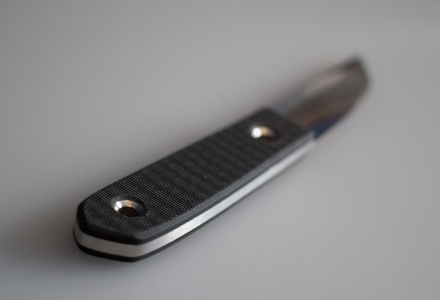

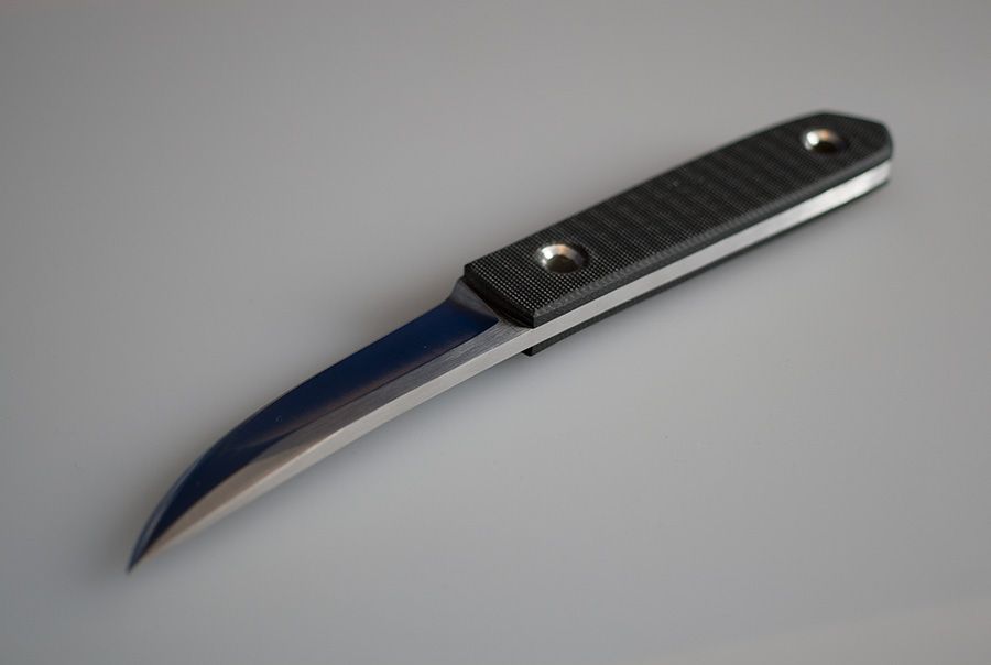

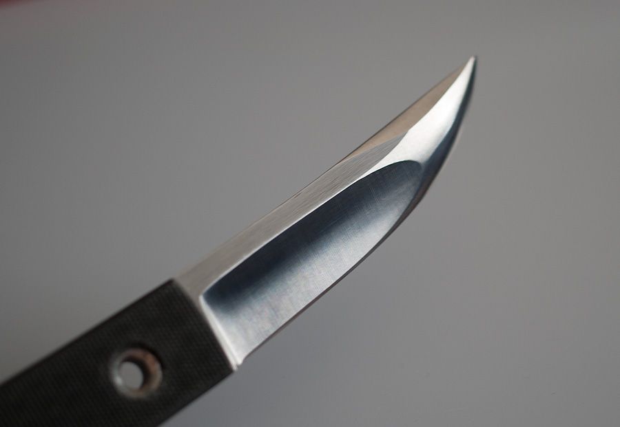

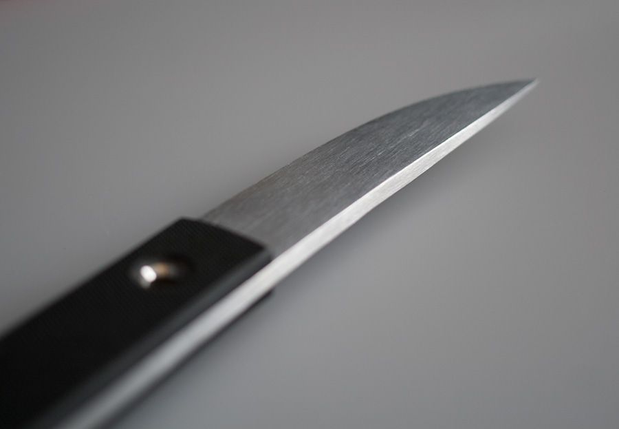

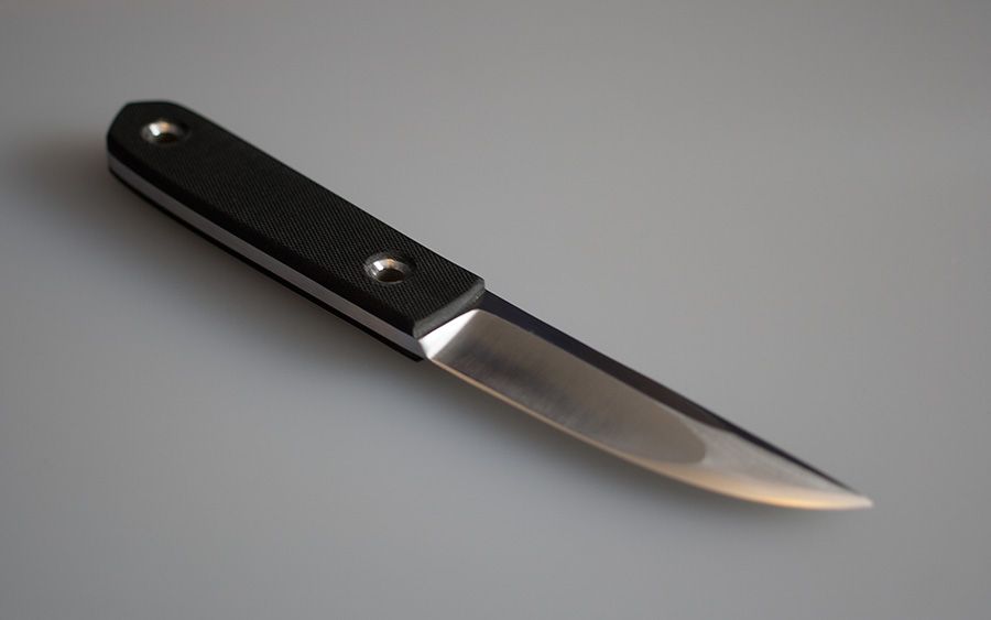

KamSingh Joined Jan 9, 2006 Messages 790 Jan 19, 2016 #1 3/16" O1 and peel-ply G-10. Chisel ground with a deep main hollow and convex tip hamaguri style. 3.5" blade, 7.75" overall. Thanks, Kam

D d762nato Gold Member Joined Dec 16, 2009 Messages 9,088 Jan 20, 2016 #6 Beautiful I like it very much especially the way you did the tip.
KamSingh Joined Jan 9, 2006 Messages 790 Jan 21, 2016 #7 Thanks guys, was a challenging grind but I'm pleased with the way it turned out, plan on making a couple more.
