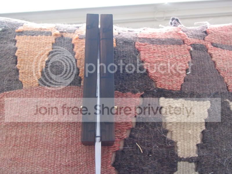

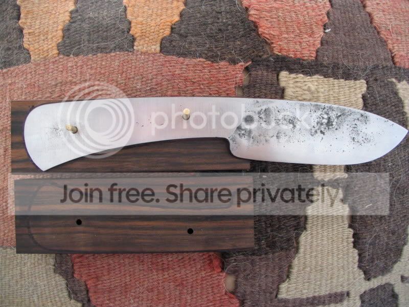

I tried a Google search of BF and also looked for a tutorial without success. I'm working on a blade that was forged during a lesson with Tai Goo, and it has a tapered tang. My experience level is I have a few blades in progress but have yet to actually finish one.
I've read a number of tutorials about handle scales, but the following things I'm not sure how to adapt or address on a tapered tang:
-pre shaping the scales by pinning them together. Since the scales are not parallel when mounted and drilled, the holes do not line up nor again are the scales parallel when mounted. Do you shape them on the tang before glue-up, or just shape them individually?
-along the same lines as the first question, when and how do you do the shaping on the sides of the scales to make them parallel (or however shaped they will be) when done?
Here are a couple of pics for fun...please excuse the dog hair!

Thanks for the comments; I really, really appreciate the input...but I'm still confused! I've already drilled all of the holes and everything lines up beautifully. I used this tutorial to do the drilling:
http://www.knifeforums.com/forums/showtopic.php?tid/758277/
Since the holes in the scales are offset due to the tapered tang, I can't really pin them together to do the shaping, and if I did I don't believe the edges would be square once I put them back on the tapered tang.
Also, since the tang is tapered this causes the handle to be thicker at the ricasso than at the end of the tang and I'm wondering if there is a trick to evening this out easily, or if you just have to eyeball it? Also, would it be better to do this before gluing or after?
I hope I'm not being too dense. I've read multiple tutorials on normal tangs and have those concepts pretty well down, it's just I'm having trouble translating the process to the tapered tang situation.
