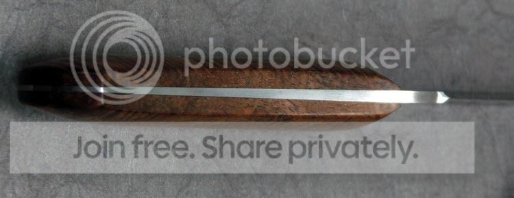

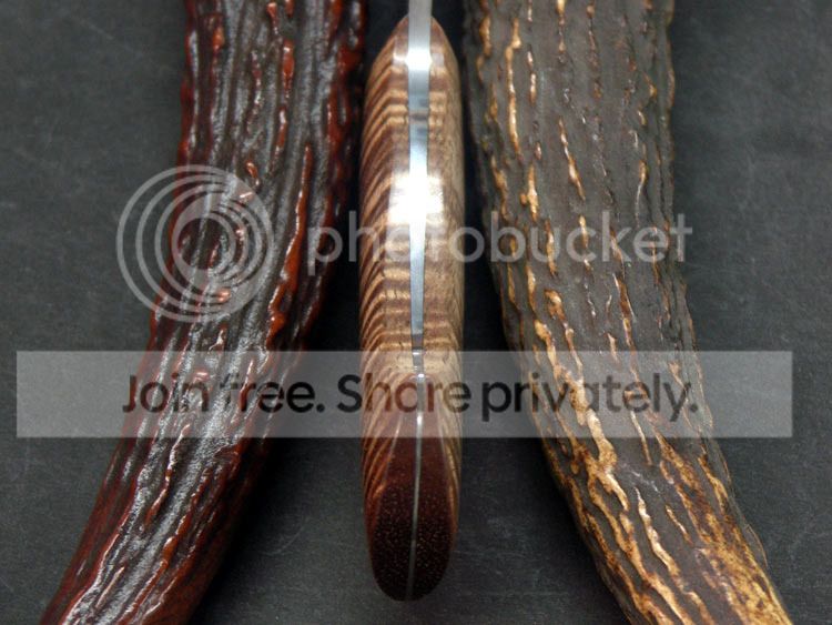

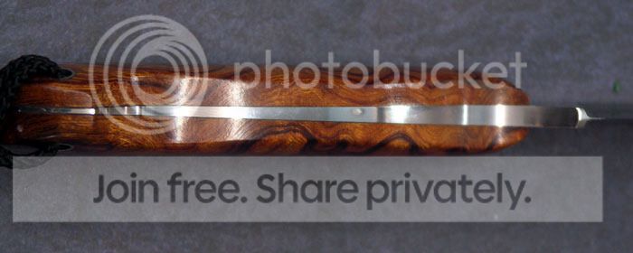

It's a good question, I usually taper it as much as I can, I take allot of mine down to almost zero. 3/32" wouldn't look to bad on a 1/4" thick stock but if your starting with 5/32" and taper it to 3/32" it wouldn't look that pronounce. I wouldn't say there's any "to thin"
I hope that helps a little bit ;)
