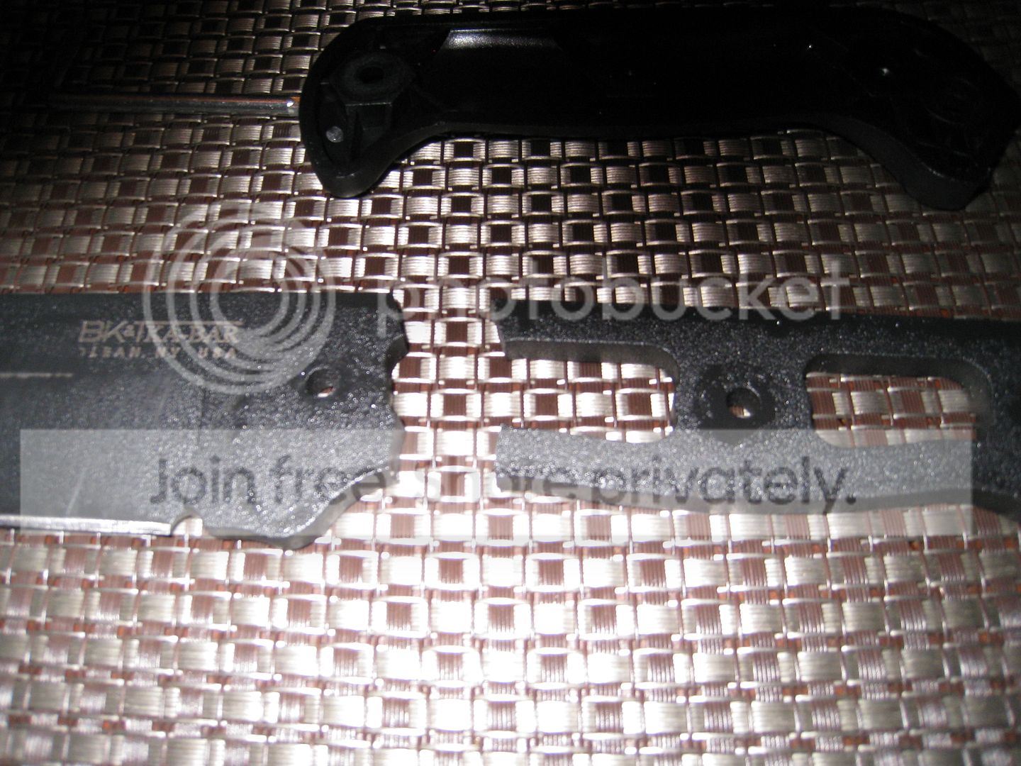

Of course, literally minutes after I mentioned that knives rarely break in the tang itself, I stumbled across this....
This is why I'm not a fan of differential hardening/quenching, no matter of the tang style. It creates a hard blade (which is good), a soft tang or spine (which is not necessary) - and a weak spot right in between... which can be very very bad.
It's much better to harden the entire piece fully, temper normally, and then draw the temper back just on the spine or tang. No transition areas that way. (It's also still not necessary IMO, but whatever)

It's hard to tell from that picture due to the coating but it looks like the skeletonizing still has a ninety degree edge. If you are going to skeletonize you have to get rid of the ninety degree edge. Chamfering your drill holes as well. A properly built skeletonized handles is fairly strong. That picture is a good example of what happens when you cut corners to make a buck.

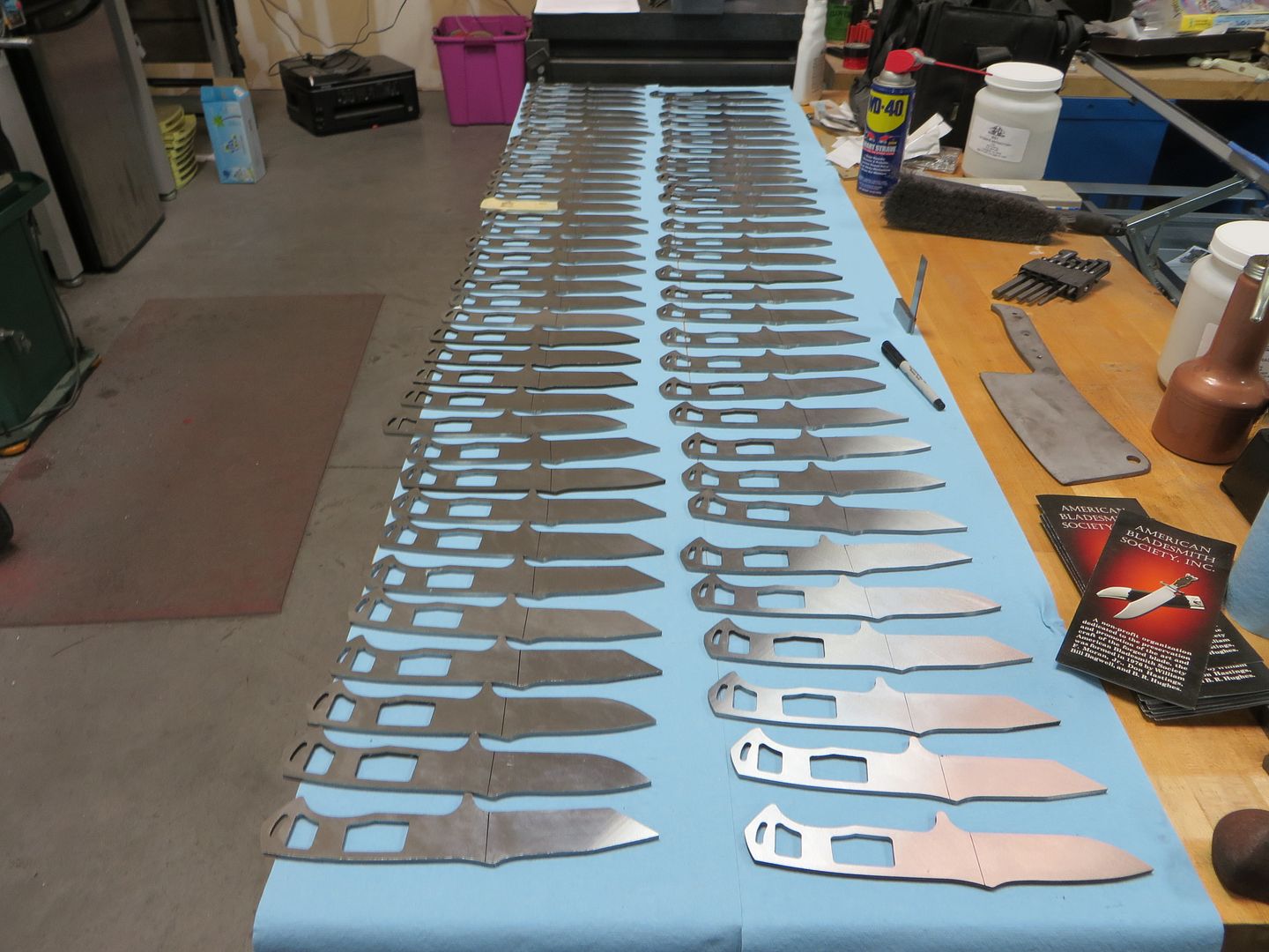

I'm doing another large batch of knives, this one with skeletonized handles. Everyone of them I have gone over with a carbide die grinder, file, and sandpaper to remove burrs, ninety degree edges, and swarf marks from the water jet cutting.
I think skeletonized handles are less attractive than tapered tangs, but strength wise I would be hard pressed to put a percentage on how much a tapered tang will perform better than a properly skeletonized handle. The up side is on a large batch like in my picture it is a lot easier drilling the holes in the handle material than setting each one up in a jig to drill the holes in a tapered tang. Something else to remember do not skeletonize or drill large holes just behind the ricasso area, like in your picture. In mine the skeletonizing starts at nearly one third the length of the handle leaving the area that is subject to stress full size.
We're still talking about sections of 1095CV roughly 3/16 - 1/4 square. Go ahead and make/fully harden and temper a little bar like that - square corners or not - and break it... tell me how much force it takes. Now make the same size piece and only quench half of it. Guess where it will break?
Chamfering is ALWAYS a good idea, but it wouldn't account for a tiny percentage of many hundreds of knives breaking in exactly the same place. I've seen that happen to that brand of knives before. It's an HT issue, not a physical/mechanical one.
