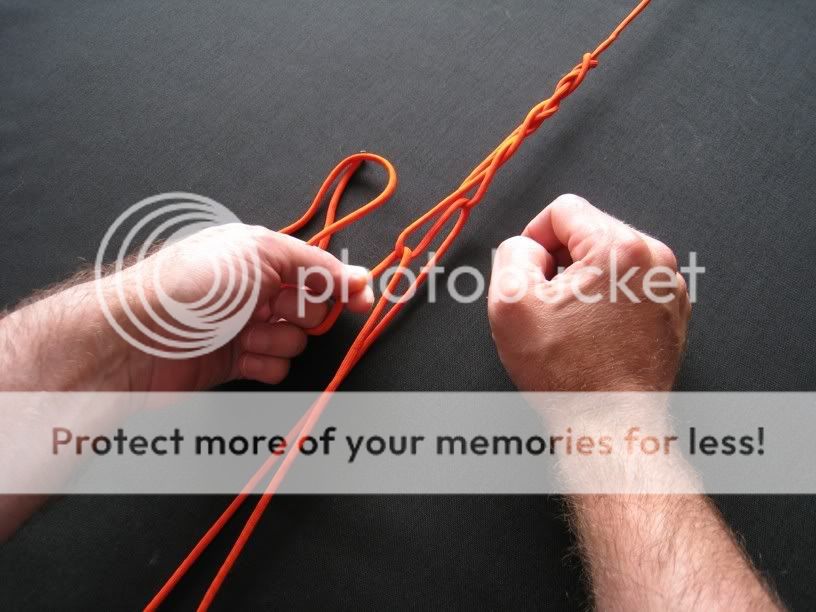

More often these days I use a modified version of the Trucker's Hitch, originally shown to me on one of Mors Kochanski's courses. It needs more spare distance between trees, but only requires you to wrap around the tree one time, which I find easier and faster.
IMG_6760 by Last Scratch, on Flickr
The main ridgeline is on the left and the working end is held in the right hand. A loop is twisted by the left hand in the ridge. At least three twists, in smoother line, four or more are needed.
IMG_6761 by Last Scratch, on Flickr
Fold the twisted loop back towards the tree around which you just passed the free end of the line and take a "bite" or tight loop of the line through the twisted loop.
IMG_6762 by Last Scratch, on Flickr
Pull this bite as if you were making a chain of loops.
IMG_6772 by Last Scratch, on Flickr
Pass the working end of the line through this new loop.
IMG_6773 by Last Scratch, on Flickr
Pull on the working end to add tension to the line. This arrangement is like pulley, providing mechanical advantage.
img_6684 by Last Scratch, on Flickr
To lock off the tension, pinch the bite...
img_6685 by Last Scratch, on Flickr
...and slide your finger and thumb to push/pinch the point where the line bends. This is like putting the brakes on, by pushing in the same direction that tension has been applied, tension is maintained while you tie off.
img_6686 by Last Scratch, on Flickr
Create a loop, like a figure 4...
img_6687 by Last Scratch, on Flickr
...and pass a loop of the working end of the line through.
img_6688 by Last Scratch, on Flickr
Pull on the loop, in the direction shown, back towards the rest of the knot, to lock off. Try to pull asymmetrically on the loop so that you tighten the half hitch you just made, without pulling too much of the tail through.
img_6689 by Last Scratch, on Flickr
The finished hitch. See how those multiple turns in the original loop wrap around the line, the friction they provide prevents the knot from closing up.
img_6690 by Last Scratch, on Flickr
With only one twist at the start you end up with a figure eight loop, which gives slightly less mechanical advantage, and because it lacks the friction to stay open, can tighten up to become much harder to untie when it is time to pack up.

The Trucker's Hitchs is often illustrated like this:
Truckers_Hitch by Last Scratch, on Flickr
As can be seen, this is basically the same as above, but with a sheepshank type loop locking one end. This additional security does not seem to be needed if you have enough wraps.

You mention that the modified Trucker's Hitch was demonstrated by Mors Kochanski. In his book, 'Top Seven Bush Knots and the Use of the Windlass' he shows the 'tie-through' loop as a 'Figure of 8 noose-loop' and the finish knot as a 'Slippery Sheet Bend'. Has he rethought this or are the changes, yours?
You explain further down that the Figure 8 can tighten up, making it harder to untie but how does it give less mechanical advantage?
Personally, when tieing the Trucker's Hitch, I use a Single Lineman's Knot. I have never found it difficult to untie after a load has been applied.

Regarding the mechanical advantage, maybe I shouldn't have said it that way, but if the knot does not close up, the loop that is acting as the primary "pulley" gets longer as tension is applied. This means that line is moving through the wrap-loop, which acts like another pulley. There probably isn't really that much difference in practical mechanical advantage;:eek:
