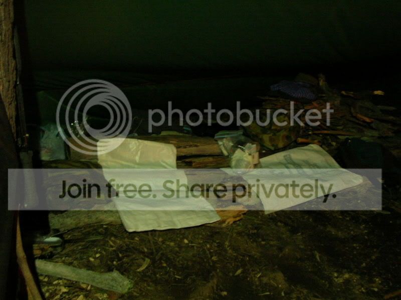

Generally string up a old tent fly between two trees and angle it down so that the wind is blocked. I'll lay several 10 - 15cm limbs along the ground to form the basis of a floor. A couple of woven plastic produce bags stop any moisture movement into my clothes.
I then set up the fire about 3 meters on the down wind side of the fly.
