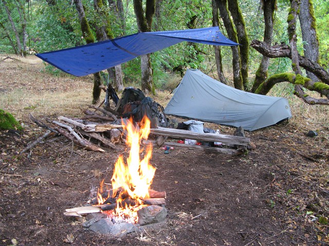

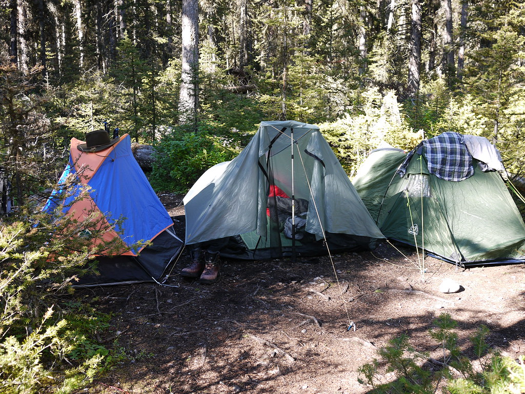

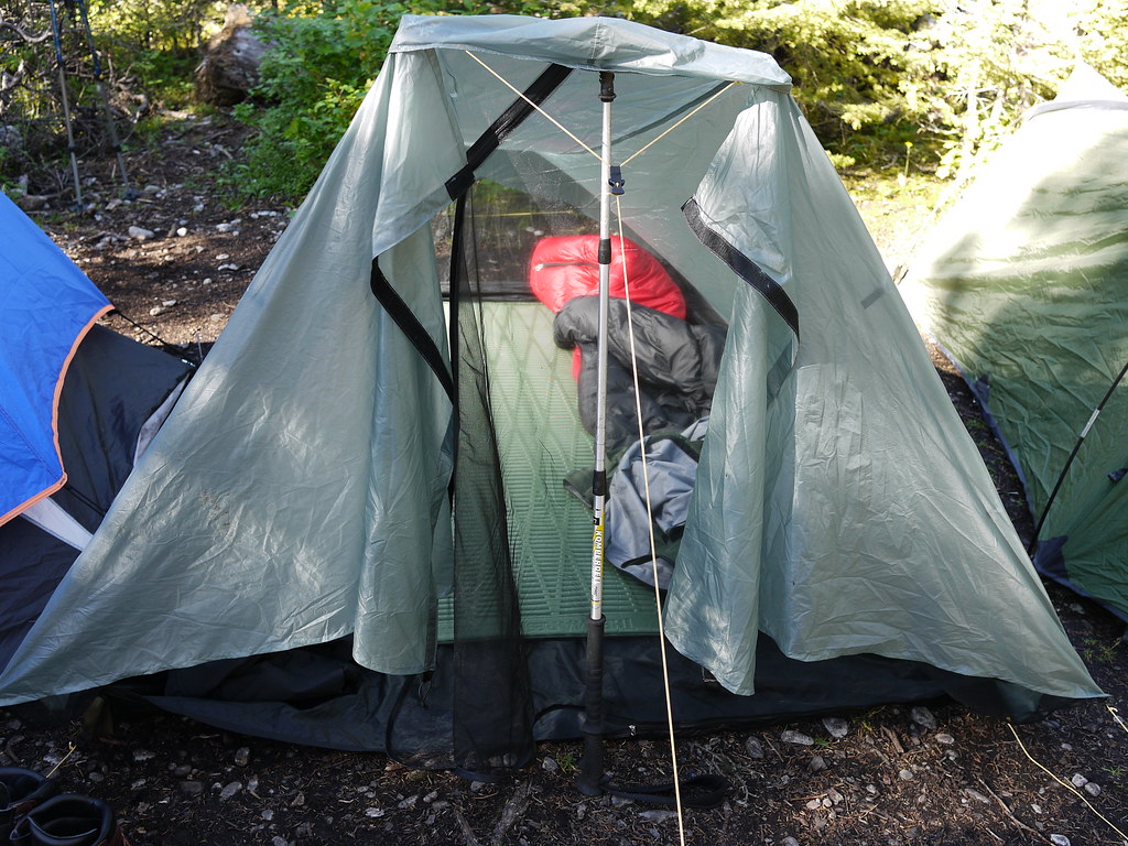

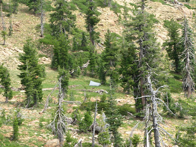

I've used my Squall 2 with bathtub bottom in -15C weather, no condensation problems. I've used it in a 24 hour straight rain and sleet storm at 3000m in the Rockies (summer!) and no condensation or water problems. I faced a pretty crazy wind storm one night in Turbine Canyon (named for a creek, not the wind). I had a problem there. There was no wind when I set up and when the storm hit I was facing the wrong way. My tarp tent blew over and since I was using hiking poles, the steel tip that you stick in the grommet up top caused a small tear. I think that's the only weakness, and I've since avoided using hiking poles and instead simply tie the attached rope to a tree and make sure the whole thing is very taut for wind whenever possible. Other than that, I simply love the lightness and ease of setting up (I can throw mine up in about one minute).
Here's some shots of it and where I use it.
