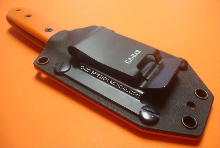

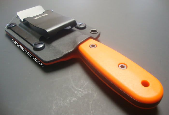

Thanks for the mention! I like the TDI for a Kydex sheath setup but I'm still waiting for someone to order one "Horizontal" I think that's where the clip would really "shine" and there's plenty of room... I think I'll make one up and post pics of it here. I've made a couple for vertical carry and I've moved the knife down as far as possible to get it "out of the way" and as always anywhere I can the sheath is as small as possible. Kydex is definitely the way to go, I made a setup recently for one that has Kydex straps that hold a leathermen sheath on the front and it has space for a pen, lighter etc. came out pretty cool but I'm waiting for finished pictures of the setup.
You can still add options to it like a Mini-Bic holder too:
This is a bad picture (dirty lens) but same setup:
Hope this helps,
Eli
