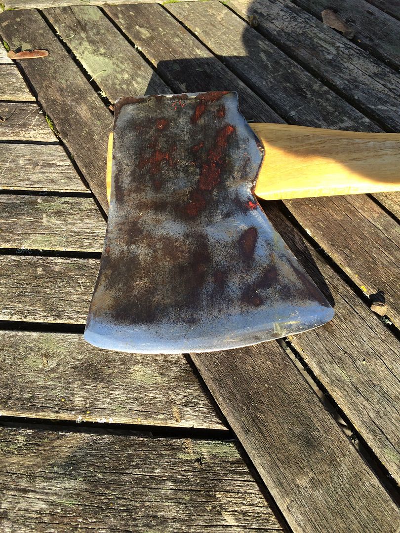

Can someone post a picture or illustration of this to give me a little better understanding?
I can try :)
This was a Jersey head that had a chunk taken out of the bit above the heel. It was a kind of jagged half-moon. Leaving it wouldn’t have kept the axe from cutting but not taking care of it would leave a weak spot in the edge.
I do not have a picture of the original damage but this first one shows about halfway through filing it out. The damage is pretty much worked out but the rest of the bit needs to be brought back to it make the same grind run the length of the blade. I guess I was trying to say that sometimes chips beget chips if they aren’t taken care of. Small ones maybe less so but they do create an uneven area that might be prone to more damage in that same area.
This is what I ended up with. It maybe isn’t prize worthy but note the grind doesn’t fall to the tips of the toe or heel as thin as the center. I wasn’t thinking show and tell with this one but I did think it was worth saving – no maker’s mark but stamped 3 ½ at the poll on the reverse side.
