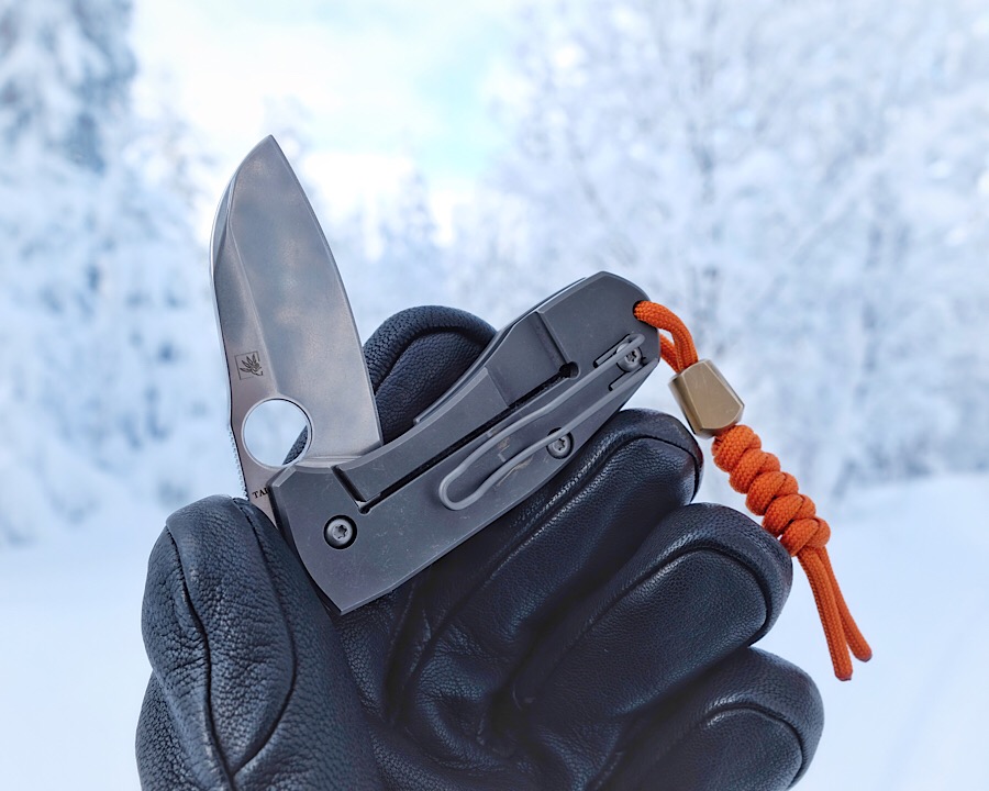

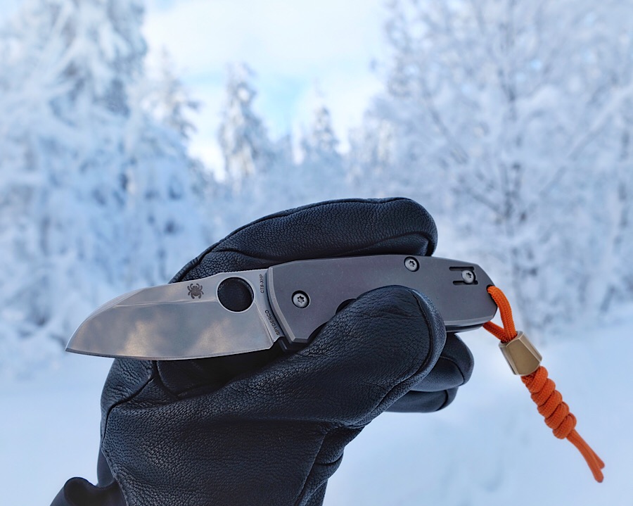

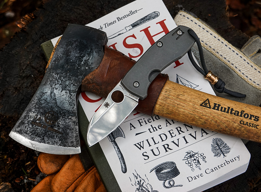

So... let me share also here my initial thoughts after about 3 weeks of carrying and using Techno 2. First of all - it’s easy to spot the similarities between Techno 2 and original one - very close handle shape, overall size, hole positioning vs handle. But it’s actually substantially different knife in performance and cutting action imho. It’s a matured design. In a small knife like Techno a modified warncliff blade style with slightly curved edge performs imho (!) a bit better. Mainly thanks to straighter (but not straight!) and effectively longer cutting edge, which is positioned lower vs line of a handle.
Also I just like that blade shape a lot more - it’s kind of modified santoku with sharp tip (that’s also why I like so much Sebenza Insingo). Blade stock is slightly thinner than on Techno 1, so despite a lower grind line the cutting performance and V-geometry is on pair with excellent cutting power of Techno 1. Or even better (especially in hard materials) as the spine is considerably thinner. Tip is still very sharp (it’s absolutely NOT a safety tip, like classic sheepfoot blade). Also precize cutting through stuff like paper, leather, etc. on a flat board is so much easier with this „pointy warncliff” style blade.
Opening is easy, action is smooth (but it’s not a friction-less action of ballbearing pivot... thanks Lord!). Lock is very positive. Actually handle slabs are considerably thicker than on first Techno, so Techno2’s frame lock is even more secure and solid.
Clip is a standard wire clip, works well with low signature. The lanyard hole positioning is perfect, at the very end of Ti slabs - so lanyard makes a natural extension of a handle. On a small knife like this - it’s a good thing.
So far the weather locally makes it hard to test it in the field. Too much snow, everything is frozen. I tried it a bit, it cuts really well (as expected) but for a long term cutting review you need to wait a bit more. Anyway, so far so good! Should be great EDC, especially combined with SAK and/or small prying tool like this one pictured (by Woro Knives) or Atwood’s PryBaby.
Which one do I prefer? Well, both are great, original Techno is now a Spyderco’s classic. But for aesthetics (my own aesthetics, so ymmv) and performance I guess Techno 2 has a clear edge over the first version (thinner blade, thicker Ti, warncliff blade). Only time will tell.
But no worry, this thread WILL be continued :)

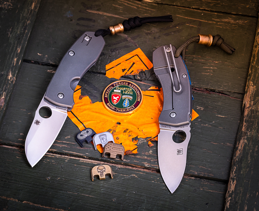

Here is my share of thoughts, initial observations in random order:
my April-ordered unit was apparently finalized in March 2019 (datecode "CS"). I am pleasantly surprised because early adopters reported a dark gray boring matt finish, not stone-washed. my titanium handles have a stone-washed tumble dark grey super smooth finish; similar to the t1 finish, just darker:
the blade lockout is at 50\50 (or 47\53), i.e. slightly less than 50%. in my books that's neither early nor late but optimal:
the original pocket wire clip has to be called strong, sturdy, that's my impression. and with 1.60mm wire thickness it is noticeably stronger than the flimsy 1.40mm wire clip of my t1l. having experienced now the physicality of the techno2 clip, i am herewith stopping all my endeavours to source a different/cheaper/better/stronger wire clip: the Milwaukee clip might be cheaper but it ain't better or stronger, no single doubt!
clearly, if i ever needed a t2 replacement clip, i will not hesitate to order the original part from SFO direct (at the time of writing, international shipping for this part is a friendly 5 bucks only, nice!); and when that happens, i will revisit this thread and let everyone know. I really don't know about the t1 clip, but the t2 clip instills confidence into critical user me; no shopper should be concerned about the strength of t2 wire clip!
however, i have substituted the t1l wire clip. why? because it is more flexible (or "flimsy" as i called it names) and because its lip is higher (lip height 5.2mm), making it easier to slide the clip over the brim of the pants pocket. the t2 clip has a rather low riding lip (lip height 2.6mm) to accept different brim thicknesses, making it a tight fit to slide over a jeams brim:
i am keeping the t2 clip as original spare part, because it's only a matter of time when the t1l wire clip will fail on me. the potential disadvantage of a higher lip is that it could accidentally snag on something more easily; a flush/flat clip (lip height 1.3mm or lower) would have zero potential to snag on something.
on the t1 it wasn't, on the t2 the titanium lock cutout is chamfered (bevelled). however the old problem persists: the pants pocket brim gets caught in there, in the cutout. i have modded the part and eliminated this problem as i did on the t1l. BEFORE the mod:
it took me like four times to achieve an acceptable result:
after cutting off the excess hot glue with the sharpest blade ever ;), i'm good now. AFTER the mod:
see the new clip lip and my clean chamfer cuts:
poor photo, looks better in reality:
ditto:
the right index finger sits on a new pressure point, when you choke up on the blade. really ouch. the t1 doesn't have that; choking up on the t1 blade feels comfortable. well tbh neither of the two model versions is very comfortable in tightly gripping hands thanks to the pressure points by the wire pocket clip ouch. bygones. :rolleyes:
it's easy to thumb-flick the knife open, the detent isn't as frikking strong as on the t1l. when unlocked, the blade swivels freely, and when locked, it is rock solid with absolute zero play whatsoever. crazy good stuff.
all the hardware requires the same sized head torx driver (T9). very convenient for disassembly/reassembly
the lanyard hole is smaller. only gutted (standard-) paracord would fit through.
yes i'll admit i like the t2 better because i had the t1l first. but honestly if had had the t2 first, i would have liked the authentic t1 better. twisted mind psychology.o_O and if i had had the authentic t1 first, i would have stopped looking. so i am glad that i got my filthy hands on the t1l first: of course the t2 feels and is a total upgrade compared to the t1l! needless to say, i have retired the t1l. both are absolute keepers. am glad to own both.
the techno's have become my favorite EDC pocket knife #1468, even ahead of my delica endura pm2. depending on the job day ahead, i'd either carry the techno or carry and use the Utilizer instead (to save the techno blade's edge for another job day ;)).
