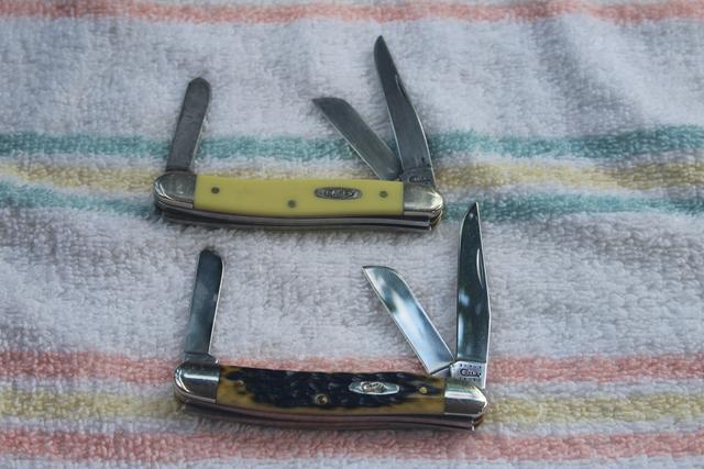

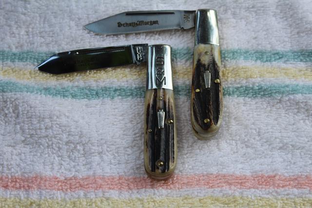

My cutting needs are such that I don't really need a specific type of steel. Opening packages and mail, breaking down household cardboard and plastic, food prep and the occasional gardening chores are the majority of what I do with a knife. However I do buy a lot of older (and some new) knives that not only need sharpening but also need reprofiled. I have not found a lot of difference in the sharpening of either CV or Case SS or edge retention this may be because of my light use of a knife. I do wish that Case would step up and offer both better steels and more consistent F&F. I am a fan of Case knives they offer a lot of great patterns and they are USA made but I know myself and a lot of other folks would be more than happy to pay more for their knives if they would do so. The first picture shows two #18 pattern Stockmen an Old yellow CV and a Jigged bone SS I like both of them. The second picture shows two S&M knives with my favorite carbon an stainless steels for traditional knives 1095 and CPM 154. I sure wish Case would offer these two steels.
