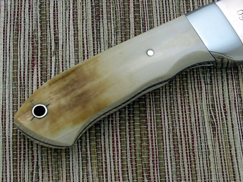

I thought Id show you the one that I just finished putting an edge on this morning. The ivory used on this knife has been sitting in my material drawer for quite a while and I finally knuckled down and put it on a blade that was worthy of it.

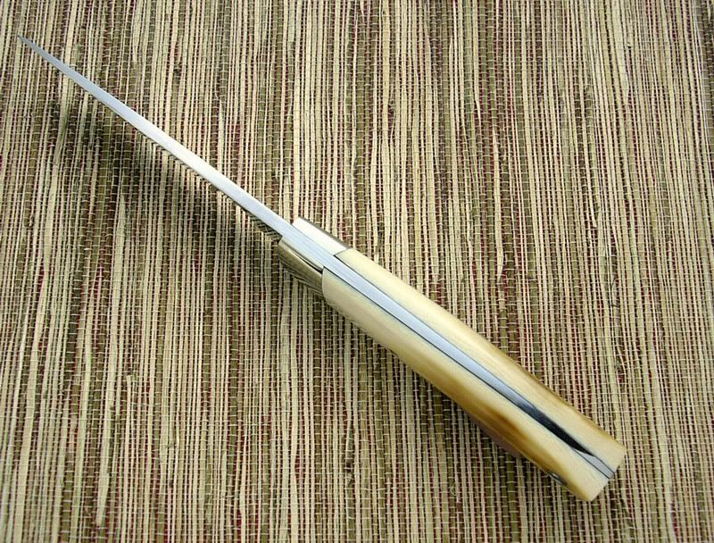

Overall length: 9" RC 60-61; blade length 4 9/16" of 5/32" flat ground 440C Stainless with a finely tapered tang. Blade has a 600 grit machine satin finish. Bolsters are nickel silver with matching pin and thong tubing.

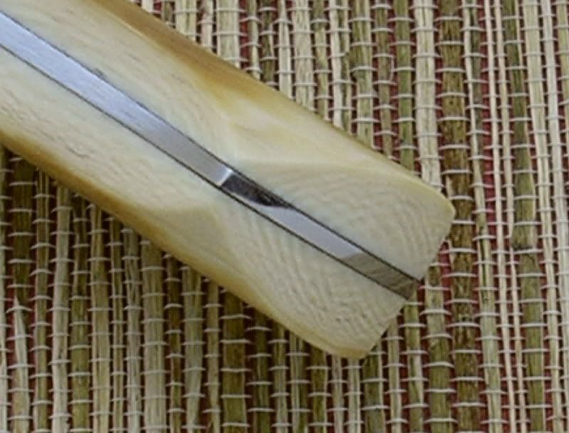

Handle material: Beautiful Pre-Ban Bark Elephant Ivory. There were a couple small surface cracks on one side (part of the character and mystique of bark ivory in my opinion) so that's where I decided to put the thong hole. They of course show up better now that its polished out but, again, they are only surface cracks and have nothing to do with the integrity of the scale. You can see clearly on the butt and spine pictures what I mean.
