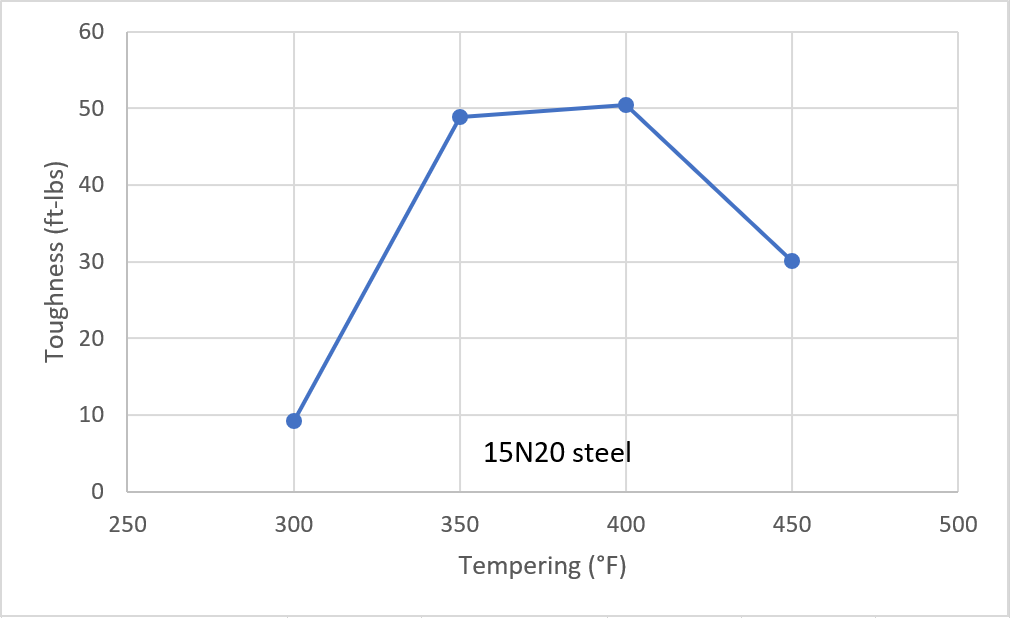

Low alloy and simple carbon steels are most susceptible to TME. Small alloying additions do not typically have a strong effect on TME. Greater than 1% Si is added for delaying TME in some low alloy steels. The high chromium and other alloying elements delay the carbide formation in high alloy steels, but we have still observed it in some high alloy and stainless steels we have tested with 500-600°F tempers.
Thanks "Hoss and Son", that is the range I concern myself with for carbon steel and TME.
I recommend to stick with 400°F and not 450-500°F unless you have data showing it is not an issue. Some steels it shows up at 450°F, some at 500°F, and some hotter.
Here is a summary of some prior testing results. First as an example of low alloy steel vs high alloy steel I have a plot charting two steels tested by Crucible, where O1 saw TME at 500°F but in A2 it didn't happen until 600°F:

Several steels showed TME at 450°F, including 5160:
15N20:
