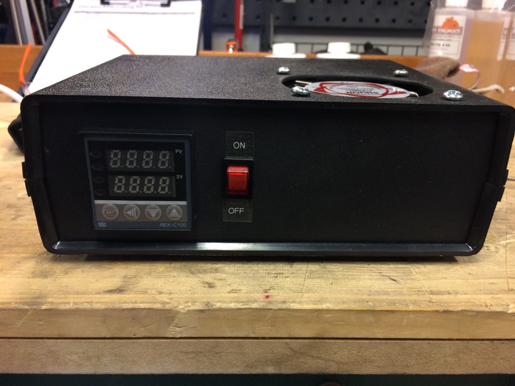

I also use kitchen oven with inline PID.
Good setup to run any plug-in device. My only caution would be that with the load of an oven, a heat sink on the SSR would be a good idea.
Your fan installation shows a common error in in design engineering. I have dealt with this from pros before, so you are in good company in your oversight.
The fan either brings in fresh air or evacuates warm air - so far so good. But, where is the air exchange? There is no vent or screen to allow air in or out. A fan in a small enclosed space does almost no cooling. It needs an opening equal to the fan opening to allow air exchange. Preferably, this opening should be placed to make the air move across the heat generating component.
Drill a grid pattern of 20 or so 1/4" holes in the back of the plastic case behind the SSR.
Thanks for your comment. I see what you mean. This is an area I'm reasonable knowledgeable about. I've been building computers for several decades. In this configuration I was going for air flow with a negative air pressure. Since we're not creating a vacuum there will always be air sucked into the case. In this case it will mostly come from the hole for the probe.
But I agree, a couple more holes would greatly increase the air flow - but it would also increase the dust inside the case.
