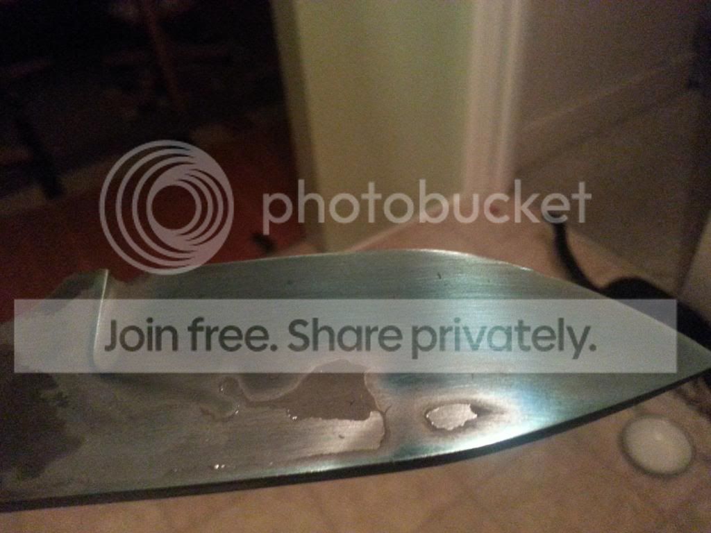

So I just heat treated my blade, and tempered for the first time in a toaster oven. The blade turned a light blue:
I tempered at 400, at least the thermometer said that, for 2 hours. From what I have read here, it seems like the blade was hotter than 400 though the air did not. The blade was wiped of excess oil and then sanded with 220 sandpaper after quench.
My question is, as I assume I ruined the HT, am I able to re-HT this blade or is it ruined? Would I have to do anything special if I did try to re-HT?
For the long-term, how would I make this toaster oven better for tempering? I have seen Stacy's post in regards to modifying the toaster oven and the steel plate. Could I just use a low setting? What are these baffles I have been reading about?
Thanks
It may be a bit more blotchy than it shows in the picture.
Maybe it is just oil residue?
Oh, and it's 1084!
Sharpen it and do some cutting. If it was properly hardened, you should be ok.
Color from temper means very little. Get an extra oven thermometer to use in your toaster oven, that's more accurate than the dial.
Thanks. I did use an oven thermometer. It stayed at 400, but I have yet to see the blue tint before, so it scared me. Would I be okay to do another temper cycle? Or should I finish the edge and test first?
I tried bending the blade and it didn't flex at all, but this is the first time using .2" thick stock.
Single temper for 1084 should be sufficient. I would sharpen and test. Watch for edge retention, rolling, and chipping.
Holds an edge ~ good to go
Edge rolls ~ reheattreat
Edge chips ~ retemper at 25 degrees higher
Be sure to get past any decarb before testing!! 400 should be about top end for 1084 from my experience. But, like I said before, it all depends on a proper heattreat to begin with.
There has been a lot of discussion of radiative heating from the coils, especially when soaking at higher temperatures in a kiln. So heat from your coils could heat your blade faster than the surrounding air or the thermometer. You could preheat a pan of sand and bury your blade in it to help moderate the temperatures if your current blade doesn't come out as you desired.

The color from the tempering oven means little or nothing. I have had carbon steel come out anything from gold to blue and sometimes both. Part of it depends on anything on the blade and the atmosphere in the oven. Some ovens do have a radiated heat problem. You can shield with a cookie sheet and some tin foil or take a cake pan and some sand and bury the blades in sand and then bake
What is the shiny stuff on your blades? ?t looks like cooked on foil I used to get a little of sometimes when hardening super clean D2 at 1850. No need for ss foil on 1084 and if its stuck on that hard how hot did you get it during harding?
I believe it is scaling, I did not use foil. Or it is just the blade itself after sanding, not sure which part you're talking about. I did not sand the blade entirely before tempering.

The colors can be very inconsistent especially if there are any contaminants on the steel. I read a post a while back where a guard was blued at 350f when the etchant wasn't cleaned off of the guard. That is a few hundred degrees cooler than expected.
