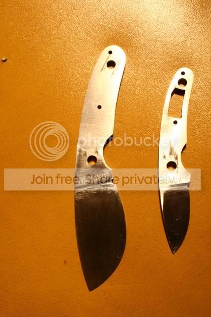

kevin and mete (and all of you, really!), here is the situation. Bruce Bump has accepted my plea for help in heat treating. his house is about 10 minutes from my moms, 20 from my dads, 3 hours from mine. he has generously offered to let me use his HT oven if i can temper on my own. 5160 steel, two blades, look like this...
Since bruce is willing to help me HT, we know that part is right. now, i need to clean some of the anti-scale compound/oil off the blade. the blade is, by this time, at room temperature or close to it. i take it as quickly as i can to my mom's house and put it in her preheated oven for 2 hours (400 degrees, right?). it is a brand new stove last year, so temperature should be fairly close. i have a thermometer, too. take the blade out of the hot oven and let it come to RT. once at RT, put it back in the oven for a second 400 degree, 2 hour cycle. does this sound like what you guys would do in my situation?

724wd, this is what I would do in your situation. Heat the blade to 1525F and soak for at least 8-10 minutes before quenching into a medium speed oil. I would not quench all the way to the oil temperature however, I would interrupt the quench at around 400F. (after the vibration stops you have pulled the blade out at around the right temperature if it is coated with oil with light very light wisps of vapor coming off). Put the blade in a vice and let it cool in the air until cold to the touch. This will approximate a marquench/martemper and will provide a much more stable condition than if you oil quenched all the way to ambient. If it is any consolation, I do every blade I make with a martempering technique of some sort and enjoy the benefits thoroughly. After this method you should be safe to take your time driving to your nearest oven to temper in, but don't get too relaxed because that draw is still very important.
What is going on here is the martempering effect known as "auto-tempering". Since the cooling below Ms (around 400-450F) is in the air and much more gradual, you will have the opportunity to form as much as 40% of your martensite while the blade is still dropping through temperatures capable of tempering the blade, this will allow a snap tempering effect on the martensite almost as soon as it forms. Very pleasant gains in impact toughness can be gained this way, but more importantly for your application a serious reduction in strain and the stress factors involved.
You can try any number of solutions to your dilemma but this is how I would handle it.
