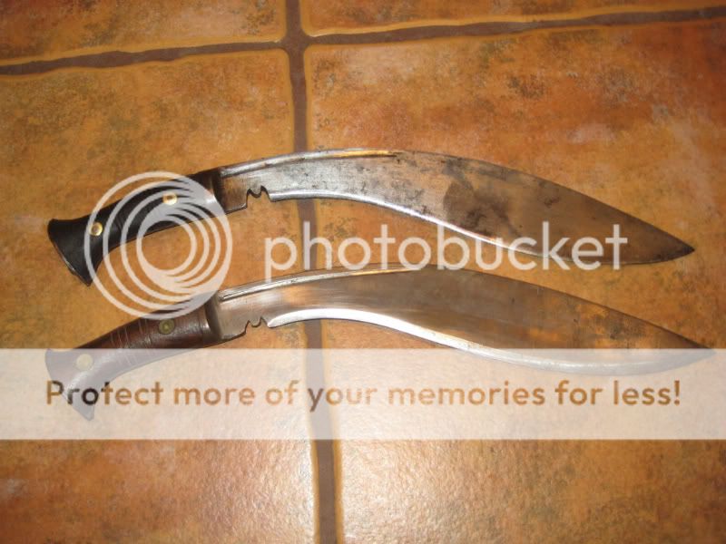

We tried to get something like this going a few times, this being one: http://www.bladeforums.com/forums/showthread.php/839104-The-Great-MKII-Kami-Challenge!/page3 It didn't materialize. The specs are out there and below are the specs on two I believe represent the Mk. II/M-43 khukuri at their best. They are light enough to be fast, but heavy enough to be great woods tools. Some war time production versions were upwards of 26+ oz., but many Mk. II, and all M-43 in my experience, tended to be at or under 24 oz. Since the linked thread, I've come to appreciate even lighter khukuri. I have a Mk. II copy at 21 oz. which, as far as I'm concerned, is ideal. I believe the legendary HI M-43 Wildmike used while living for several years in the woods was a Bura at 24 oz. I'd say 17.5" OAL, with a 12.5-13" blade, at 24 oz. would be a sweet spot for an ideal general purpose khukuri for many people. As I said, I actually prefer a few less ounces, but realize I'm in the minority:). The key is a short, but long enough for western hands, handle, and a distal taper. My period M-43 is about 1/4" at the bolster and shoulder, while my nicest Mk. II is about 3/8 " at the bolster, tapering a little to the shoulder, and thinning from there. Both handle very nicely, though I do prefer the constant distal taper. That removes the forward heavy balance many like for chopping, but adds greatly to the handling IMHO. I believe they would sell well. Good luck.
M43 Variant Mk. II
OAL – 17.5”/44.5 cm
Blade Length – 13.25/33.65 cm
Weight – 23.1 oz./654.8 grams
Handle Length – 4.5”/11.4 cm
Spine Width: @Bolster – .264”/6.7 mm
@Shoulder in front of groove/Sword of Shiva – .243”/6.2 mm
@Tip – .122”/3.1 mm
Tang Width (middle between rings) - .165”/4.2 mm
Handle Width: @First Pin – 1.29”/32.7 mm
@Second Pin – .994”/25.2 mm
Belly Depth – 2.3”/58.4 mm
M-43 on bottom with a 1943 Pioneer Calcutta Mk. II on top. BTW, the Pioneer Mk. II's were Ok, but a little rough. They seem to have been a common WWII Mk. II.
WWI Ringed Mk. II (M.I. II)
OAL – 17.25”/44 cm
Blade Length – 13“/33 cm
Weight – 23.89 oz./677 grams
Handle Length – 4.5”/11.5 cm
Spine Width: @Bolster – .311”/7.9 mm
@Shoulder in front of groove/Sword of Shiva – .3 ”/7.6 mm
@Tip – .125”/3.2 mm
Tang Width (middle between rings) - .12”/3.04 mm
Handle Width: @First Pin – 1.02”/25.9 mm
@Second Pin – 1.028”/26.1 mm
Belly Depth – 2.367”/ 60.1mm
