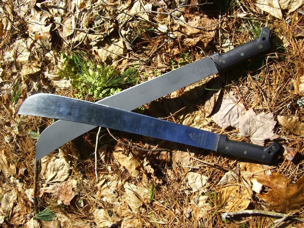

After a query I received in discussion with Joezilla, I decided to do some comparative testing between two identical machetes--one with a mirror polished blade, and one that had been left in its stock condition, but with a coating of Slip-Plate friction-reducing paint on it (which I've been messing around with lately). I had to find a way to do the testing in as unbiased and scientific a manner as possible, and the best thing I could think of was what Joe had suggested--putting a nail (or a screw as it ended up) through the lanyard hole and dropping the blade onto various things. I would have used something like an apple or the like, but I'm a college student and couldn't stand the thought of wasting food, so I used sticks of uniform thickness, doing a cut from both machetes on each.

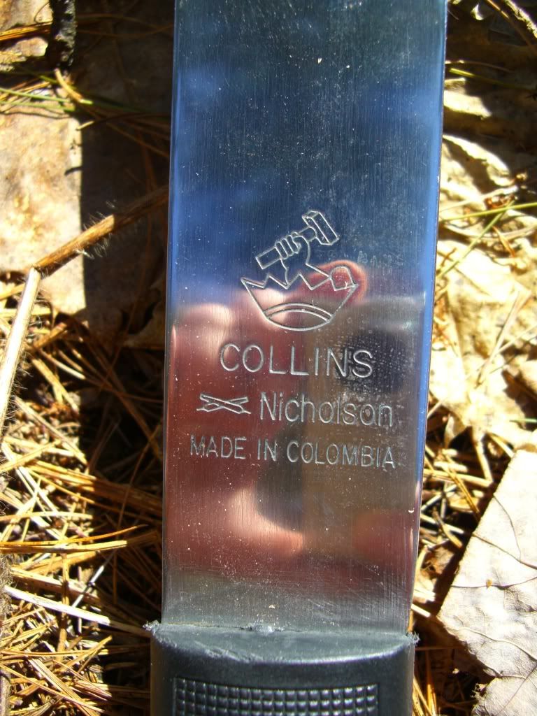

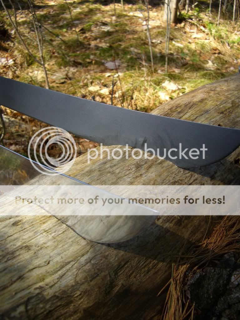

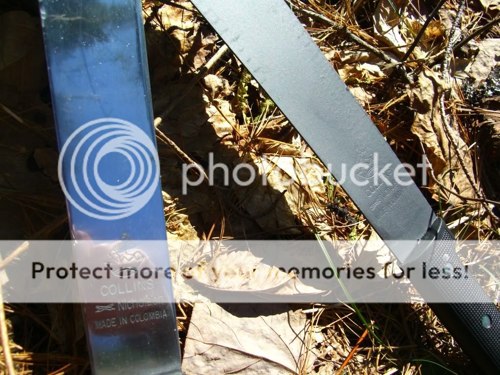

Here are the machetes tested--identical Nicholson/Collins 22" Latin patterns.
Some mugshots of the tang stamps on each. I don't need to tell you which one is coated, do I? :p

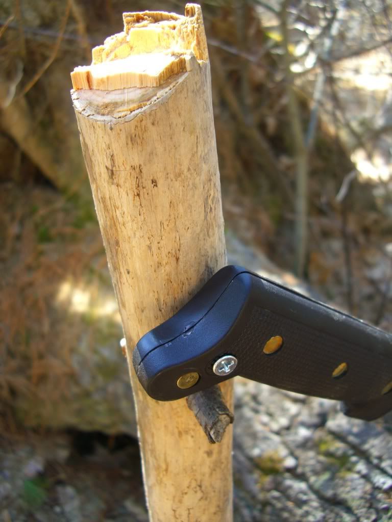

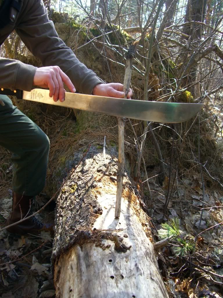

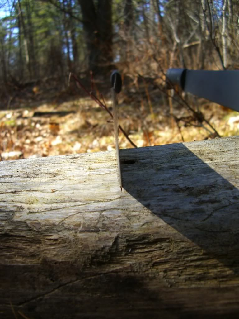

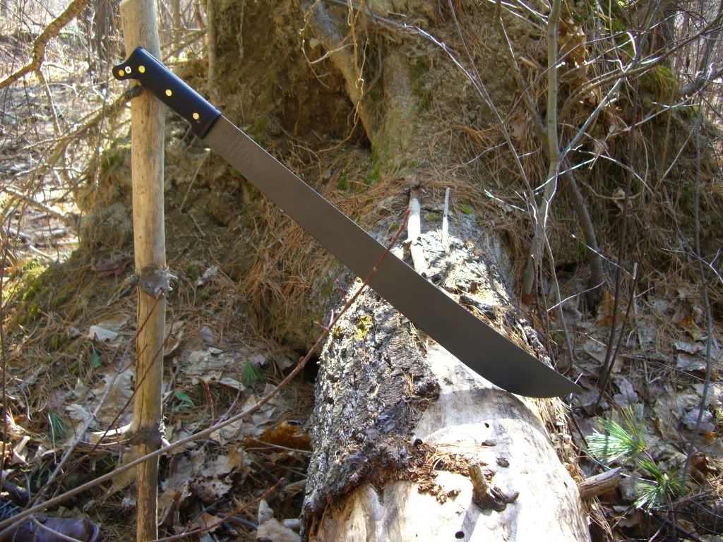

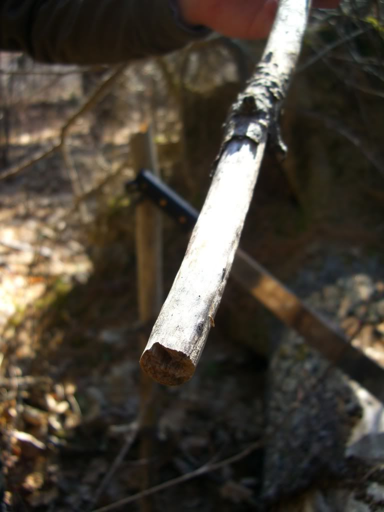

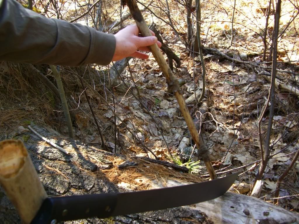

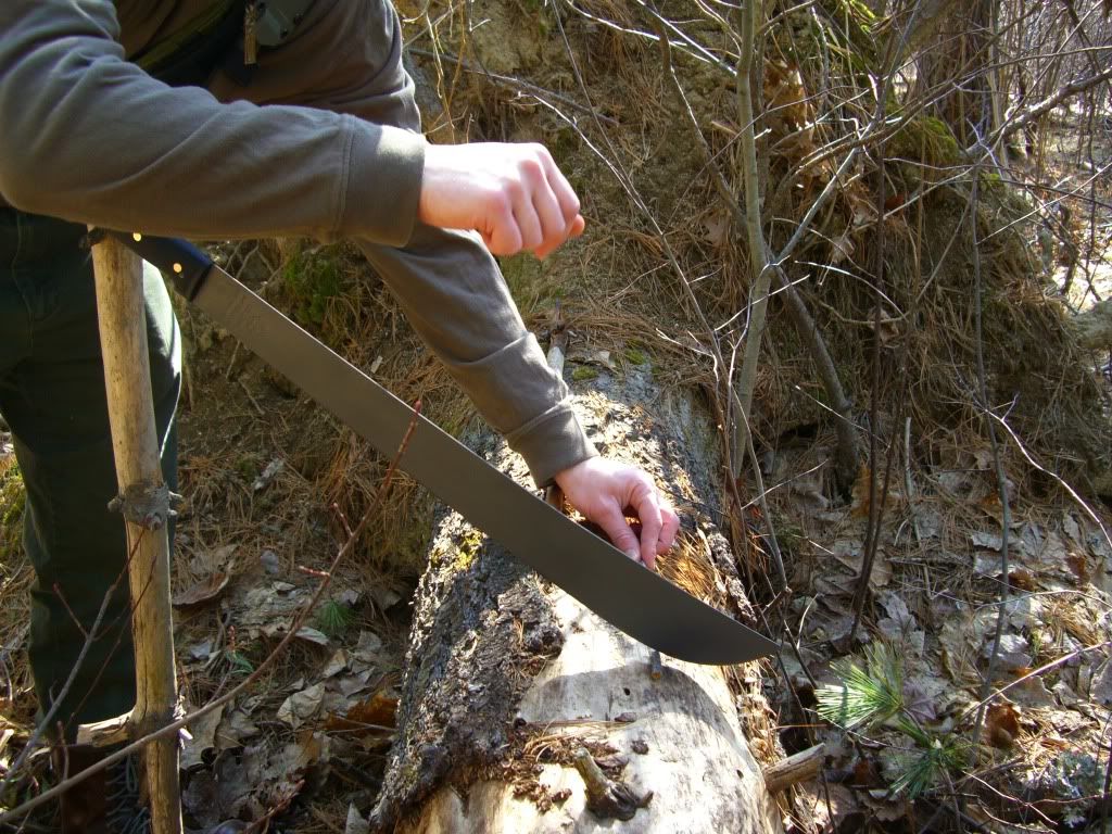

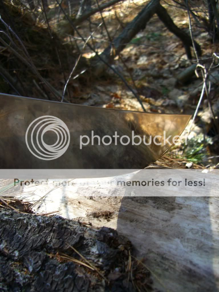

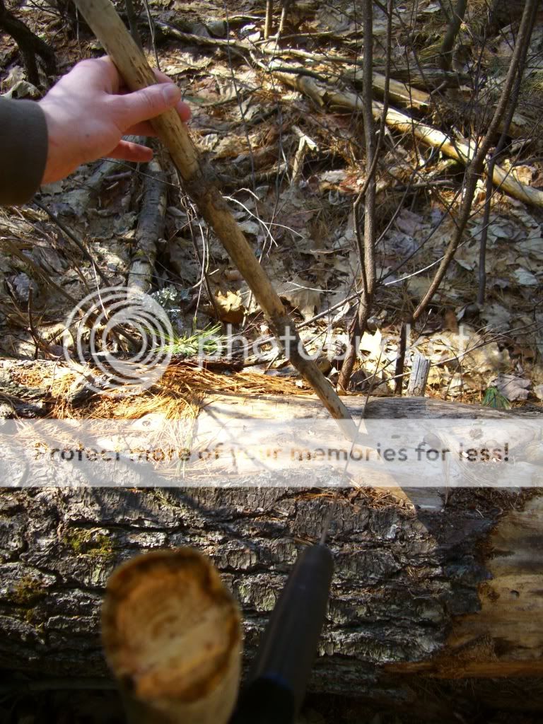

I firmly planted a branch in the ground next to an ancient blow-down. I affixed the machete to the branch via a wood screw through the lanyard hole, and the whole apparatus was positioned such that the sweet spot of the blade would land squarely on the trunk of the blow-down when dropped. It served as my "anvil" for the purposes of this test:

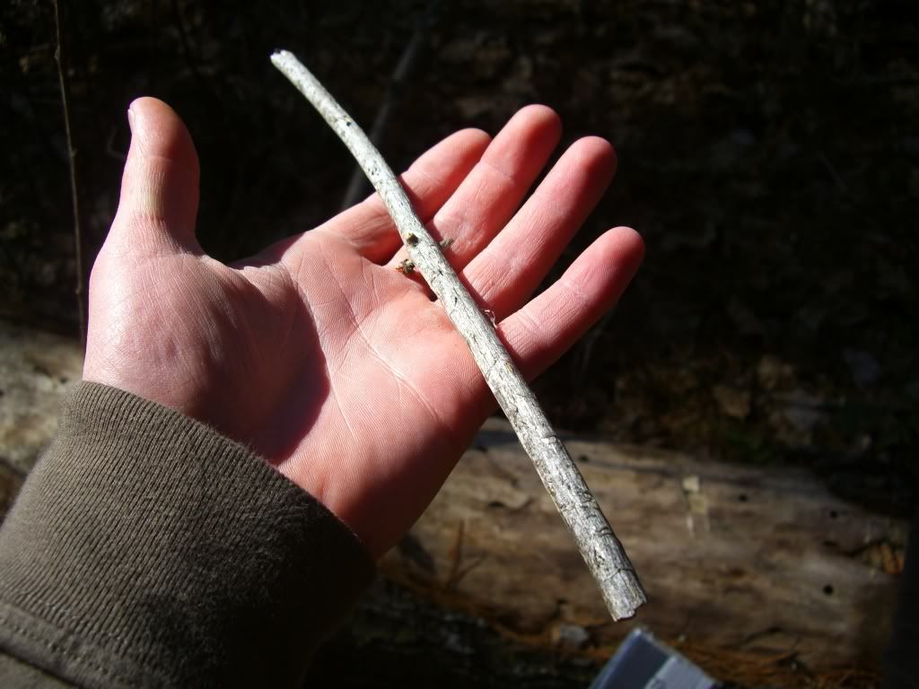

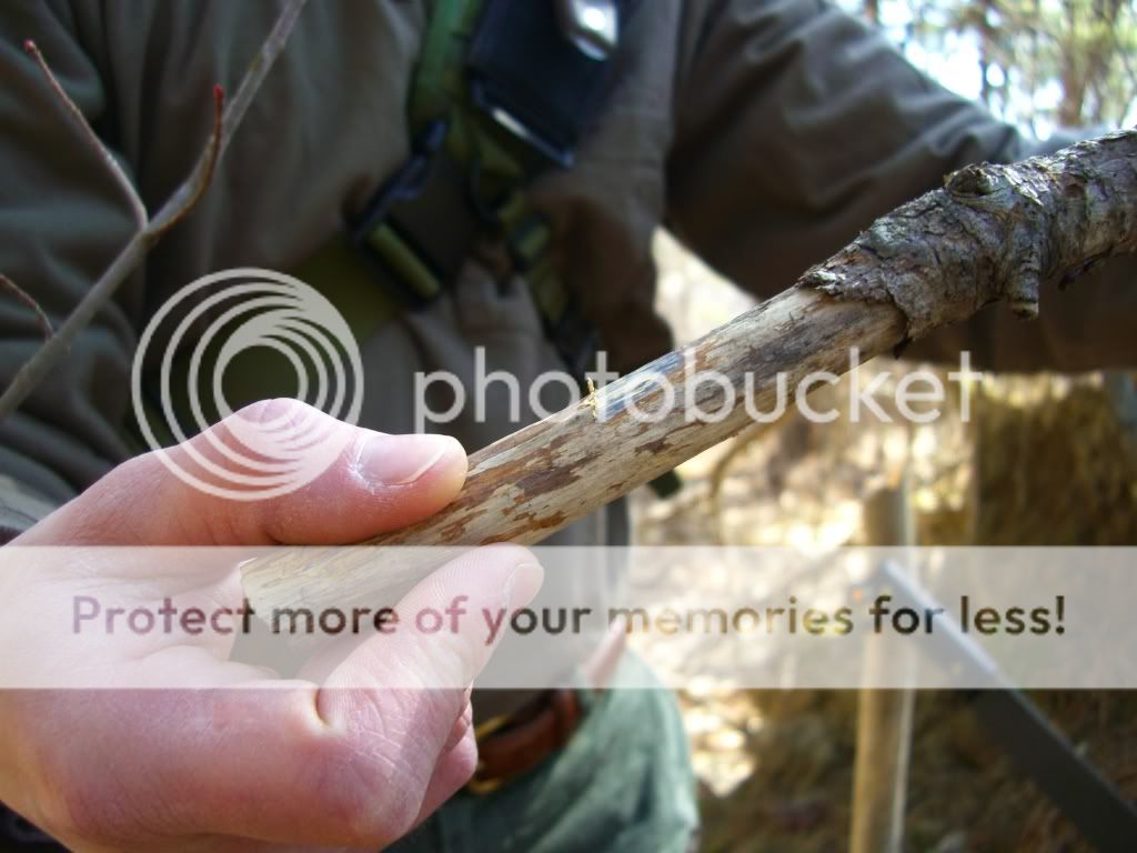

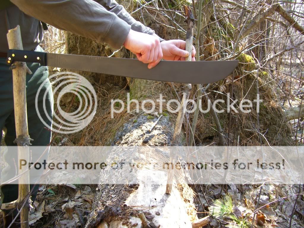

I started with the polished machete and a thin stick:

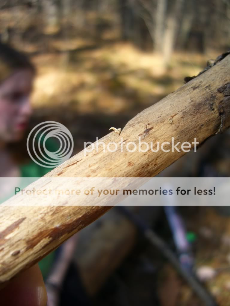

I had my lovely lady along to help take pics of the testing, so that's how I got these shots! She also let me know when I had the blade lifted to level so each drop had the same amount of "oomph."
And the depth of the cut after the machete was dropped:
I did the next test consecutively with this machete before switching to the coated one to keep things consistent, but for ease of reading I'll skip to the first test with the coated machete.

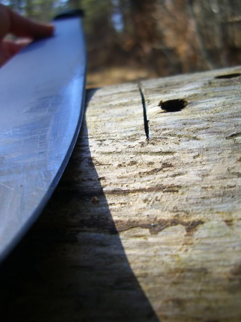

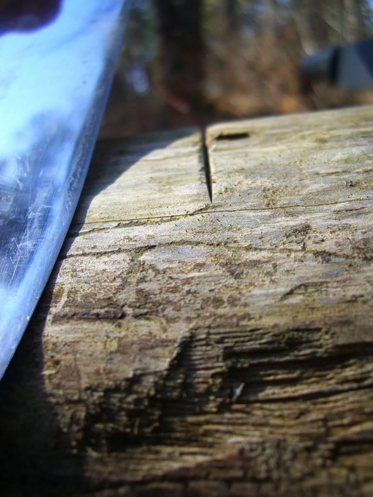

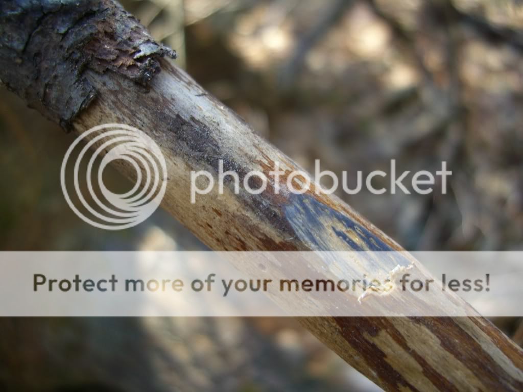

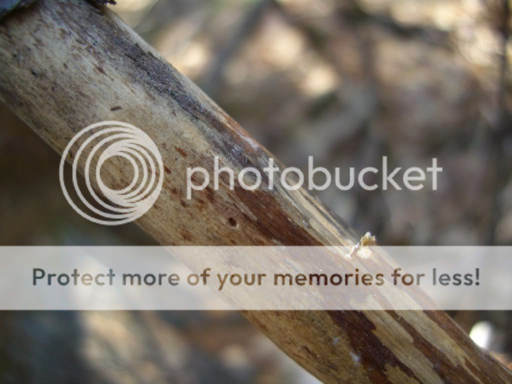

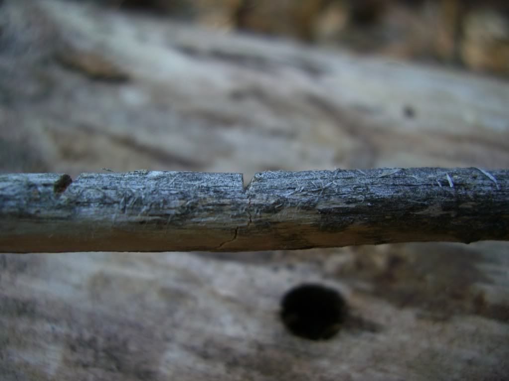

And here are the results side by side. The cut with the polished machete is on the right and the coated one on the left.
Close up of the polished machete cut:
Close up of the coated machete cut:
In this test it would appear that the coated machete cut deeper. Bear in mind, of course, that this is just a single test and would have to be repeated many times on uniform material to be considered "scientific." It's a lot better than just chopping some stuff and saying "I think this one worked better" though. There is a hairline crack under the cut from the polished machete, and the force of the drop may have been somewhat absorbed by the break. :)

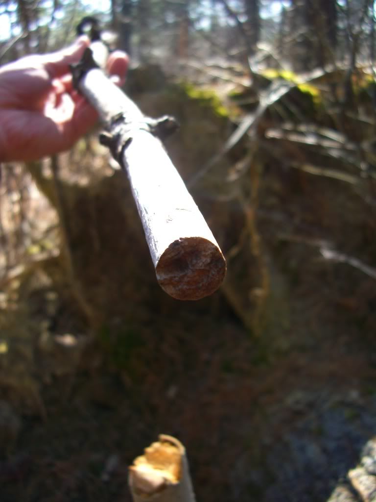

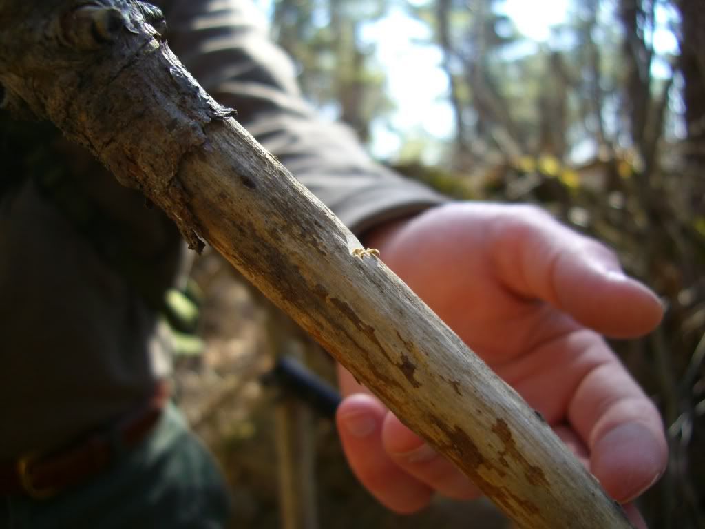

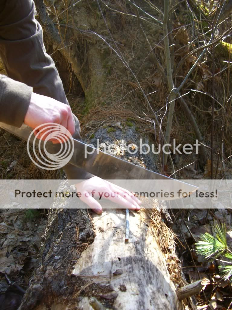

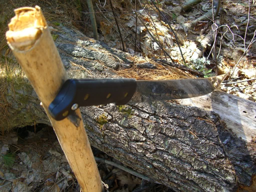

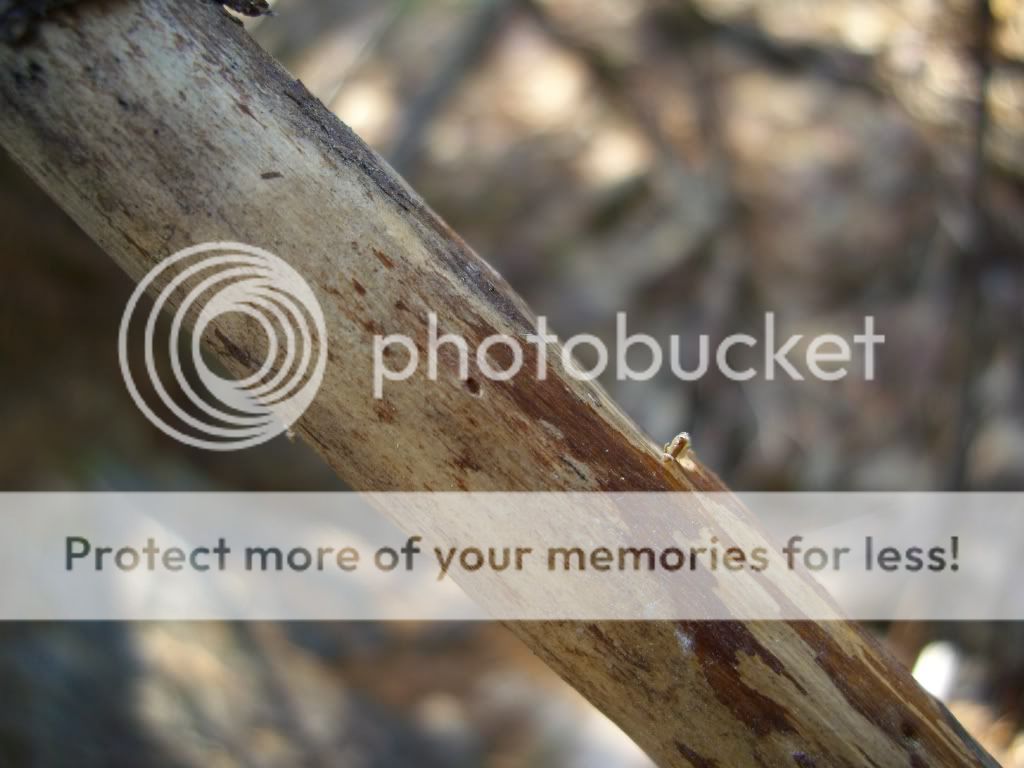

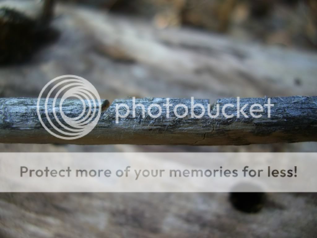

On to the next test--a drop onto a stick angled at 45 degrees.
With the polished machete:
The cut:
On to the coated machete...
The cut:
Again it looks as though the coated machete cut deeper, cutting off a full sliver under its own weight, whereas the polished machete cut in part way and then stuck. Again, I'll let you draw your own conclusion with regards to the scientific validity (or lack thereof) of this test.

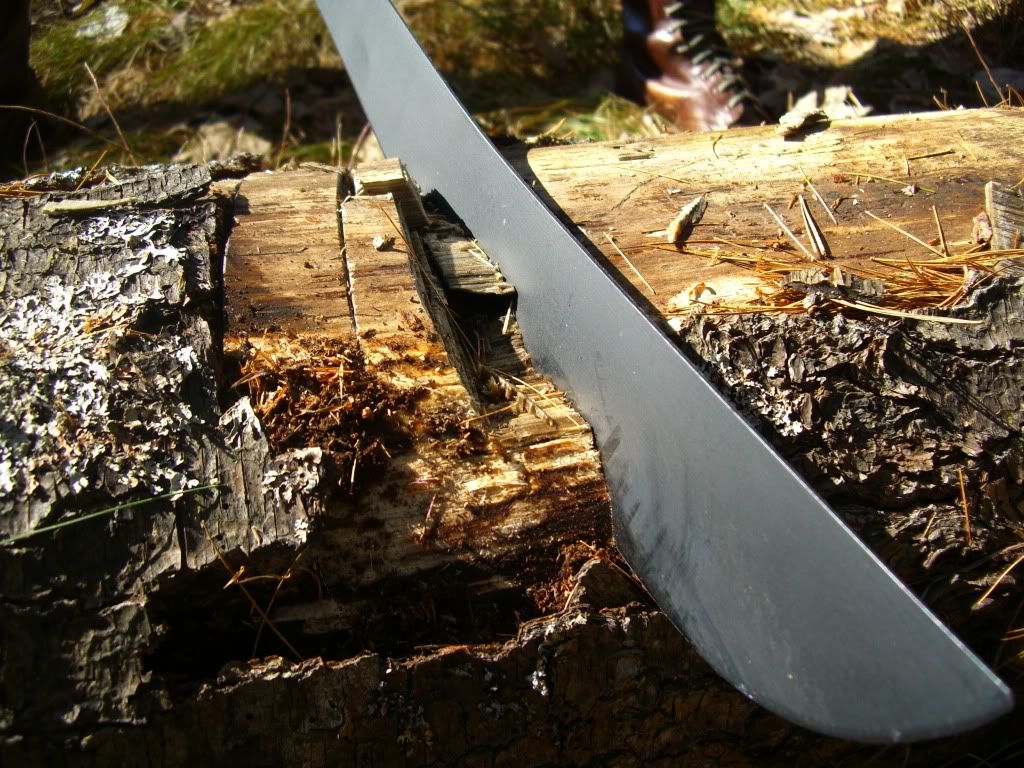

Then it was on to an actual chopping test--as unreliable as it might be, it's just not a real machete test without one!

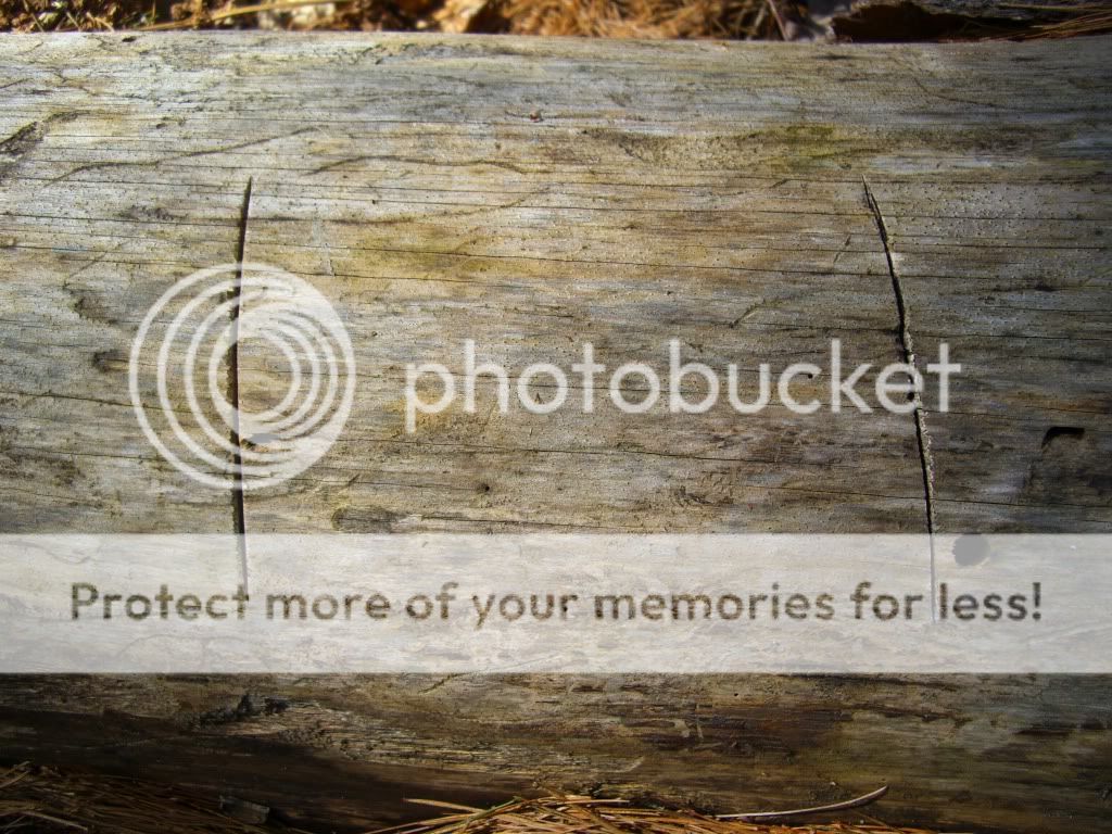

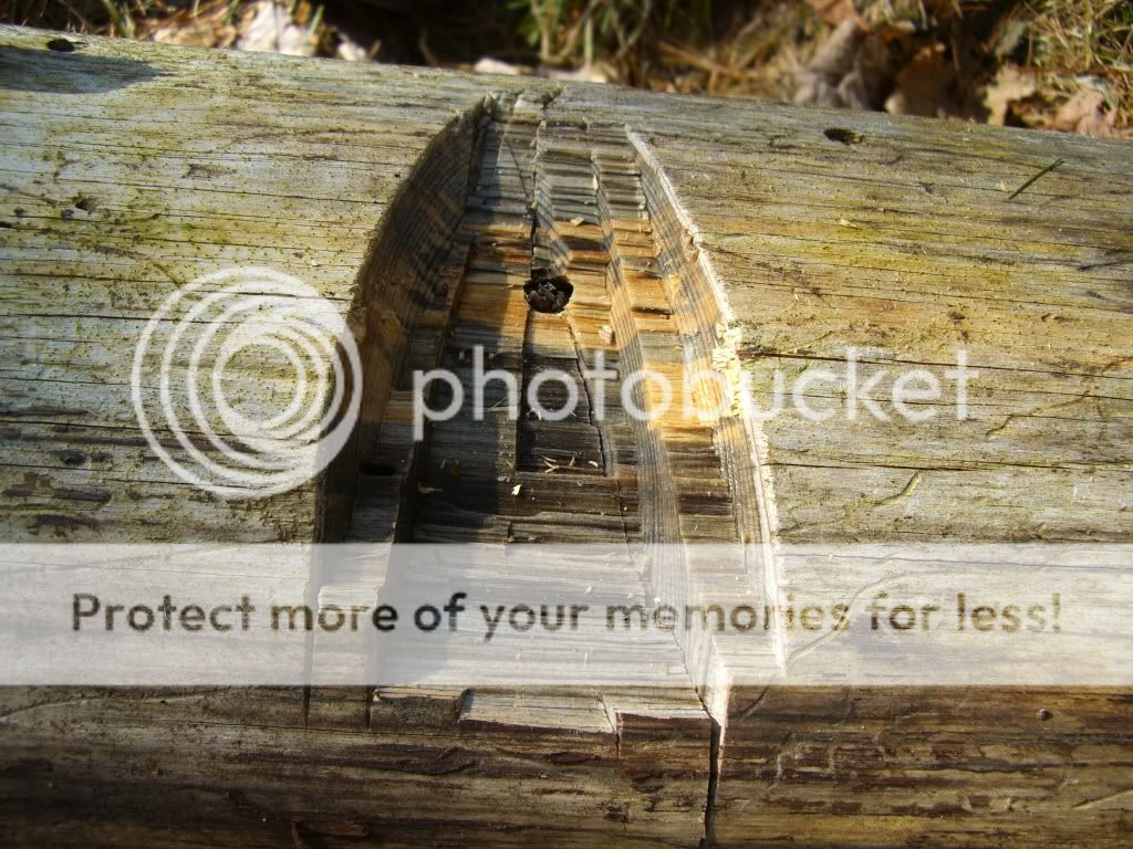

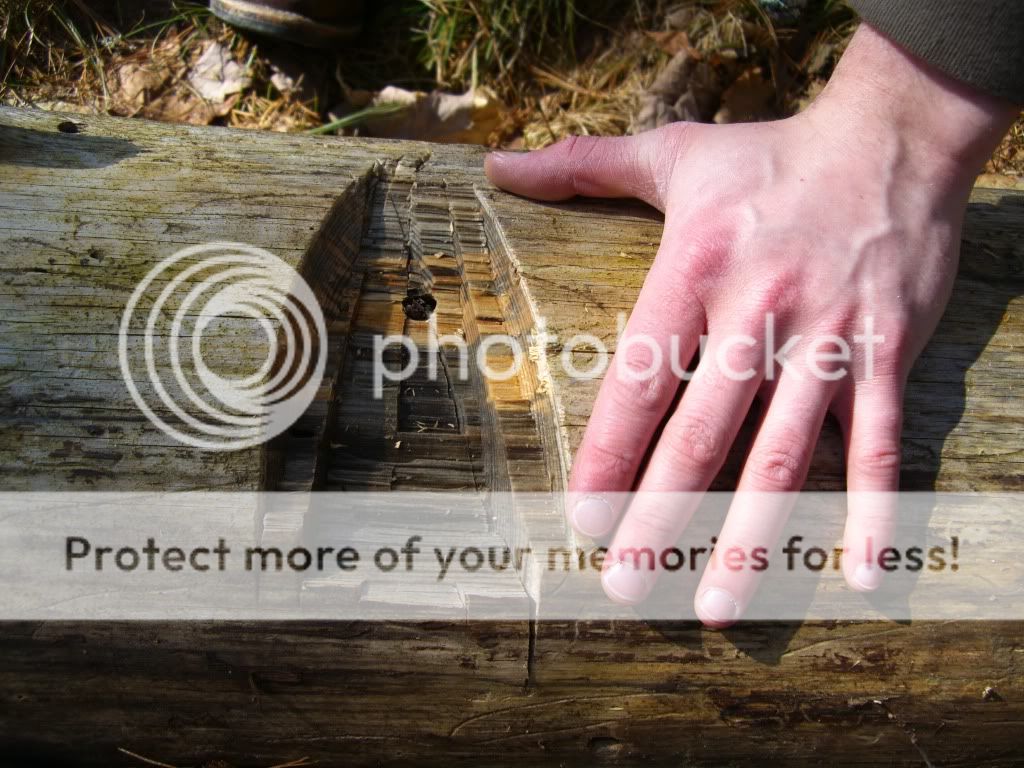

For the chopping test I first did a single straight-down chop with each machete with full force. Check out the polished machete--it looks transparent! :eek:
The polished machete cut:
The coated machete cut:
The cuts side-by-side. Polished blade on the left, coated on the right. Sorry for the twisted angle of the shot!

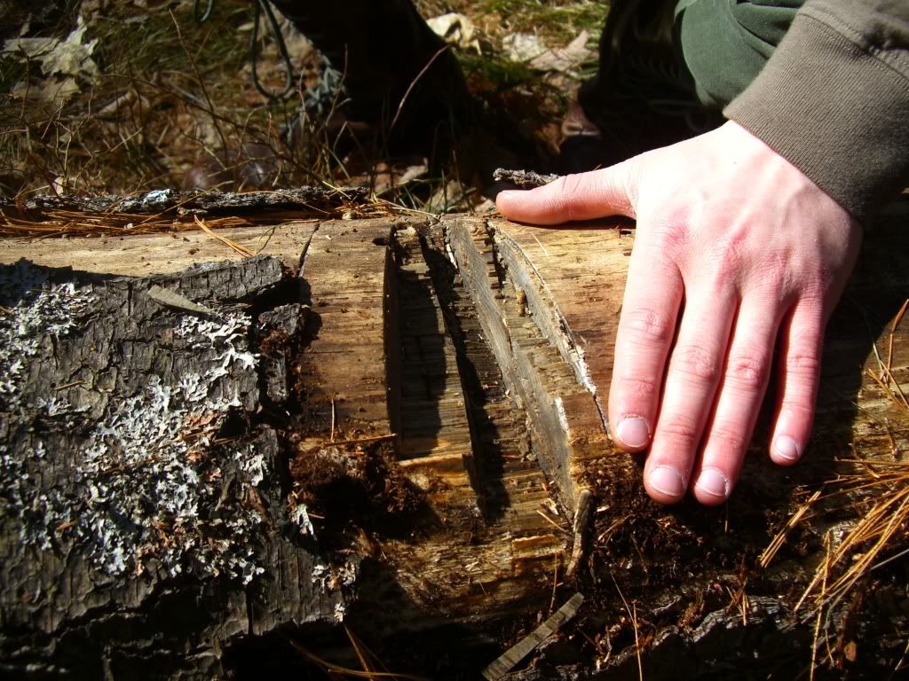

I then did ten chops with each machete, trying to remove as much material as I could. This test is purely for fun, since performance relied on my accuracy. I'll skip most of those pics though, since they're of dubious value. I'll cut to the chase and show the ones from the end of each session.
Polished machete:
Fortytwoblades
My accuracy was pretty decent here and I got excellent results.
The coated machete:
My accuracy here really blew chunks. :p I placed all of my blows in pretty much the right spot, but they were all nearly vertical so it didn't clear too much material. Actual performance was very similar to that of the polished machete, but with greater ease of withdrawal during the initial cuts where the blade sunk deep and stuck.

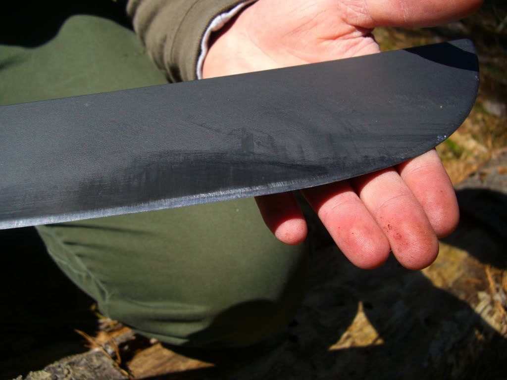

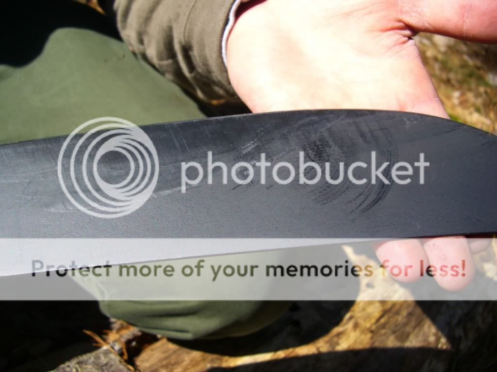

Here's the condition of the coated blade after a crap ton of chopping to try to beat it up a bit. (probably about 150 hard blows--that was tiring! :eek:)
While I was doing my silly chopping thing my lady kept busy playing around with her Izula.
All told I personally feel that the coating does a very fine job, functioning at least equal to or slightly better than that of a mirror polished blade. However it has the downsides of being marking (leaves a light black mark on the cut surface due to the graphite in the coating that acts as the friction reducer) and has the obvious predisposition towards wear that most coatings do. However it held up remarkably well. I'll probably use this on all those machetes of mine that I plan to never use for food prep or making cosmetic cuts (trimming prominently visible trees etc).
