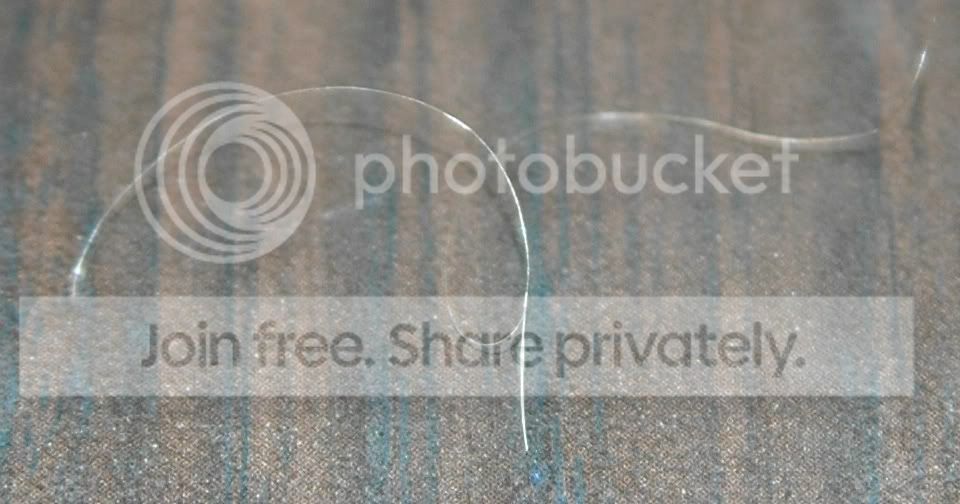

How about using just one hair and shaving a little piece off? :D (Yep, that is my cheap CRKT Prowler!)

i wil admit shaving hair into two or mroe pieces impresses the hell outta me......
