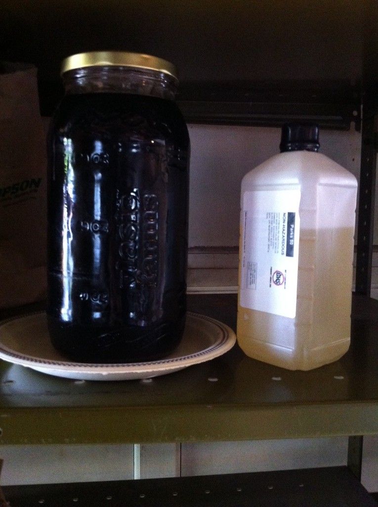

My first photo shows Houghto-Quench® K beside Parks 50 and I find it surprising that two oils that are supposed to have the same quenching characteristics look so different. Im not using Houghto-Quench® K in this test but I thought someone may find that interesting so I included a photo.

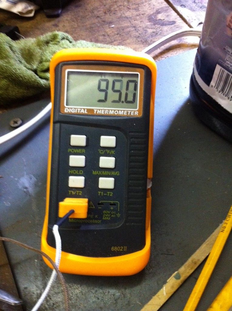

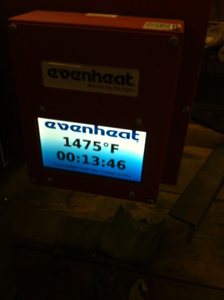

The next two photos show I heated to 1475 Fahrenheit and then soaked the two pieces for 10 minutes and they were in the oven during ramp-up in the next photo shows the temperature of the quenchant.

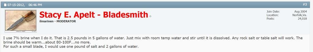

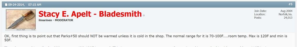

I use 95°F because of these recommendations by Stacy. I actually tried to use 90F but the temp crept up on me but I don't see it making a difference.

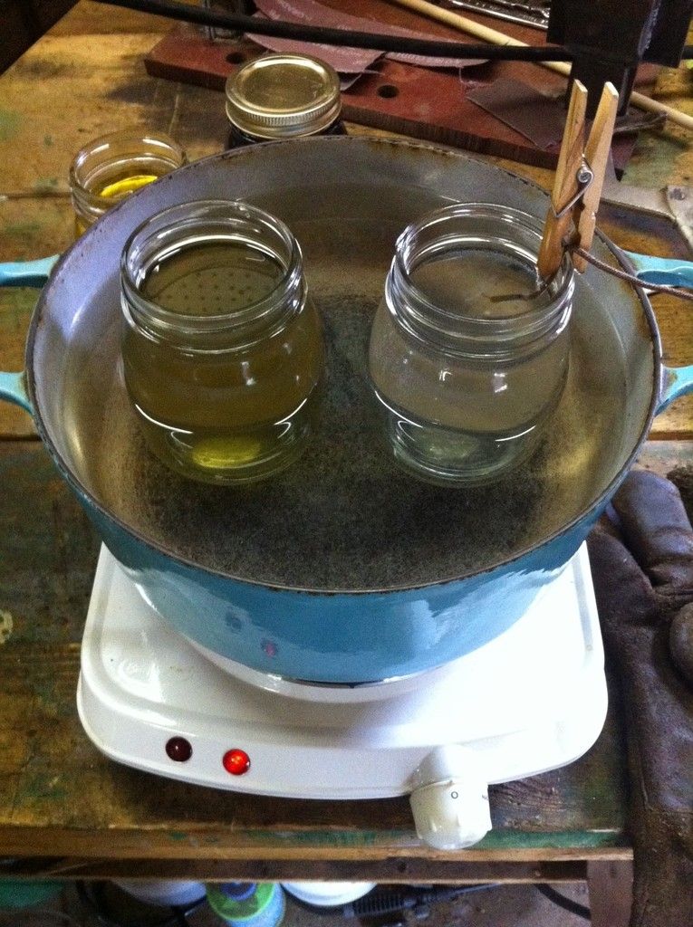

Here are the containers being heated holding Parks 50 and Brine. This was pretty much all the Parks 50 I was sent so this is the volume that had to be used. I also did agitate both samples.

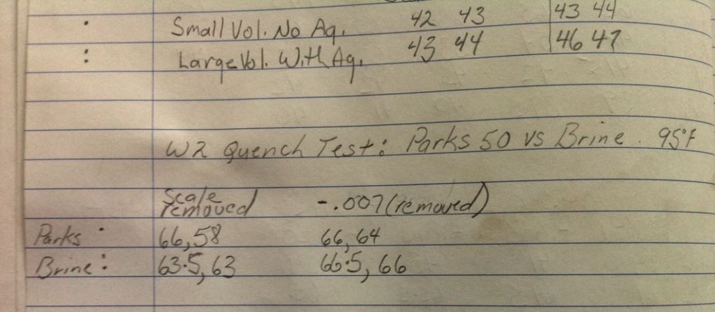

And here are the results:
Being told my conclusions previously are overreaching I will be cautious to only state what is strictly proven here. It looks to me like Parks 50 hardens this piece of W-2 almost as well as Brine and if you look at the numbers at the top of my test results those are the old figures for W-2 in Houghto-Quench® K which are below 50. I was actually surprised that agitating the Brine quench didn't give a higher hardness but instead is pretty close to the value when tested without agitation.
Personally if I were hardening W-2 or even 1095 I would use Parks 50 and wouldnt go near Houghto-Quench® K. Although Houghto-Quench® K hardened 1095 to 66 in one of my tests it did have a soft spot in the center and the fact it wont do W-2 (or at least the piece I have) I would feel much safer with Parks for both these steels. I mean why take a chance when you know one will definitely do the job and the other seems iffy on one and terrible on the other? I dont expect others to agree with my conclusions but use the evidence for your own.
