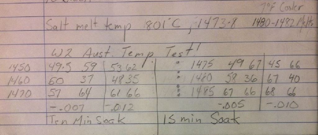

I did some tests today to determine the best aust. temp for my oven with W2 and once again I got some perplexing unexpected results. I have been doing my tests at 1475°F and it has been suggested by many that I should lower my temperature to increase my hardness. I expected hardness to increase as I lowered the temp and the maximum would be in the 1450°F range as that is where Don Hansen III has found the sweet spot.
Before I started my tests I did the salt melt test to determine how accurate my thermocouple is. Salt melts at 801°C or 1473.8°F and in my melt test according to my readout on my oven the salt melted at between 1480°F and 1482°F so I figure my oven reads approximately 7°F hotter than it actually is so that should be subtracted from all my readings. Here are my results.
Obviously contrary to my expectations hardness increased as my temperature increased maxing out at 68 at my maximum temperature of 1485°F which in reality is probably closer to 1478°F. I am not presenting this test as solid proof of anything because there were a couple of variables that may have influenced things.

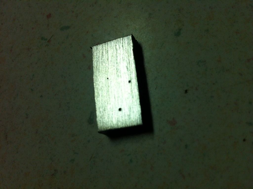

First off I have learned that I should not put my samples in as I ramp up my oven as I have been doing so I soaked them for 10 minutes in the first half of my tests and 15 in the last because I thought perhaps 10 wasn’t enough because of my low readings in the range that I thought would give my highest readings so that is one strike against this test.

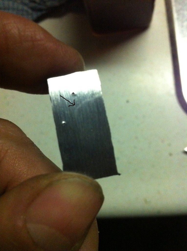

Also some pieces had very large variations of hardness in specific the 1480°F test where the hardness varied from 67 to 40 on the same piece. I didn’t coat these pieces with any anti-scale and I noticed the scale was falling off some places on some pieces and not others and I think that may explain the variations. I think I will coat my future test pieces in a thin coating of furnace cement recommended by Stacy. These are some photos of that piece where in one you can see the different sizes of the test divots clearly and in the other I have an arrow pointing to the delineation line from grinding between the hard and soft areas.
But if I ignore the variations and just use the hardest spots on each sample my tests are telling me that my sweet spot for maximum hardness is in the 1485°F range or with temperature correction of my oven approximately 1478°F which is quite surprising because most people are saying the maximum hardness sweet spot is in the 1450°F to 1460°F.
I don’t claim that this test is definitive in any way and has the deficiencies I outlined but it does tell me I need to do more testing in this area but does suggest that my sweet spot is much higher than what other people find and I wonder if people may have any conjecture about this discrepancy?
Interesting results. Hardenability is affected by the obvious chemistry, but less obviously the condition of the steel will also affect hardenability. The finer the grain refinement, the lower the hardenability. Something interesting/odd is happening with your steel. It migh be worth contacting Kevin Cashen and asking him his thoughts.
Yes Willie my results are interesting/odd but before I bother Kevin Cashen I would really like to clean up my test methods and have more definitive results meaning I would like to try to get my hardnesses more consistent on my test pieces using a skim coat of furnace cement as an anti-scale and see if that helps and use consistent soak times on all my pieces so obviously I need to do some retesting first.
But it also crossed my mind overnight that perhaps the salt melt test is simply not that accurate because maybe salt melt point varies with quality and impurities and only pure salt melts at the prescribed point? Perhaps my oven is just out about 20°F and when I think I’m in the 1480°F range I am really only around 1450F to 1460°F where people say the sweet spot is.
I have been reading about ways to calibrate a kiln and apparently there are small cones that come in kits that melt at different temperatures and there is a place not far from me who sells them so maybe I will order some when I get a chance. I am busy working so I probably won’t get around to this for a week or two but then I will at least have a starting point.
I could just use the higher temperature to get my maximum hardness but from what I have read higher aust. temperatures create dreaded grain growth so I would really like to know how hot my oven really is before I start using that temperature.
And as you say grain refinement may be an issue but I did do a test earlier with this W2 going through normalizing cycles and it didn’t make any difference in hardness. I’m not saying that might not be an issue I just don’t think it is but before I get into that I think it’s more prudent to try to figure out how hot my oven really is because that might be the simple solution.

Even though this test seems like kind of a failure because the temperature I expected to be the sweet spot is 20 to 30°F off I am actually encouraged by the fact that I was able to attain a hardness of 68 because that is pretty much the maximum people are getting.
So if the problem ends up being just that my oven isn’t calibrated properly I will be off to the races and ready to start making knives with maximum hardness with W-2 and Parks 50. I will tweak things down the road like soak time but at least I should be able get back to knife making soon if that is my issue.
Actually I guess using the cones used to calibrate kilns won’t really work for my purpose because they rely not only on temperature but time and temperature so it is hard to actually pinpoint the temperature with them as I found out from more reading.
But I did find a thread by Stacy on how to calibrate an oven using temp sticks that are used in welding etc. Hopefully I should be able to pick some up at work to help solve my issue or as a worst-case scenario I may have to actually buy some, LOL. In that thread someone said table salt can be up to 5% additives so that may be why my melt test shows I am only out by 7 degrees F when it seems like I am really out by 20 to 30 degrees from my test results.
This really drives home the point of testing yourself, in your shop, your equipment. With W2, +/- 10f names a difference, and you go be a sweet spot 30f out from myself and Don. (He's using 1460 now Iirc. ) With these steels, just following a recipe won't cut it. In the end, the reading on the kiln is irrelevant. The final condition of the steel is what's important. Use what your testing says is best.
