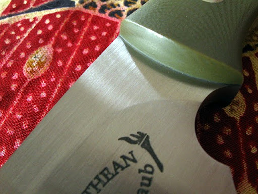

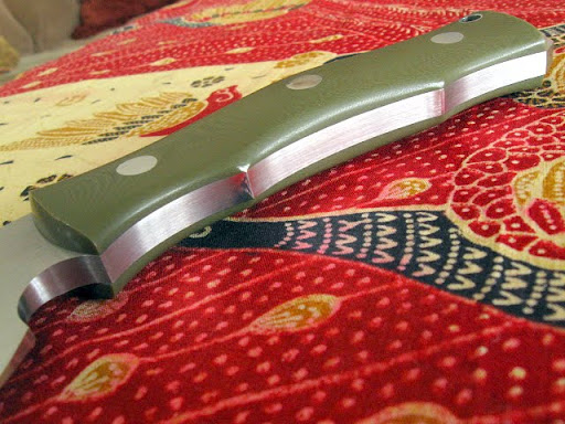

I picked up a tip on finishing guard/blade joints from Charles on a thread here. He uses a knife edge cratex wheel held in visegrips (not spinning, not powered) to gently clean/polish when finishing a solder joint on knives.

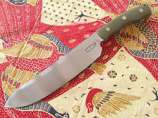

I was working on this knife today, not actually one with a guard, but epoxied scales up front. It's ticklish sometimes to get this area real tidy, I wipe hard with an acetone q tip after gluing, then clean all around the area as well. Still, sometimes you get a thin epoxy wash on the ricasso or annoying grittiness/specks of whatever right on the glue joint.
I used to clean this up with sandpaper wrapped around a knife-edge piece of phenolic, or around a razor blade. You have to be very careful and meticulous for this to work cleanly w/o any j-hooks. Buffing screws up the look, and cratex on a dremel or whatever tends to be too aggressive for this.
So I tried the cratex trick today, with an x-fine wheel just by hand. It works great, quick and easy and the grit is so fine it does not leave any marks of its own if used gently. Thanks Mr. Vestal, you've saved me some time.
I love this place, I'm a much better maker now than I would otherwise be, thanks to the generosity of great knifemakers in shoptalk.
Here's a couple pics of the knife, and glue joints.

BTW-Great looking knife.
