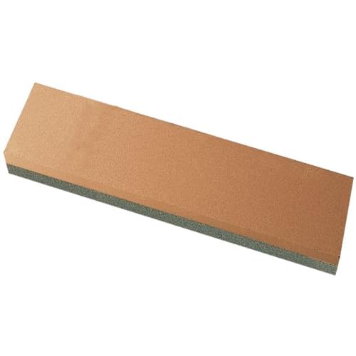

Ordered one of the 1" x 2" x 8" coarse/fine Norton India stones today. This one...
From the Manufacturer
IB8 Combination India bench oilstones have 2-Grit on opposite sides of each stone, reducing the cost of owning a variety of grit sizes for sharpening. Coarse India at on one side is a medium cutting rate man-made sharpening stone for fine edges. Use to sharpen dull edges quickly. Fine India is used to provide a fine edge. Use to restore slightly dulled cutting edges and enhance the finish left by medium and coarse crystolonat or and India at stones. Norton India oilstones are manufactured using a proprietary process that impregnates them with a petroleum based product that allows the lubrication used during the sharpening process to stay on the stone's surface. As a result, the metal from the object being sharpened and small pieces of abrasive that break off the stone become suspended in the lubricant. This prevents these materials from imbedding into the sharpening stone's surface, keeping it free cutting and making it easy to keep its surface clean.
Funny, I "ordered" one from our tool crib recently. Of course I keep it at work.
I never would have thought about wd-40 on the stone, but it makes a huge difference!
I have a 9" india, that I put in a bucket of mineral oil, and let it soak. Man, that thing will throw an edge on a knife, damn.

Dang, I overpaid a bit. I just got my SMKW catalog and saw how cheap they had 'em.
Well, with TN sales tax plus SMKW shipping, mine wasn't that much more.
It came yesterday, and I put a kickass edge on one of our chef's knives.

Well, I have one of the 11.5" two-sided Norton stones but mine is still plenty orange on the top because I tend to take a diamond stone to it to make sure it's flat and clean. (I'll be stopping that nonsense now.) :)
I picked up some Simple Green over the weekend and went to work on a few knives and it definitely works wonders and leaves a nice toothy edge.
