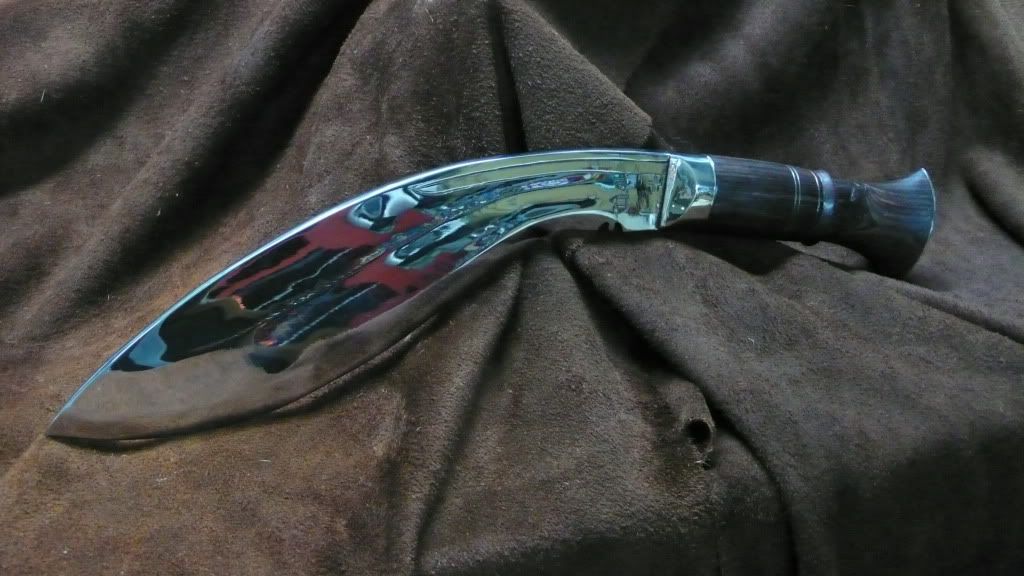

First a Foxy Follie that has a great dark piece of wood
This think is stout and with the relatively short for width wide Blade this thig would be like hitting someone with a boat prop.
I think this blade in some custom high ride leather would be a real powerhouse for a Khukuri this size.

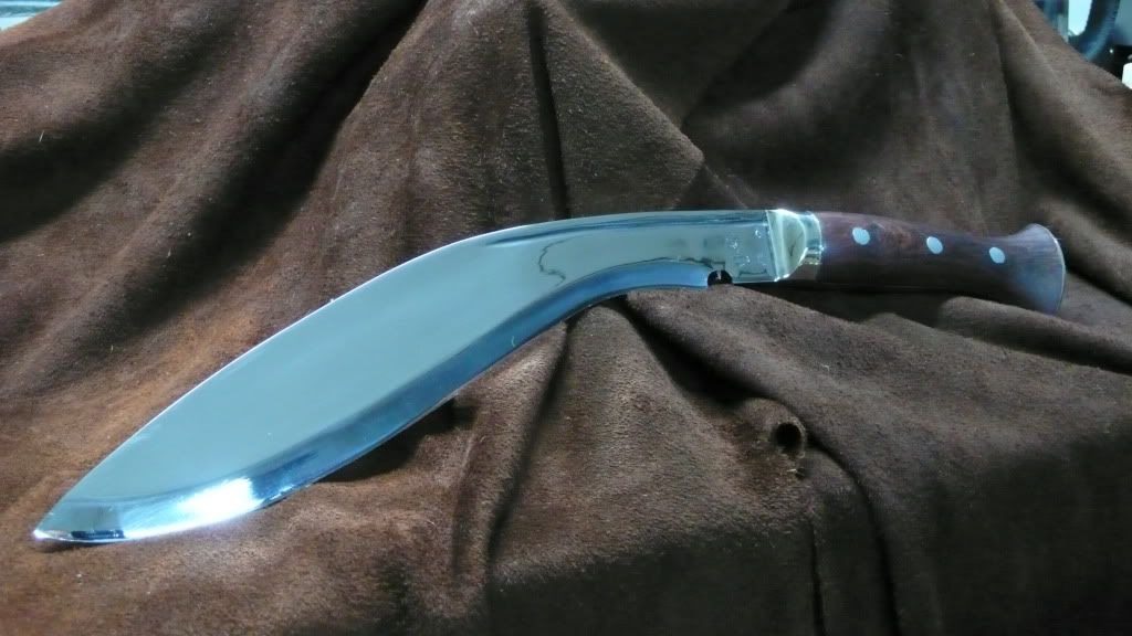

The second blade from Yangdu is this most excellent M 43.
I really like this blade and again with some time on the wheel this thing glows with a great piece of dark wood with some nive dark character to it.
Again real nice Blade that would make a great tool and one hell of a weapon . I believe real classic Khukuri

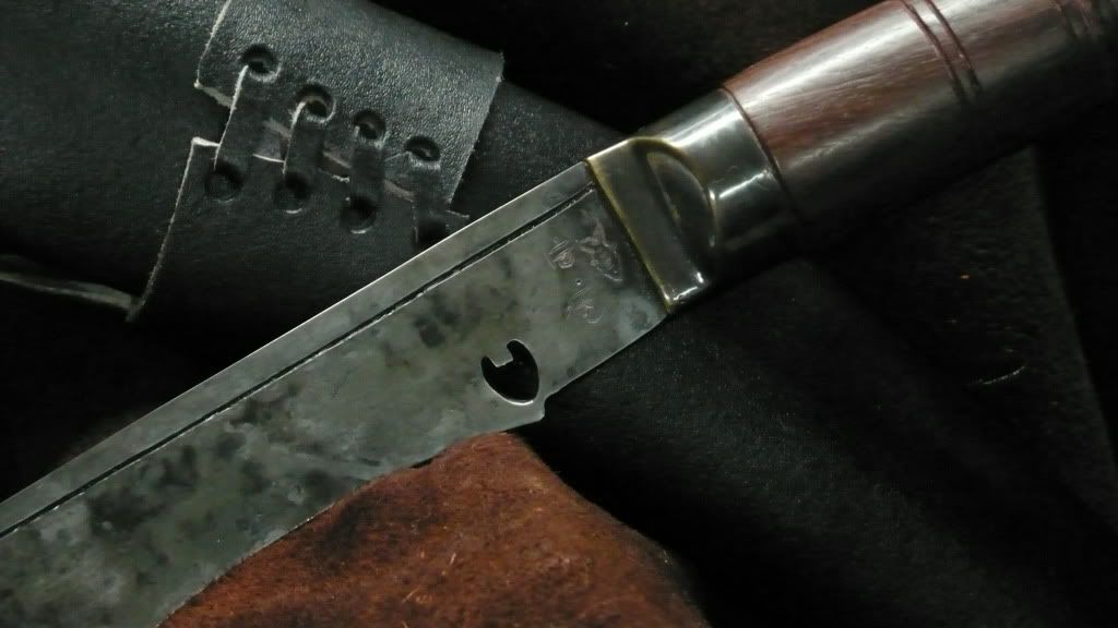

last but not least I got this one off a fellow forum member for a real fair price.
It is a 20 inch Gelbu Special that had Brass fittings and was in great shape
I wanted a little project blade so the first thing I did was antique the Brass by Blackening it.
The next thing I did I learned from my Buddy Jason Knight the Master Smith
he does this treatment on some of his combat snd hard use blades.
It gives the blade a dark ancient look that prevents rust and is super easy to touch up.
Jason describes it as the blade looks like it is under water. I think it just looks ancient and mean with the blackened fittings and antiqued blade.
By the way of the Khuk's I have handled so far the Gelbo would be my choice to take to a fight

Warty it is very easy
First I stripped all oil from blade and fittings
Then I masked blade and handle and sheath
Then I used Brass Black applied in several applications on the Brass fittings to give them that ancient bronze look
waxed fittings to seal
Then masked habaki like fitting on blade made sure blade was again oil free.
Run heat gun over blade get real warm
use a q tip to dab on cold blue making lots of dots not lines.
keep dabbing on till you habe achieved full coverage
let dry
flip blade over hit with heat gun and do dabbing on process again
switch q tip fairly often
let dry
check both sides and spine for full coverage
touch up as needed
let dry
spray oil on blade wd 40 works but I prefer a thick oil like mineral oil
take oooo steel wool rub blade out
leaves a dappled grey blue black blade with a rich luster
fights rust and is super easy to touch up
plus it looks ancient
