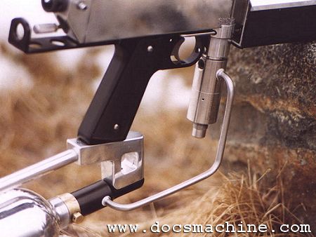

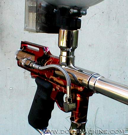

-I made this pressure line using stainless instrument tubing (probably 316) with threaded collars (304) soldered to each end with off-the-shelf 60/40 lead/tin plumber's solder. The flux was a liquid, meant for silver soldering.
The vertical feed neck collar on this marker was soldered to the body of the gun (both 304) with what I originally thought was silver-bearing solder, but which turned out to be some flavor of conventional lead/tin as well. Same liquid flux.
I have stacks of other examples. I've been soldering stainless components with "plumbers" solder for fifteen years. :D
