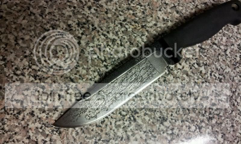

check out clich's technique of using gun blue and bleach in the becker forum. I've done it with a couple of knives and while it's not exactly a forged scale it imitates it pretty good
you can also sand away and leave the "scars"
or you can blue again after the process is done so the pitted area remains dark, can do the flats only by taping off the grinds.
