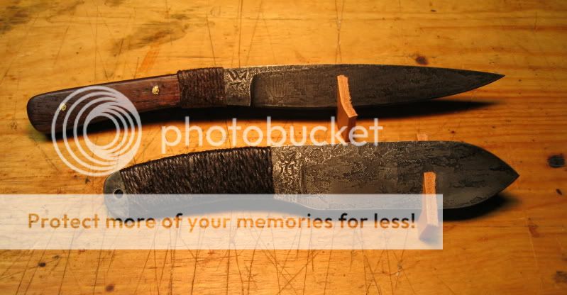

I have recently switch from jute wrap to hemp.
The hemp seems to soak up the epoxy really well. After it dries, it is basically hemp micarta! I really like the wraps for a couple of reasons. First off it looks COOL... and second it really works well in the hand. I like my handles slim... something you can fit your hand around completely. Most kitchen knives are made with small diameter handles and I've always felt comfortable using them so why not? I need it to work in different grips as well (forehand, backhand, reverse, etc...) which is why many of them are symmetrical.
What characteristics do you look for in handles? Do you like finger notches, palm swells, rubber, etc.....
Get a grip, will ya!
Rick
Looks great!
Personally, I like a larger more ergonomic handle on what would be considered a "chopping" knife (like a BK9), but prefer a slimmer handle without much features on just about everything else.
Ive used man knives and tools and must say that my favorite grip with a long lasting handle is my bravo 1. I can carve for hours with it and have yet to get hot spots. It must just be perfect for me. I guess the palm sweel with the curvature has a real nice ergonomic feel:)
Handles are just so individualistic. I can't even say that I have any rules for myself. I have some knives with fat handles that seem to work and I have others with slim handles that I like just as much. I've had knives with handles, but fat and thin that just didn't really work for me. The only think I do really avoid is overly aggressive contouring. This seems to be going away but last year it seemed that swells in the handles were getting more and more aggressive. I've never had an aggressive contoured handle feel good to me.
Another thing that I like more and more, at least on larger knives, is the drop down edge that forms part of the knife guard. I know this isn't part of the handle, but that drop down edge changes the needs of a handle e.g. removes the need for an index finger notch or integrated guard. I tend to prefer these knives at the moment, but also recognize that they only tend to work with 5" plus blades.
