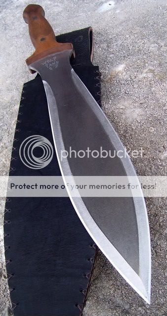

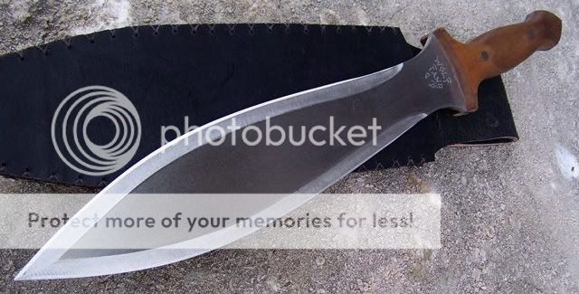

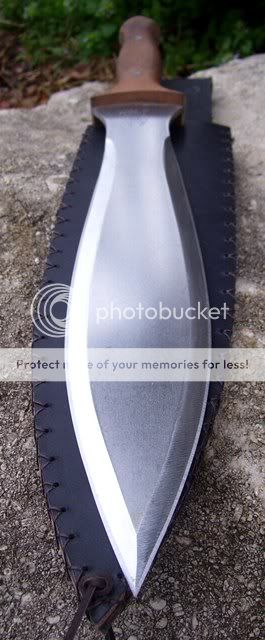

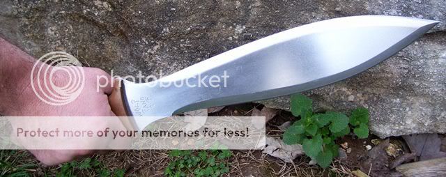

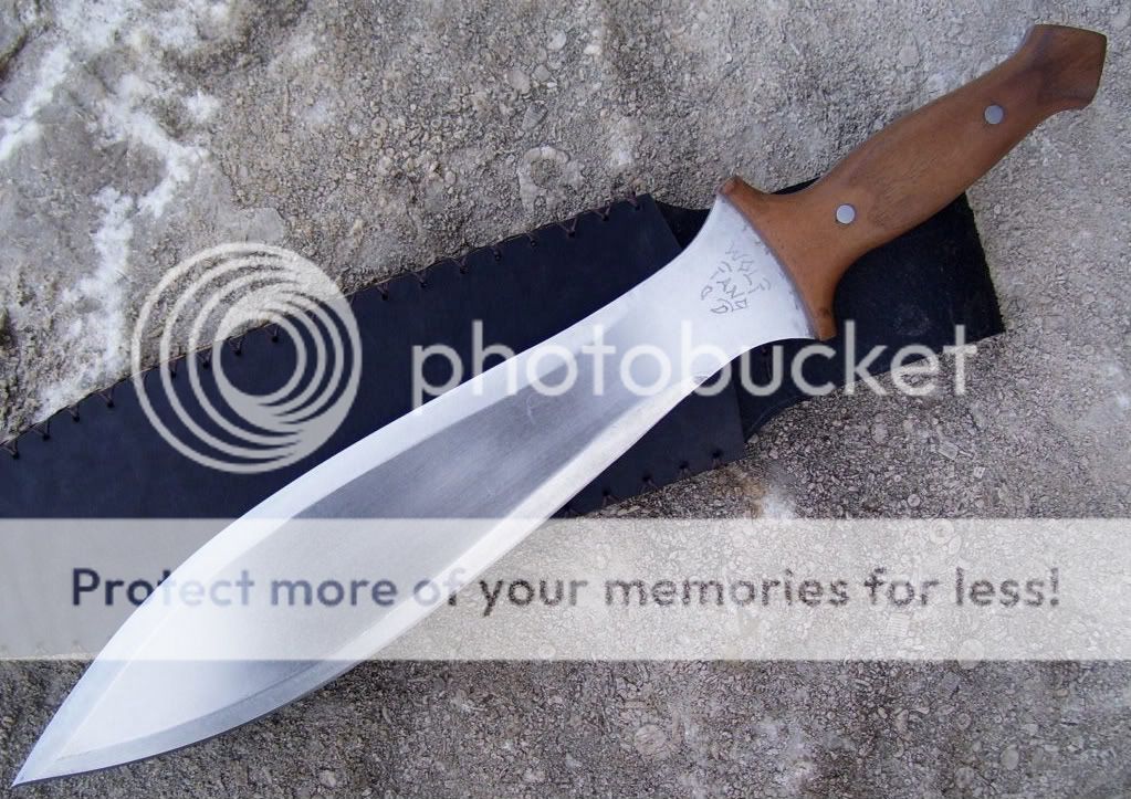

Hi guys. Finished this custom piece up for a customer this week. It’s a larger version of my Smatchet Short Sword. We will be adding this one to the web site soon and a video demoing it.
The “Wolf Fang Smatchet – Fully Functional
Shop Details:
High Quality 1095 Spring Steel. Our Heat Treatment is a 2 step process. We Heat Harden our steel, which involves heating the steel to approximately 1500 degrees, until it becomes non magnetic then quenching it in oil. The 2nd step is Heat Tempering, which consists of heating the steel to 400 degrees for 2 hours, and letting it air cool. This makes for a Rockwell Hardness of approximately 61.

Measurements
Total Length = 19 “
Blade Length = 13 ½ “
Blade Width = 2 5/8”
Blade Thickness = 3/16 “
Handle Length = 5 ½ ”
Handle Width = 1 ¼ ” x 7/8”
Handle: Walnut. Scales attached with pins and glued.
Weight: 1 lbs 8 oz

Thank you. You are correct. Wasn't watching my typing when I was posting. I've corrected.
The quote, "Wolf Fang" on the smatchet was the customer's request. Not sure where he got the quote, but is nickname is Wolf, so I'm pretty sure that had something to do with it.
Here are the dimensions for my original Smatchet:
Total Length = 16" Blade Length = 10 "
Blade Width = 2 7/8 " Blade Thickness = 3/16 "
Handle Length = 6 " Handle Width = 1 ¼ " x 7/8 "
Mainly the blade has increased in length.
