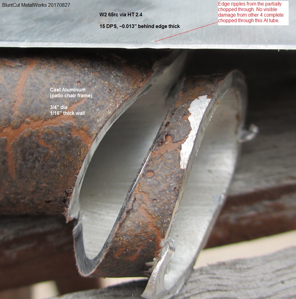

I take a little break - from making other knives - to test a W2 65rc chomper (15/18 dps/micro, 0.011-0.015" behind edge thick).
How is this rope cut? Edge is too thin for chopping through a 3/4" dia copper pipe, chopped rosewood instead.

You are right, dried bone is harsher on the edge because bone unpredictable path of fractures - more/less high impulse on short distance edge steering. Copper/Aluminum/frozen-meat/etc has uniform structure, hence could lead to longer distance edge steering (esp with flexible thin cross section), which could lead to half-moon chip. 3/4" dia copper pipe (3/32" wall) would be easier than 3/8" solid copper rod. Chop Rosewood is brutal on thin edge.
Luong, I would think that copper shouldn't be much worse on the edge than chopping bone?

I've a few savaged(for edge tests) Cast Aluminum tubes. Cast Al has similar hardness and tensile strength of Cu. So rather than waste good Cu tube, instead I did 5 chops at Al tube. The chop didn't go through all the way rippled the edge.
