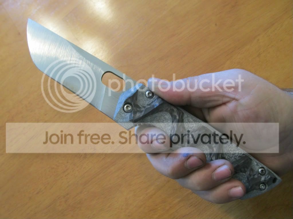

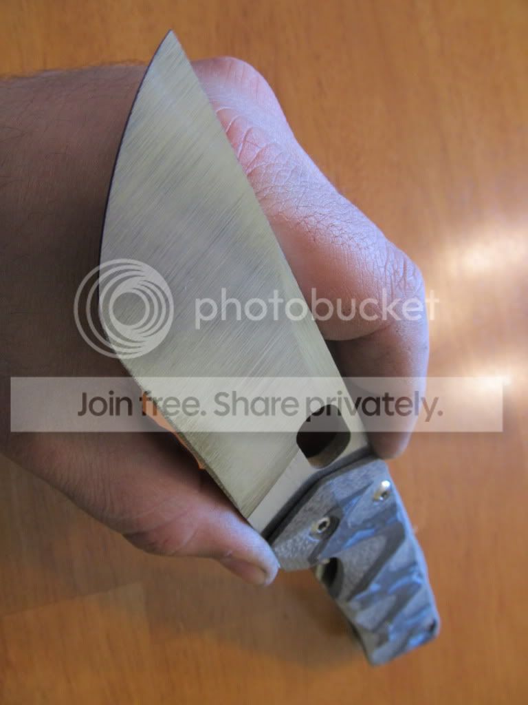

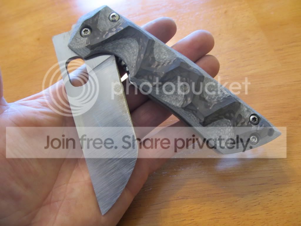

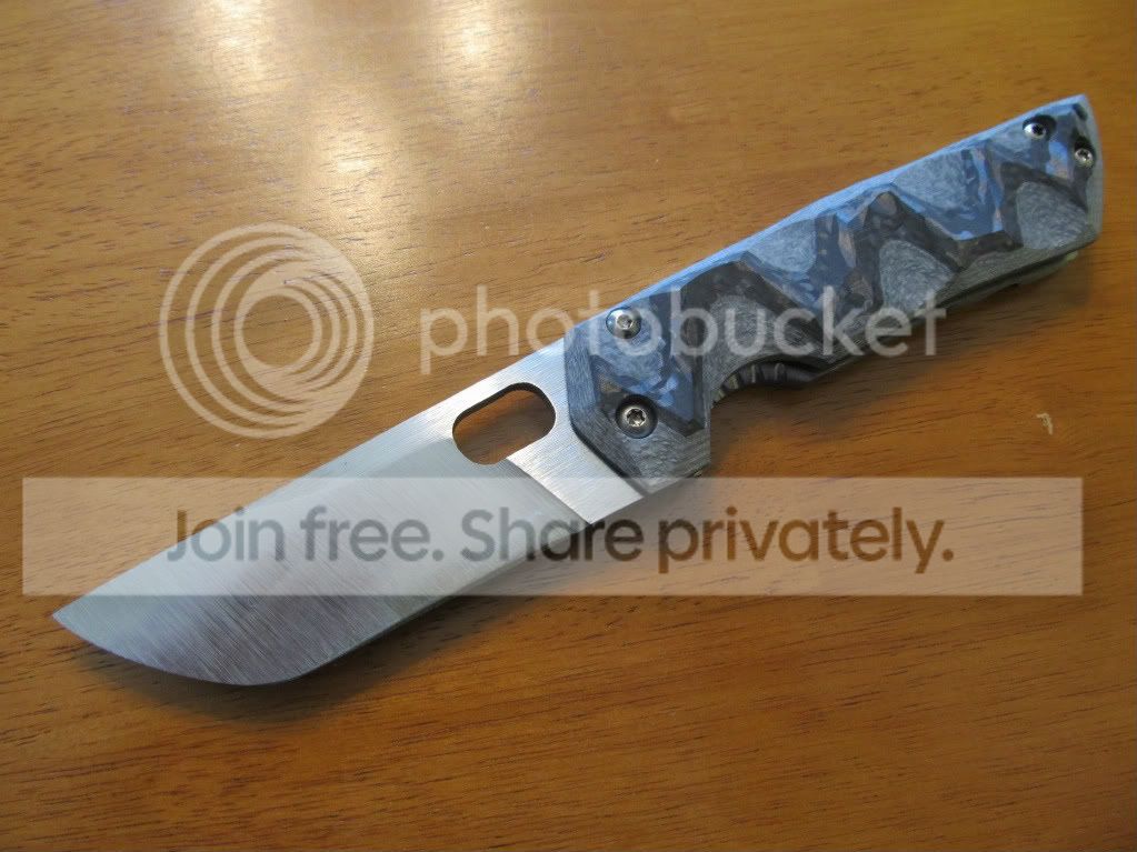

my latest design for a heavy duty no nonsense folder, the apex.
OAL 9.5 inches
4 inch 3/16ths s90v blade
.2 ti framelock construction
mamba scale
she is in the rough stages (so are most of my knives at the moment)
Sweet looking knife. :thumbup:
Only thing is if I could make one little recommendation. :eek:

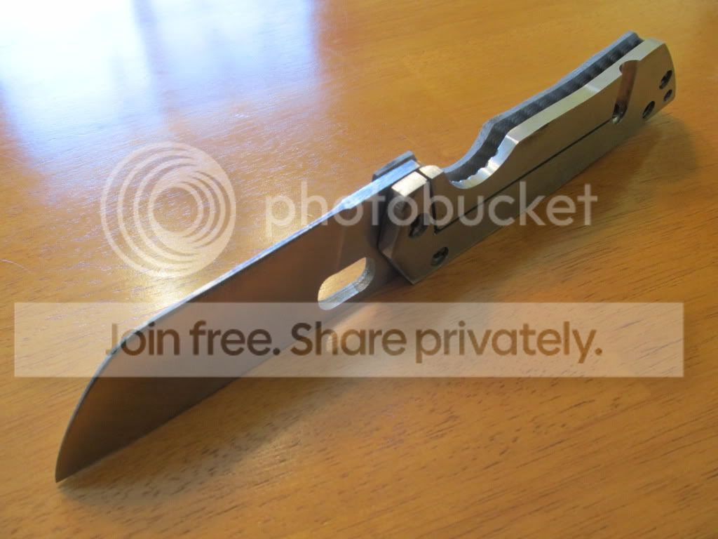

Make the transition smoother where the blade starts to curve up from the belly to the tip. Now it looks like it stops then starts again, could be just me or the way the photos are showing it.
Awesome progress, peter!
Good suggestion, Jim :)
It's the 1st thing that I noticed.... Thinking about cutting something and using the whole blade, I know I am weird....
Great looking knife though. :D
its in the rough stage. nothing is even close to done yet. it will transition better.
Looks real good, I like the blade shape and am a big fan of the hole for an opener.

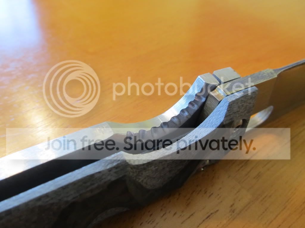

it looks pretty good right now lol, but i must say that lock bar is gigantic, i know its still being worked on but still wow

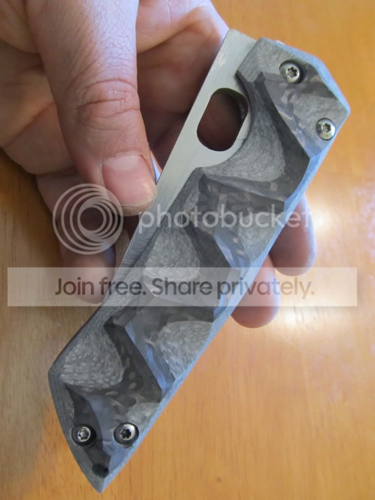

messaged you spartan. and fyi, the ti side will be sculpted and have the same footprint as the scale side.
Looks good, really like the handle. Can't wait to see it finished.
