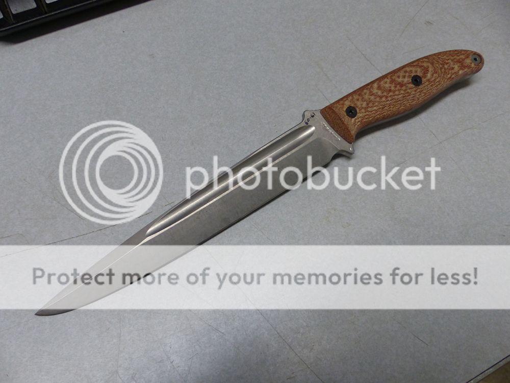

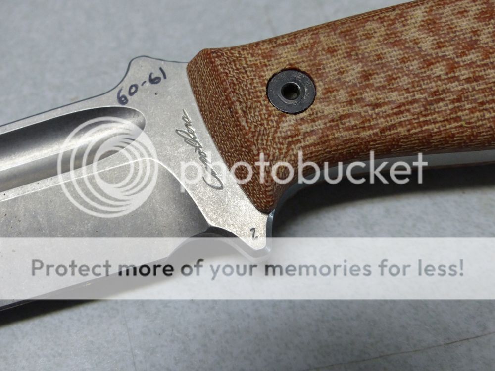

Nathan, would you consider Z-wear PM or Z-tuff PM for a future run of one of your blades? Zwear is said to be quite similar to 3v and we all know how awesome your D3V is! Z tuff I am not sure--supposedly it is like a PM version of a shock tool steel like S7. Would developing a "D Zwear" or "D Z tuff" be something you would be interested in working with?
I have several blades in Zwear PM, and *quite* a few more in 3v from different makers. From my limited perspective and qualitative observations, the two steels are similar. (holding an edge, taking impacts without chipping, both are easy to sharpen and maintain)
Not too many folks use Zwear/Ztuff and what a game changer it would be if CPK improved them remarkably like you did with "regular" 3v turning it into D3V!

I think it's a good product. It machines like a dream and is very nice to grind and process here and I feel it's a good material that makes a good knife and I did consider using it.

I'm not certain, but I don't think that Z tuff is a better material than 3V. It's actually impossible to really know without fully refining optimizing the heat treat, but I've tried it and decided it doesn't have the potential in a knife edge that you find in 3V. Compared to optimized 3V it is mushy and it rusts. When they're both given the data sheet HT they're both pretty good, but not great as a knife. It has nickel in it that improves toughness in thick sections but has a nasty tendency to stabilized retained austenite which reduces edge stability in a thin knife edge and reduces the low temp HT potential almost necessitating the secondary hardening hump which tends to reduce edge stability and edge durability in a knife. 3V doesn't have these limitations and, when fully optimized for a knife application I feel that 3V gives better performance. That said, I'm just one guy working out of a shop and I can't say definitively that Z tuff has less potential (it is certainly very tuff) but I looked into it and found the edge stability of optimized 3V holds up better in rough use.
Great info Nathan--thanks so much for your response!
I agree; edge stability is really important especially considering how I/we use the FK. IOW, it's *plenty* tough as D3V. I do much more cutting/slicing than say batoning it through wood or other activities that would require toughness over edge stability or retention. I tried batoning even though the blade length is a bit short for that. No surprise it did just fine! I do not have a LC (yet!) so the FK is my sole example of your D3V. I could not think of an application where I would need greater toughness than D3v has inherently.
And the Zwear Shiv looks really nice! I have always read about the machinability of Zwear so it is great to hear your experience with it. I know you have experience with quite a few steels, A2,D2,3V,4V, the "Z" steels and many I didn't list, so I figured I'd ask. Thanks for the super informative response!
