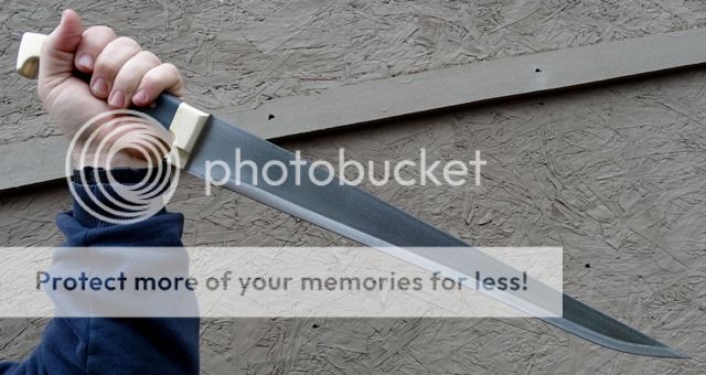

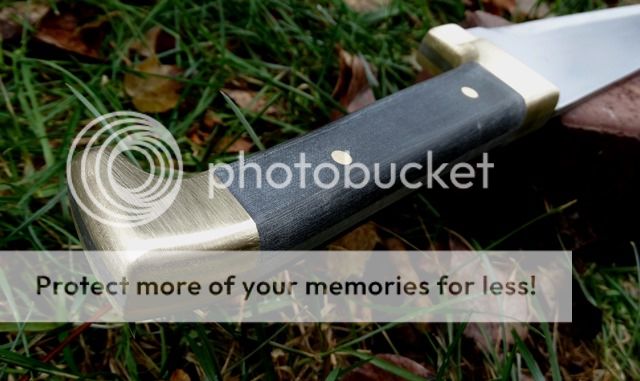

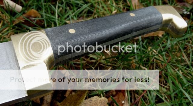

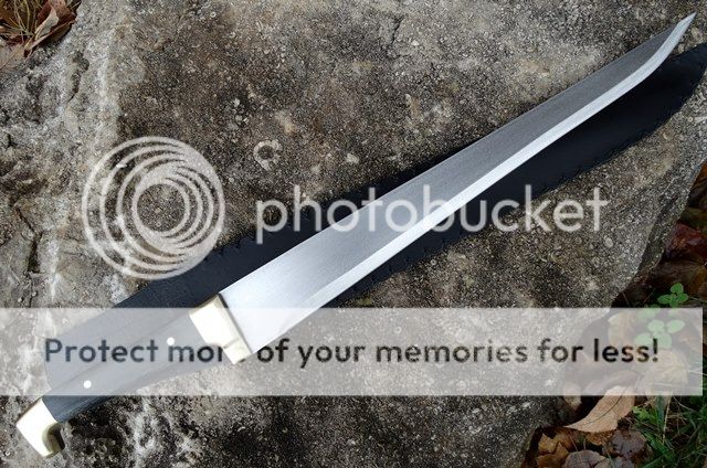

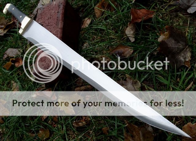

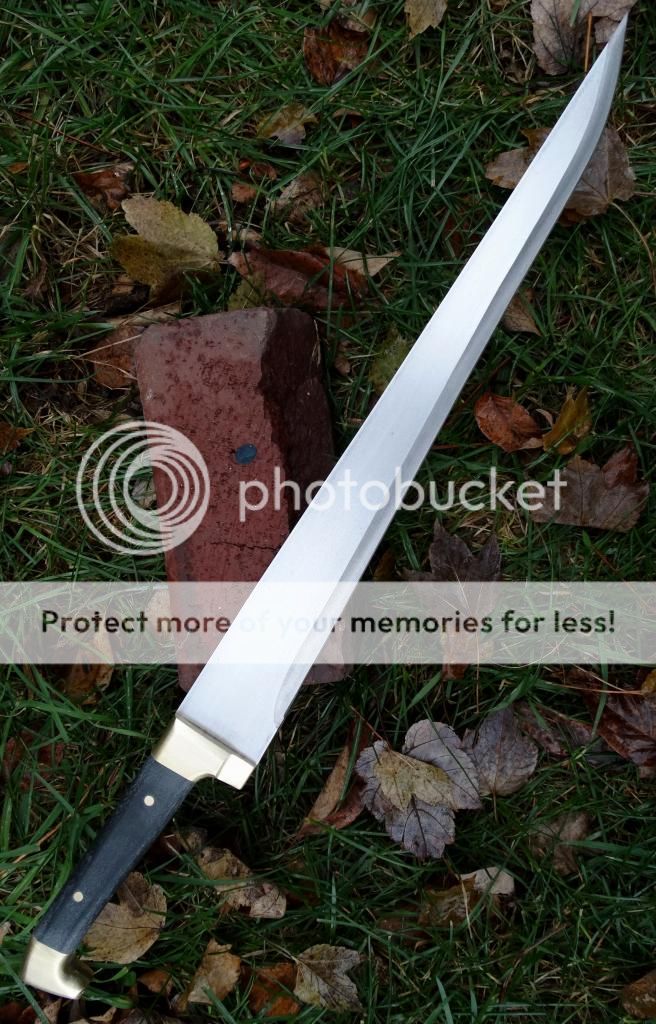

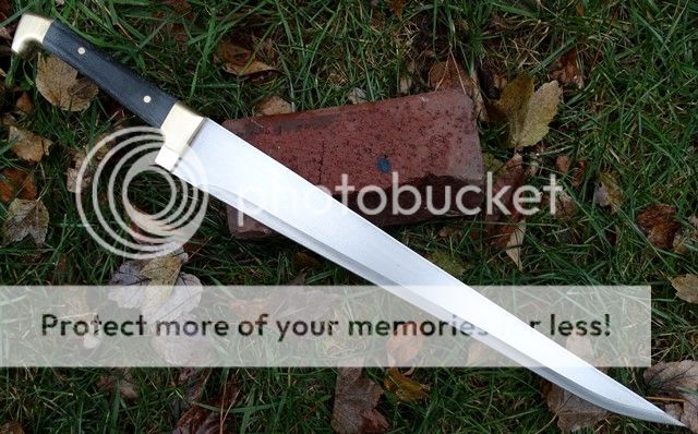

Hi all. Just completed this one and added to the website. Will be doing a video on it soon.
The Assassins Sword - Influenced from Dishonored:
Shop Details:
1095 High Carbon Spring Steel. Steel is Heat Hardened & quenched. Heat Tempered @ 500 degrees for 2 hours, and letting it air cool.
Measurements:
Total Length = 24 ½
Blade Length = 17 ½
Blade Width = 2 1/8 widest
Blade Thickness = 3/16
Handle Length = 7
Handle Width = 1 ¼

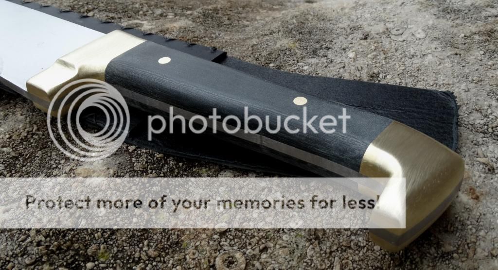

Handle: Brass & Black Linen Micarta
Weight: 2.3 lbs
Pictures below. Thanks.
