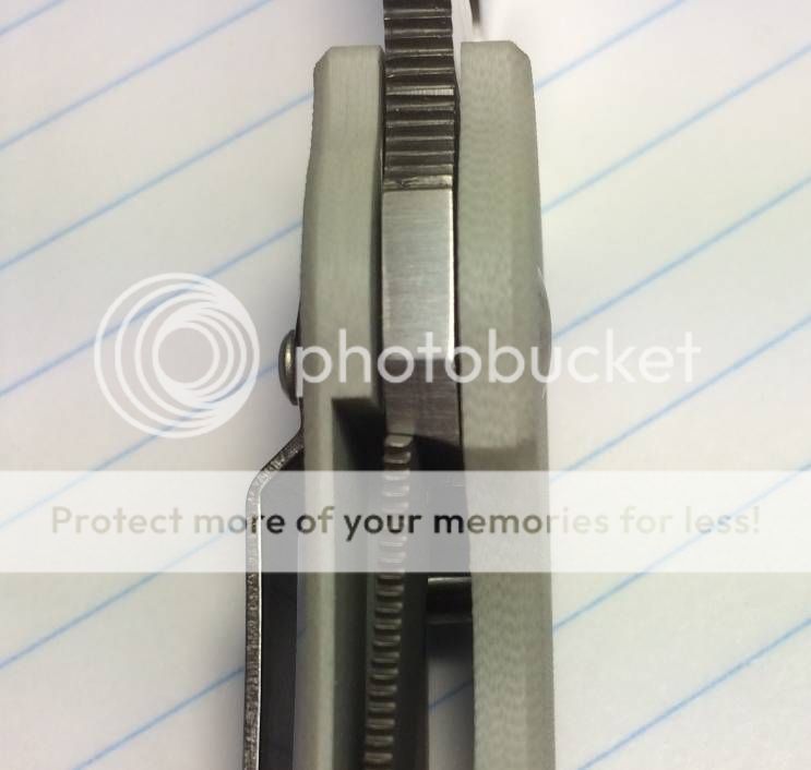

I took a quick cellphone photo of the lockup today. Is this enough lockup for reliable performance?
I would be OK with that - as long as there's 100% engagement of the locking leaf, it should be safe.
Early lock up is always preferable, it means less bending of the liner and as a result more structural rigidity.
That is what is called or known as "early" lock up. If it were on the other end in the same spot respectively that would be called "late". I have a Military that I bought new years ago, my most used Spyderco and it locks up in the same, exact spot as yours. Well, possibly .25mm to the right of yours. Also, i own about 14-15 Militarys, they pretty much all lock up in the same spot. The oldest one I own is the ATS-34 version with a 2 screw (Phillips) clip.
