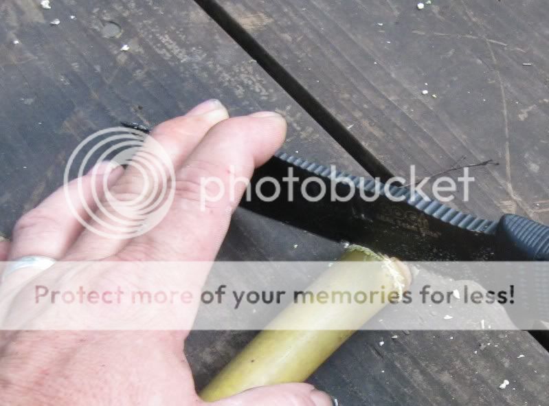

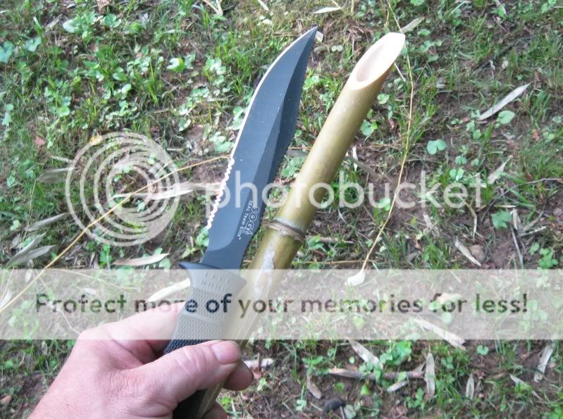

The first cut is when cutting down the bamboo is always easiest done on an angle.
But then it’s easier to split it if you “square” off the end.

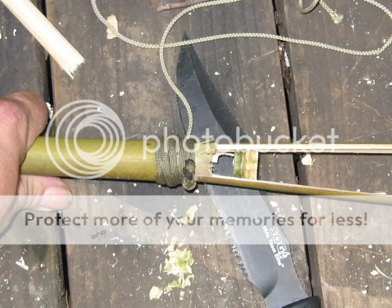

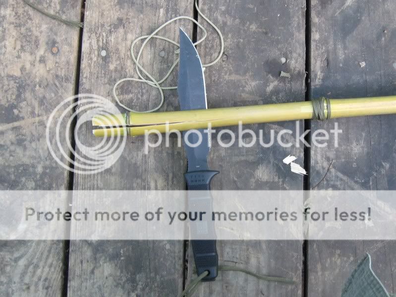

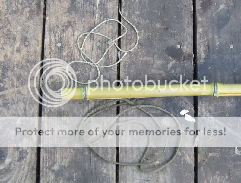

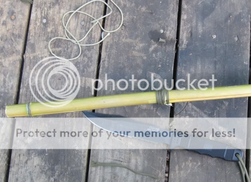

Then it’s best to take a small piece of cordage and tie it off at the joint where you want it to stop, this is better on a joint because it’s easier to keep the string from moving this way.
And then split the bamboo. First in half, and then in half again making a cross and this gives you four tines.
Then break off two oposite tines.

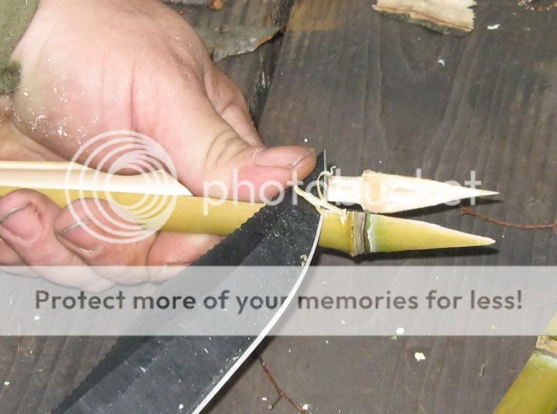

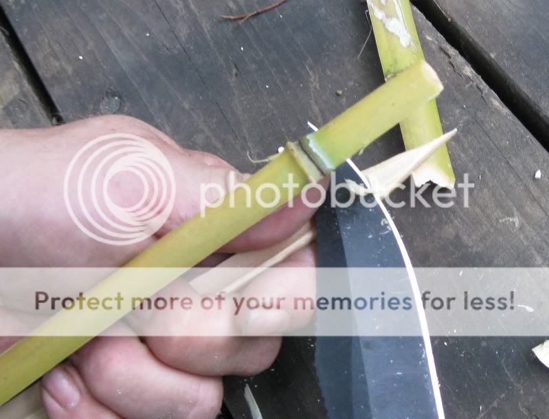

Then next you whittle them into the size and shape you want and sharpen them. And harden over coals.

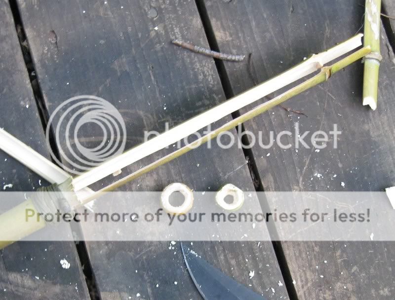

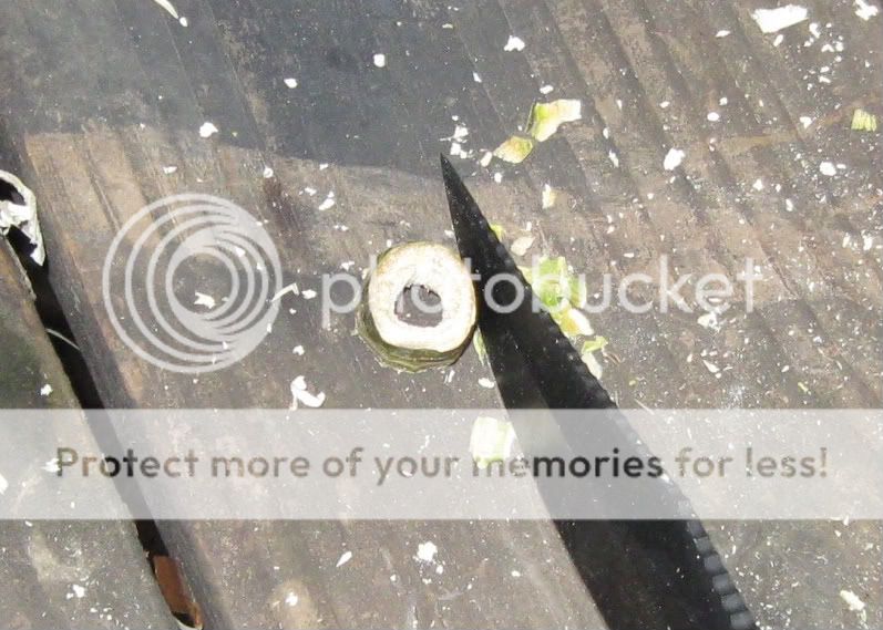

I like to make a spacer or seperator out of a joint from the rmaining bamboo. This holds the tines apart, and adds a bit of strength. Just take a left over section and square off an end and clean it up good.

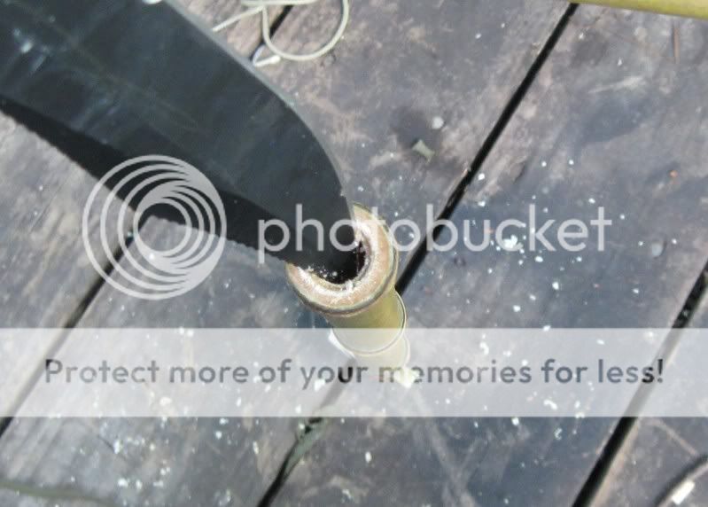

Then bore out the center, this is better done before you cut it off when working with smaller pieces.

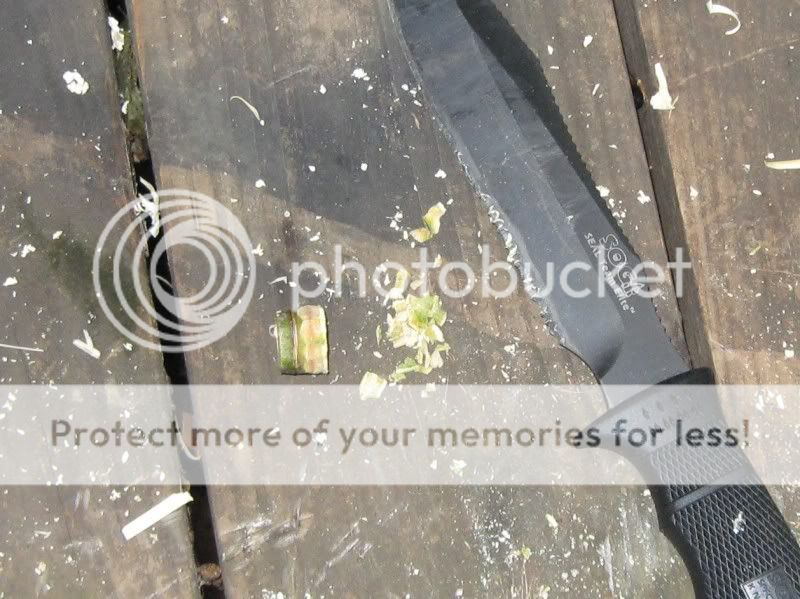

Then cut it off

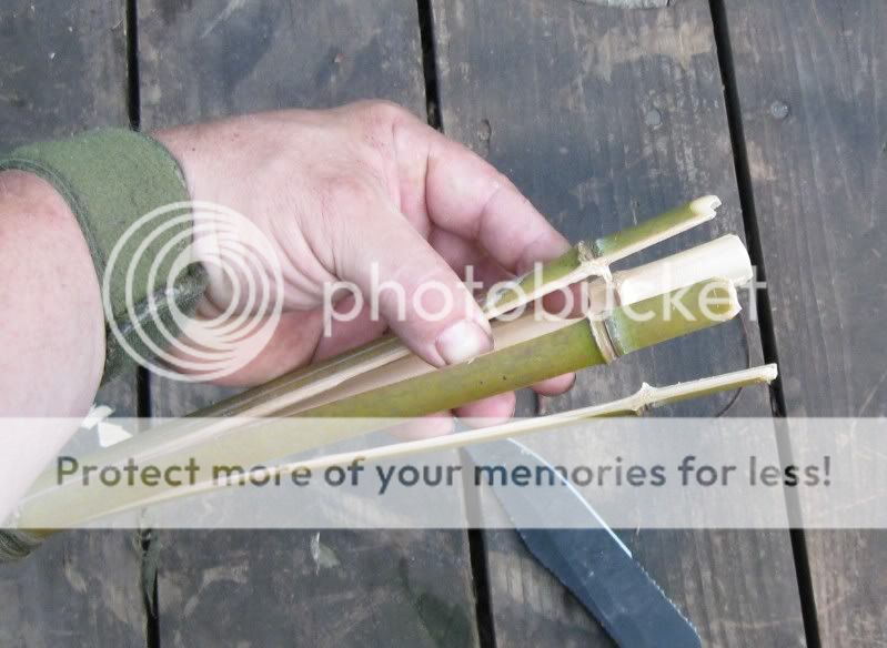

Whittle it into shape
Check it for fit, and then cut notches on each side of the tines for the cordage and tie it in place. Now you are ready to fish or hunt.
