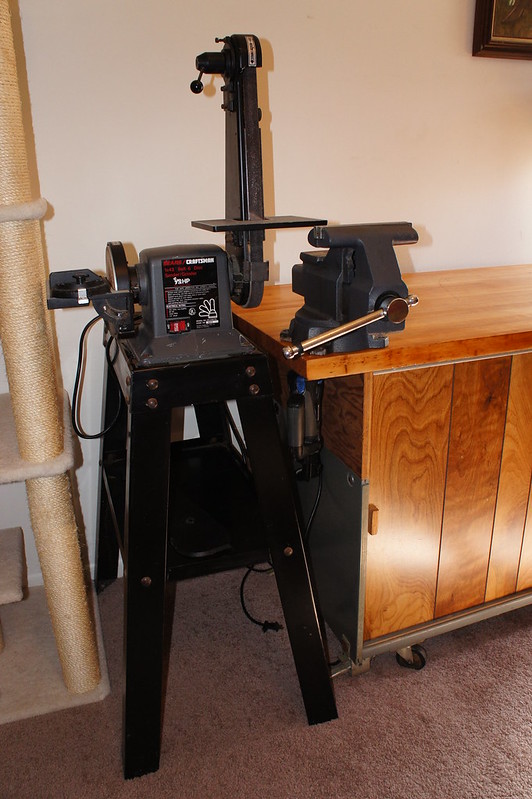

oooo. So I read that this thing spins at 3450 rpm. Is that too fast. I thought most 1x42's spin at half that usually. ???

The harbor freight 1x is ok at best for very light work. No idea about the craftsman 2x 42. I have been using a 4"x36" and it sucks. Bad. About useless actually. Grinders are the most important tool in knife making if you do stock removal. Oh, get a file guide and use chainsaw files to cut the final plunge. You can get em by the dozen and they are also good for doing file work on the spine.

I think I will go with the 1x42 craftsman. I'd feel "way cooler" using a 2" belt like the pros do. I wish I could find a used 2x42 for $20 more but I can't. I'd have to go with something new. The 1x42 seems fine to me. I haven't heard any actual reasons why it would be bad. All I have heard is, a few different people tell me what the internet is convinced is the end all be all starter grinder and nothing else will work.
I can get it for HALF the price of the 2x42 and with a stand. The platen looks very sturdy on the 1x42, and I image I can do more detailed work with the 1" than the 2". I just may have to change the belt a little more often. Oh well, they are cheaper belts. I ground my first knife on a 1.5 year old belt in our machine shop at work and it goes at blistering speeds. It worked great for me.

Honestly I'd say you're good with that 1x42 craftsman. Since you don't wanna spent 150 on a new 2x42 that will surely be better than the 1x30, which deffinitely is not ideal, however, a number of knifemakers have started out with those and have made plenty of knives with them. From the way it sounds and from what I can tell from your view on tools, not to mention learning to cope with workin in an apartment, you'll do just fine with it. You can still find good belts for a 1X42, and you can also get a glass platen from usaknifemaker and put it on to make it easier to get nice n crisp bevels using a jig (like the kind made from angle iron). So yea, don't feel bad about getting it. as for a bench, what I still use, lol, is a wooden sawhorse with a 12x1" length of board (real wood, not partical board etc.) srewed onto it and I have a pretty cheap, but nice swivel/rotating vise from harbor freight that I clamped to one end of it, it can be screwed down as well but it attatches the same way C-clamps do.
Also get a numer of C-clamps and spring clamps for epoxying scales on and other various things. No need to get a pricey scribe/ height gauge, you can use a set of cheap calipers from HF that are actually pretty nice or use the drill bit method mentions above. Get some good files regardless of having that 1X42 and get some needle files from HF. And if all you are goin to do with your forge is heat treat blades you can save on tongs by gettin a long set of vice grips (that HF also sells). Get canola oil for your quenchant (since you aren't going to put out the $ for a commercial quenchant obviously) and and candy thermometer to check the temp of the oil as you pre-heat it on you stove top (in a bread pan etc.) Of couse this is assuming that you aren't goin to send out you blades for HT :cool:

interestingly enough I took a longer look at the grinder that I used at work to do my first test night and I realize that it was actually a 2x42 Kalamazoo and not a 3x? like I had originally thought.
it has a half horsepower motor 3450 rpm motor speed and it worked ok but the width of the belt was actually a problem for doing the inside of the handle.
I may end up keeping this one by 42 even if I get something better in the future

How is spending a $150 on a craftsman 2 x 42 smart, but buying the craftsman 1x42 with the same motor for less than half the price is worse than files when you dont have the money for the 2x42. I was looking for a cheaper (than the 2x42) grinder and wanted to know if anything was wrong with what I was looking at.
Convincing yourself that the only thing that will make a knife is a file or a 2x42 is duuumb. I need an option that is less expensive than the 2x42 and you can't come up with one suggestion for anything besides "the ideal starter grinder" or a set of files. If you read any of this thread, you would know that I got the grinder for a very cheap price WITH a very nice stand. The same grinder without the stand sold on ebay for $135 today. That's double what I paid. So, when its time to upgrade, I will be able to sell this one easily.
If you want to believe that this grinder is worse than a set of files keep lying to yourself about what is adaquate, but please keep it to yourself while the rest of us add value to the conversation.

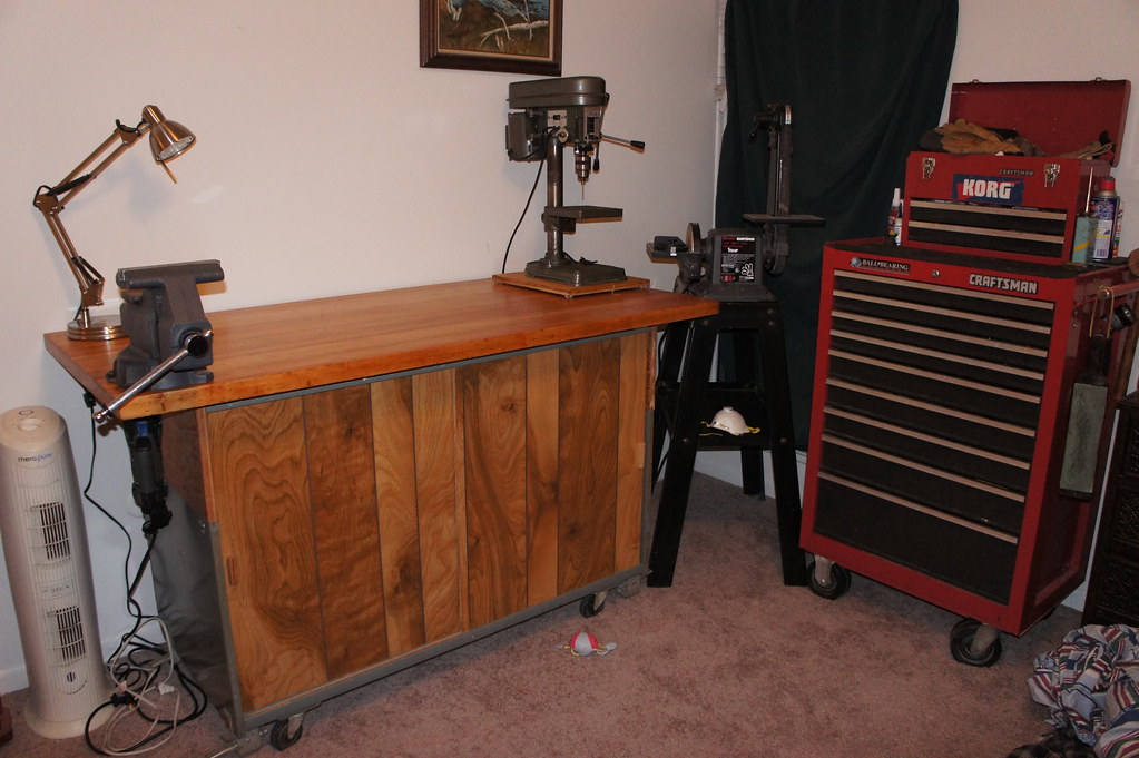

Anyway, FYI - Here is a pic of the grinder. It was used very very little. I bought it off of an older guy why made one attempt at making model trains out of balsa wood with it and then never used it again. It still has the original belts on it and they still have good grit on them. ....meaning, this thing has barely been used. For $70 including the $30 in gas to get it, I think its a great deal....and you should too.
As far as tools go, I already have most of the hand tools. So besides the tool box in the pic everything cost me a total of $175 (work bench, vise, drill press, and grinder).
Now I just need a floor mat and a shower curtain (don't ask it's for weird apartment workshop setup).

I did my first test knife on a 3450rpm (same as this craftsman) Kalamazoo 2x42 and it took almost three hours to grind it down from a 1/4 stock (yes, doing thick knives). Yes I was going slow because of learning and doing my first knife but filing is definitely not going to take less time than a kzoo 2x42. So if YOU want to file for three hours, go ahead, but I would much rather grind for 5 hours than file for two. If you wouldn't, then you need to learn that you are not in the norm.
My grinder is on a pedestal. I can put it outside. I can put it in the bath tub. I can put a mat down on the carpet and put a shower curtain up in my bedroom...grind by the window with a fan pointing out and have a big ol magnet next to the grinder.
