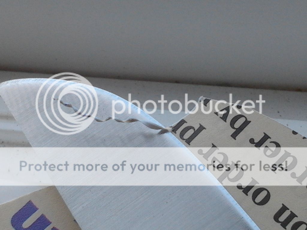

I am old school, so i love carbon steel; when i think of carbon steel i get this warm feeling...however...my beef is the flak that case tru-sharp gets....and im not sure if people are just quoting what they heard from someone else about it not taking a good edge because this knife can get hair popping sharp; as sharp or sharper than the cv ones (with normal sharpening techniques). Anyway here's a pic. If anyone disagrees i am willing to prove my case.
This is an older picture, i have since mirror polished the edge.
