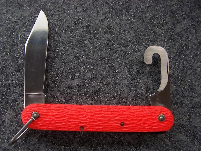

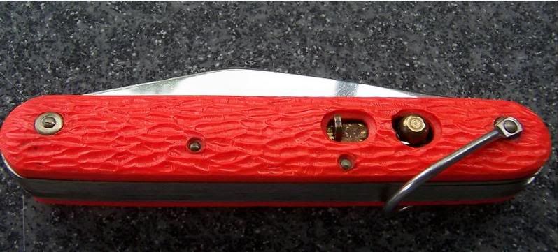

The famous Camillus MC-1 that the US Military commissioned for our Air Force in the late 1950's is a very hard use knife and is also bolster-less. This knife saw its first serious work in Viet Nam starting in the mid 1960's. And by all accounts worked well as a parachute jumpers cord/line cutter and even had the auto option in case a jumper only had one hand available due to injury. So well made and hard working this design was, that two others were made by Schrade Walden and Imperial.
My old Camillus MC-1.

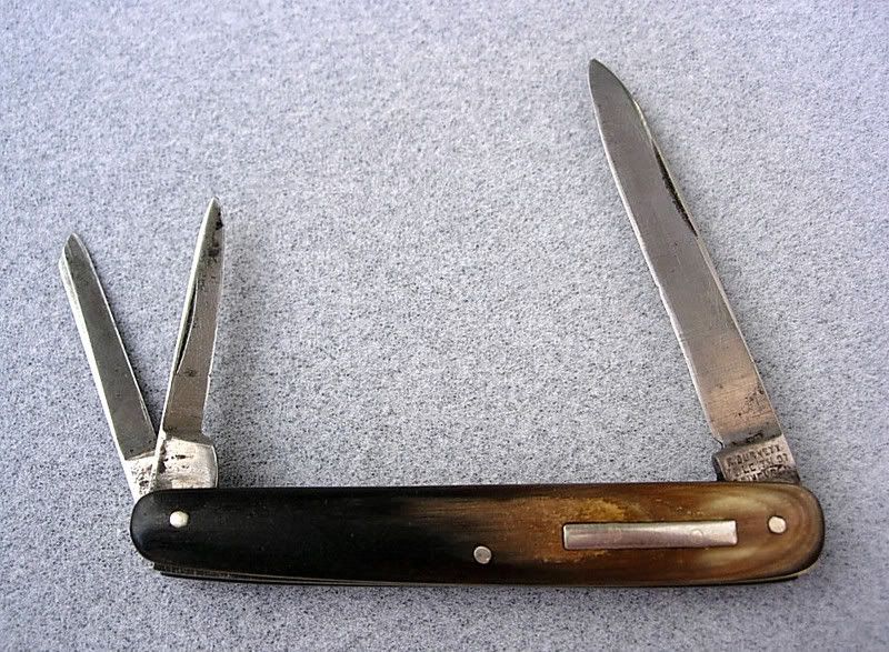

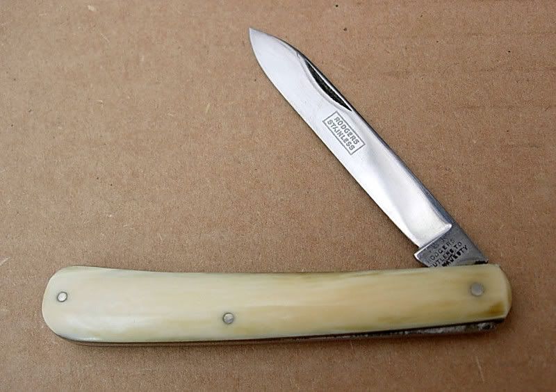

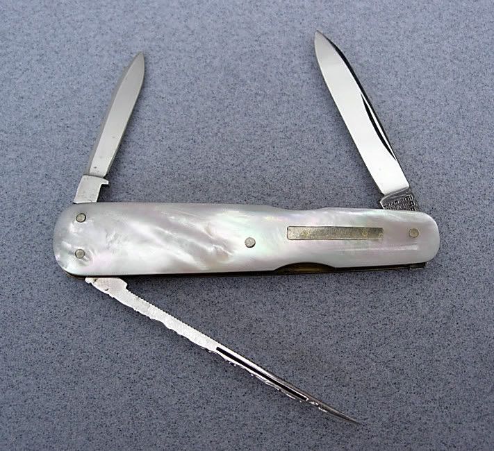

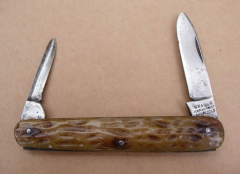

SK- I am just so disappointed that you are not showing us a few gorgeous examples of bolster-lees knives that have made it through the time warp. Please!
mnb, You and I are absolutely positively polar opposites on this one here, and that is for sure!.:cool:
I can't help it sunnyd, I'm from Florida! :p Reckon we'll just have to agree to disagree on this one. I need my bolsters!
Yeah, s-k, show us some knives!:D
You can even mix it up a little if you want, some pearl, some stag. We won't complain. Honest!
Hey mnblade, whats Florida got to do with it?:confused:
Wow, that Wraggs looks very well used. The bottom one is well worn on the main blade too. is that a small chip out of the tip on the Needham's sheepsfoot?
