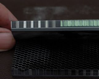

After receiving the material I had a few concerns:

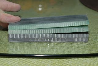

I heard back from the maker of C-Tek and he told me that there must have been a problem with the Resin Cure and he will be sending me another batch and to use this material freely. I found this as a great opportunity to play with the materail a little bit. I snapped a few photos of some sets I glued up...
Here you can see the warpage when I push on one side of the cut scales. I look forward to getting the new stuff.

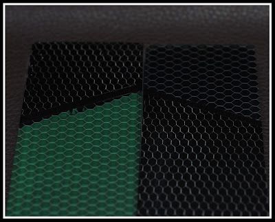

Here you can see the Cell walls on the side of the material

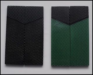

Two different scale sets the one on the left has "Black" Ctek on the Base portion and "Green" on the Bolster Portion. The right Scales have "Green" on the Base and "Black" on the Bolster. The only difference is a white liner on the right set. Makes a huge difference as you can see.

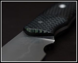

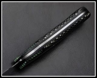

Another thing I learned is that I need to cut my angles along the cell lines as to not break the cell wall because light is then reflected differently along the line. You can see this in the green on the left below. I ran the bolster cells across the base cell structure as you can see in the photo below also. I personally think it looks strange.

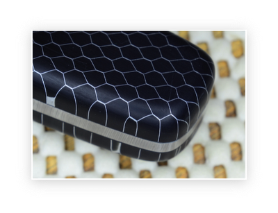

I Glued up the scales on a test knife, and I am very pleased with it. The only remaining concern is how well resin stays in the open cells along the edges. My concern lays in the light colored pieces in the photo below. I am afraid that if it gets bumped the resin will release from the honeycomb. I was able to knock some of the resin out on corners of a test piece. As long as the sides are rounded it holds up great.

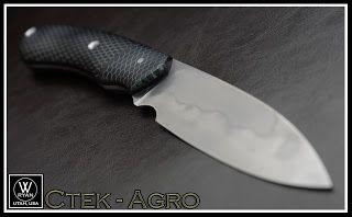

I received the new materials within a week of my original order, and it was all dead flat and beautiful.

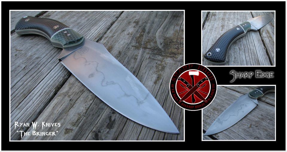

The Bringer:
Steel: 3/16" Aldo W2 (W/Hamon)
OAL: 10"
Blade: 5"
Handle: Black & OD C-Tek with White G10 Spacer
Liner: White G10
Pins: 1/4" Mosaic & Alum. Tube, 1/8" Nickel
Misc: Tapered Tang, Balance point at front pin
Sheath: Black Leather (Right Hand)
In summary:
C-Tek is a great material that requires a little more planning than most commonly used handle materials. You have to work with the honeycomb layout and angles that you use. I will definitely be using it more in the future. Composite Craft has great customer service and communication with it's clients.
The customer took these photos.
