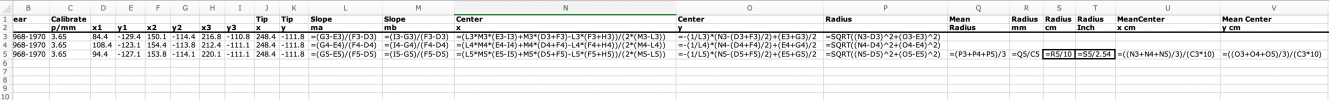

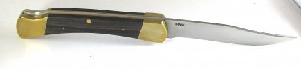

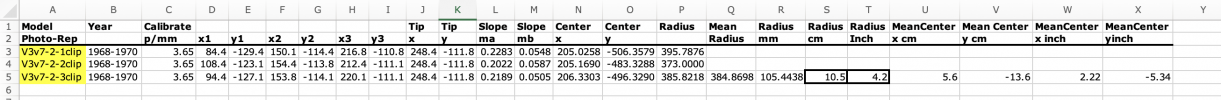

This probably won’t interest anyone. After ten years or so, it barely interests me. Years ago, I thought it might be interesting to look at the shape of the 110 clip on the early knives. I discussed this with Bruce Dollinger, and his comment was that it probably was a waste of time—the blades of the early knives were hand-shaped and there is too much variation. Bruce was right.
I used a Version 3 Variation 2 for my first, and last, measurements. After my calculations, I agreed with Bruce—there is too much variation. If you remember your geometry class, three points on the arc of a circle can determine the radius and center of a circle. For my test, I chose 3 points on the spine of the clip arc. Then I repeated my measurements twice but chose different points each time. My conclusion is that while the shape of the clip is close to the arc of a circle, it is not. If it were a true circle arc, the radius arc and the circle center would be the same. Variation from one knife to another probably is a result of who was doing the shaping and what day it was.
If you look at the numbers in the attachment, the right to left variation of the circle center (Column, N (Center X)) isn’t bad, but the length of the radius (Columns O and P) has significant variation.
The second attachment shows my calculations.
My conclusion is the same as Bruce Dollinger’s—these blades were shaped by hand and there is a lot of variation. Once Buck started fine-blanking blades, most of that variation was eliminated.
